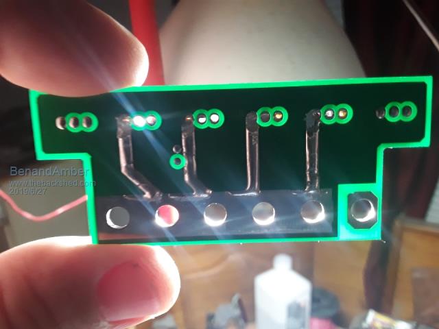

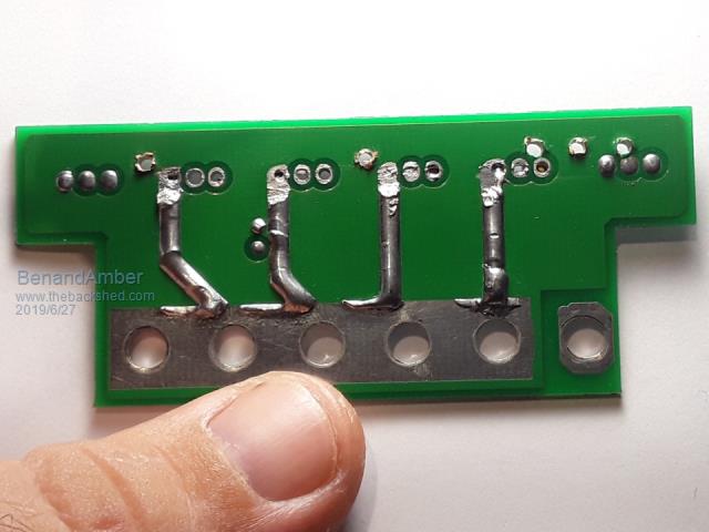

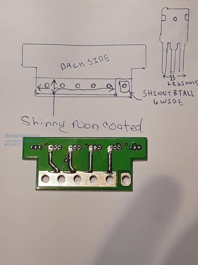

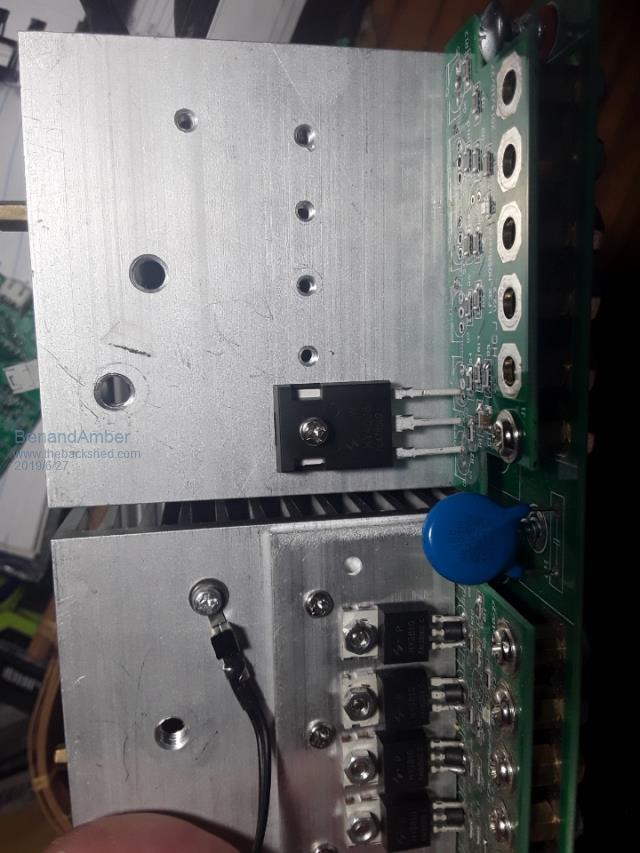

The last pic here shows how the new mosfet will mount to the heatsink

If there's any information I left out that's needed or if I'm just barking up the wrong tree someone please let me know

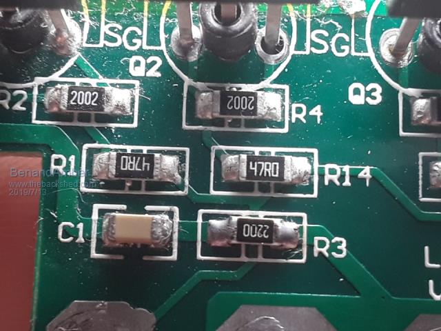

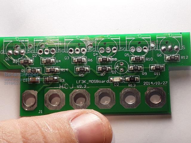

I have read somewhere about Oz and others running h y 4008 in there old Power Jack boards
I am looking for what resistors I should use going from Hy 3810 to Hy 4008
I know this information is somewhere
I've read it
or it might even be simple for one of you guys to figure out without having to have the information
I'm pretty sure that I read that if you use the original resistors it runs really hot really quick or something
Thanks for any help

Ben, how many Mosfets are going on the new board? I'm guessing half as many? Are you using through hole resistors? I imagine they'd fit.
I can't quite read the values on you photo, what are the values?
It looks like individual pulldowns, they could be consolidated into one resistor if you like.

I'm waiting to get permission from Kent the PCB creator to put a picture of it up here
I don't think he would mind but I'm going to wait for him to answer me back
I think he has done a brilliant job on it
It is all through hole and you are correct 3 mosfets
After I make sure to get the right resistor value for the little boards
I will be ordering them and the boards 4 another experimental inverter
