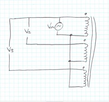

I could suggest another way to check your windings, in a similar way I check the polarity of the transformer.
Connect up the windings as I've shown, I prefer to use a isolated AC source at safe voltage, obviously it must be under the rated volts / turn .
V2 and V3 should measure zero volts if they are balanced.
A warning, that if polarity is wrong you'll get 2 x Vin.

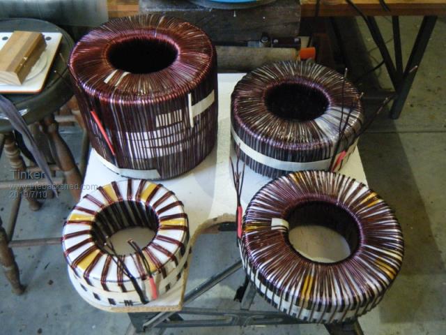

Having finished winding the secondaries on all 4 transformers now, it was quite a task - pulling that wire 1035 times through a toroid hole . Now I can look forward to repeat that exercise 437 times with the primary winding's.

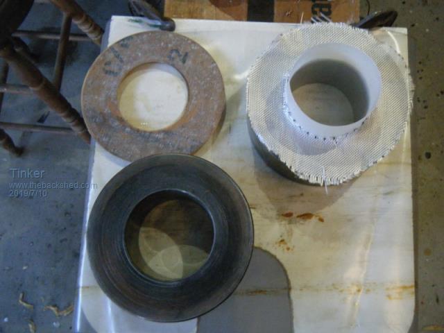

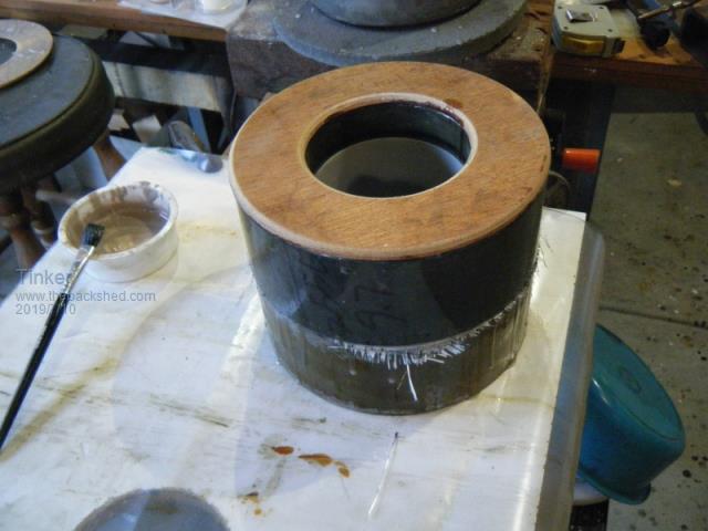

Anyway, the big toroid was made up from 2 x 3KW Aerosharp cores. I epoxied those together.
The glass mat evens out the core surfaces for a very solid connection. You do not want that to break while wrestling with that 22kg lump of steel to wind the wire on.
Here are the two cores mated up.

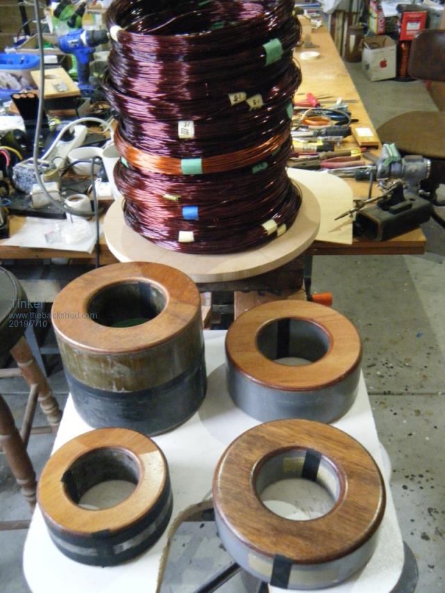

Note that I use 6mm plywood disks with rounded edges on the core faces.

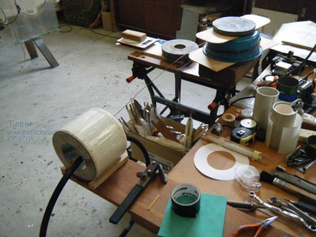

The 4 cores are ready for the winding part. In the background is my stack of re cycled wire for the job.

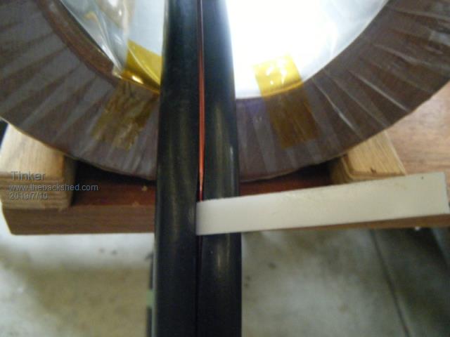

Here I show how I wind them, the wire is first fed into my muscle powered winding machine.
The white on the core outside is a layer of 1mm plastic which I fitted to all cores to minimise that troublesome capacity problem Macoffgrid encountered.
The eagle eyed may spot my wire pulling gadget next to the core. The enamelled wire *must* be very taut in the toroid hole or one looses valuable hole space.
A close up how the wire gets inside the 'winding machine' by means of a small plastic strip.

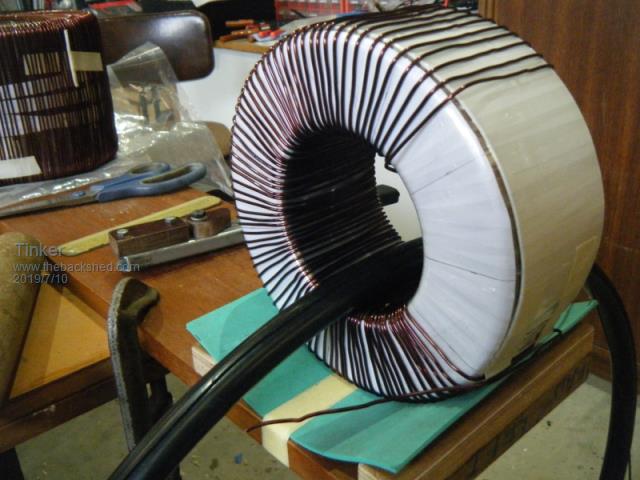

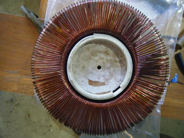

My secondaries are wound 3 in parallel on each core, here is a pic of the first completed.
Note the split PVC tubing jammed inside the hole with a wooden disk. This pushes the wire right against the core while the epoxy sets. I repeat this for every parallel winding.
Another pic with the second of the parallels.
I count the turns only on the first run, the next pic shows how. The second run was alternated between the first, thus not requiring counting. As there are 160 turns per parallel winding this helps a lot.
Below is the partly completed first winding on the transformer #2. It shows the kraft paper (200g/sqm) disks I use with marks for every 10 turns. By sticking to the marks I can get the turns evenly spaced around the core.
Now all 4 transformer have their secondaries on.

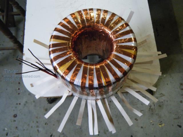

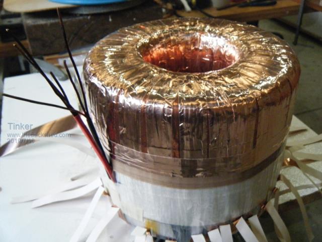

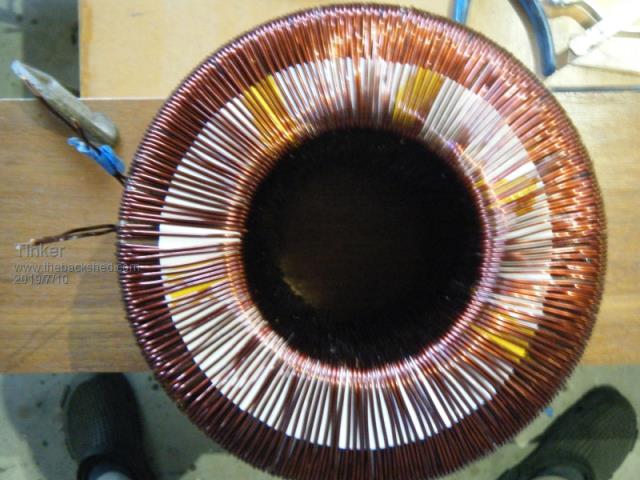

I had elected to fit a full static screen between the secondary and primary winding of each transformer. The biggest core looked like the most difficult to fit that so I started with that.

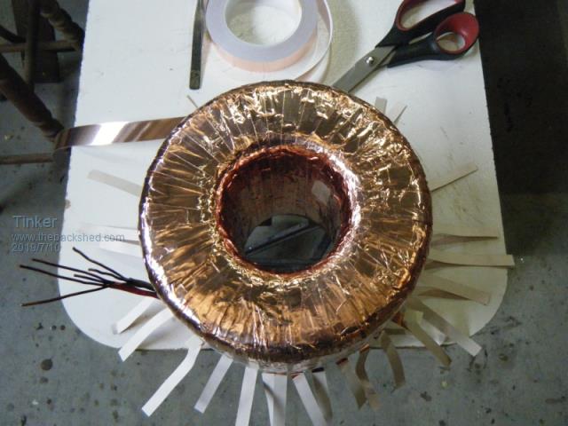

Using my 'grass skirt ' method, 10mm wide strips were first placed inside the hole so the copper foil made 100% cover in there.
This was followed up with 20mm wide foil strips to cover the still bare sections on one face of the toroid.
Here is a side view to show the heat resistant tape the foil ends terminate over. A 20mm foil strip ran around the circumference above that.
And finally the other (skirt ) side was completed similarly.

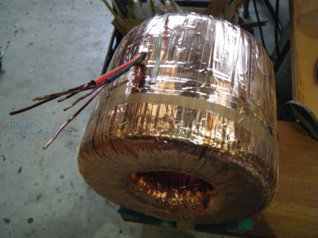

A earth braid was then soldered on and the core tested first for shorted foil by powering it up and observing the idle current. It was the same so no short .
Then I did a 500V Megger test between the screen and the outer layer secondary winding - it passed.

A really beautiful job there Klaus, each of your pictures is worth a thousand words.
There are a lot of very good ideas and excellent workmanship demonstrated here.
The hoop idea is pretty much how the automatic coil winding machines work, and it must certainly go a very long way to avoiding kinks and stresses in the wire.

Andrew, the solder reel method is doing it Flinders island style , I prefer to copy the method commercial toroid core winding machines use.
I also found it much easier to wind the cores lying sideways, the complete turn can then be inspected without having to lift the core.
Yes, its 19mm black poly pipe. My 600mm dia hoop can hold 1kg wire easily. It did the whole winding on transformer 2-4. The recycled wire was too short for the double stack No. 1 transformer so I had to fit one splice at each of these secondaries. The hoop could do the whole winding if my wire was long enough...
Posted: 09:46am 11 Jul 2019
Thanks for the kind words Tony. There were kinks created by my wire puller but these are on the outside of the core and easily flattened with my plastic faced hammer.
Unfortunately 1.7mm wire is too stiff to pull tight around my rounded core corners by hand.
I do like the hoop winding method, it does take a bit of figuring out initially with regard of which way to load and use the wire from it . What is pictured suits a left handed person .
Best of all, its a sitting down job .

I keep looking at your photos - building a picture in my mind what you're doing.
Great reference photos. I very much doubt I would have re-purposed AeroSharp Chokes without your posts.
Could I get a close-up of the wire pulling tool - I can't figure it out.
It'll be very interesting to see how your capacitance goes.
