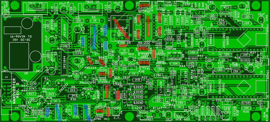

The TLP523 comes in 1 and 2 inputs/outputs.
The TLP523-1 only has 4 pins and this can be placed in the 8 pin socket
intended for the TLP523-2, using the top 1,2 and 7,8 pins.
But you don't want mains sync anyway...
here is the top board with a few things marked that I think you don't need.
It scrubs out the RS-232 (red) and the mains sync (blue).
It retains the SCR current limit shutdown function. For this to work you will need a current transformer of some specification (about 15V - 20V at the AC current trip limit)

If I'm understanding what you're saying correctly
everything in red and blue I do not need

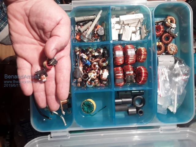

I have crap loads of small Transformers
I already have a small Step Down Transformer 120 to 12 volts
would you happen to have a picture of the current Transformer that you could share
Or a picture of the completed board
Thanks again and I'm sorry for being a pain in your ass
I know you're very busy
Posted: 03:13am 11 Jun 2019
Step Down Transformer does not = Current Transformer.
Can I offer a suggestion, Google "Current Transformer" it is better to learn how to fish than to just ask for fish.

I know what a current Transformer is
I have several of them here but there is different kinds
I'm sure Poida is thinking the same thing you wrote
He said it needs to be between 15 and 20 volts
I've been Googling but I just keep getting more confused
Could you point me to one that I can buy so I can read about it and understand it a little better
I don't want to fish I just want to know what kind of fish were fishing for
I'm just confused I do believe if I had a little bit more information I could figure it out though
Thanks for answering my post Madness I appreciate it
I just need a little bit more information so I can figure this outEdited by BenandAmber 2019-06-12

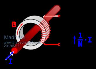

Posted: 06:10am 11 Jun 2019
If you read this you will have a good understanding Wikipedia
These are the type we have been using previously.
Current transformer Edited by Madness 2019-06-12

Posted: 06:58am 11 Jun 2019
The Active wire of the Inverter output passes through the Current Transformer as shown here.

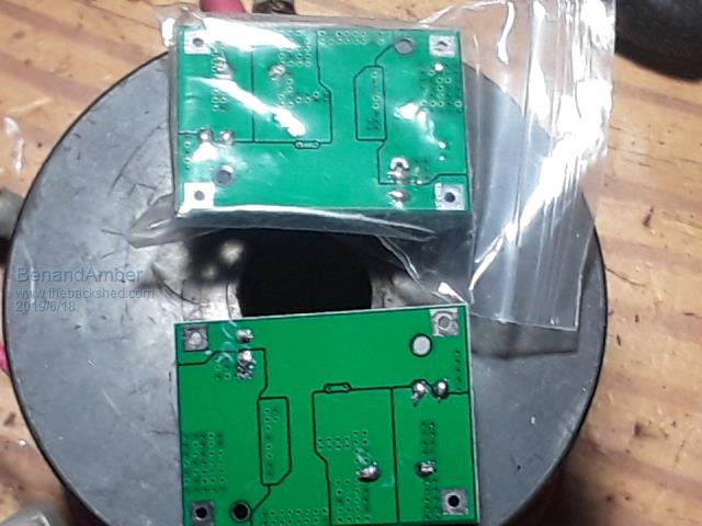

Posted: 01:05am 22 Jun 2019
They didn't charge me anything to change it to 15 volt put it in the notes on the order
Checked it once it came in 15.46 volts

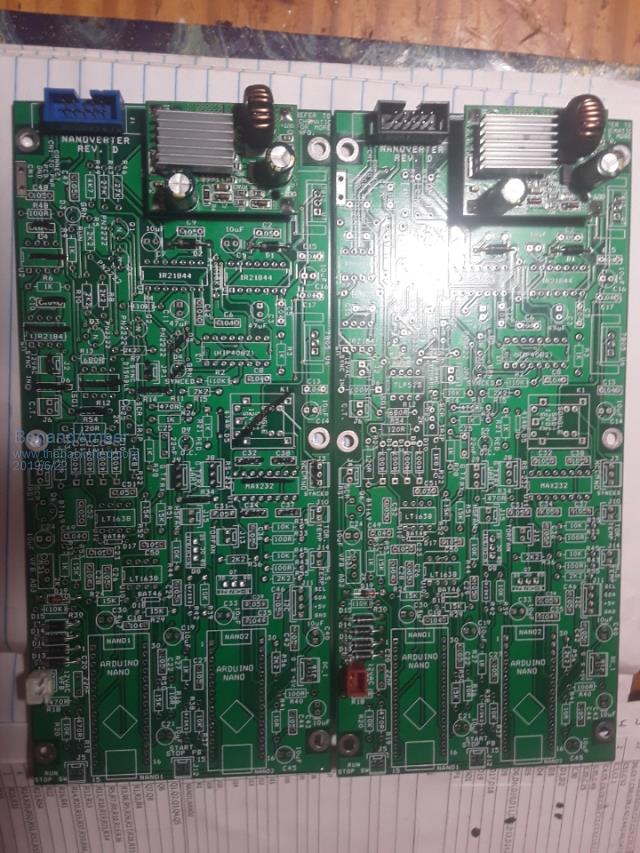

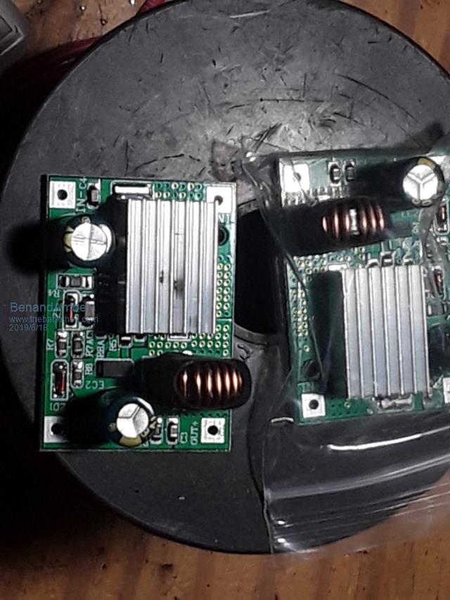

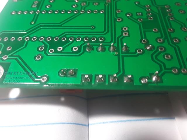

A few parts came in the mail just enough to be a tease
I used gold-plated pens from old computer parts to raise the dc-to-dc converter
the heatsinks i have for lm7812
would hit DC DC converter without using pens and tilting it a little toward 10 pin plug
If you look on the board in the pic you may noticed I didn't put the 4007 diodes in over by the mains sink part of the board
I was wondering if anybody knows if these are necessary since I won't be using the main sync function
By following poida the Greats Tips on how to solder this board
And my absolutely awesome homemade clear no headache great smelling high temperature cheap as peanuts liquid solder flux
I think I'm going to be okay
Notice I said Think!!!
I've wanted to build a control board every since about two years ago when I read about the oz control board
Thank you poida the great
Special thanks to Mark and Tinyt alsoEdited by BenandAmber 2019-06-23

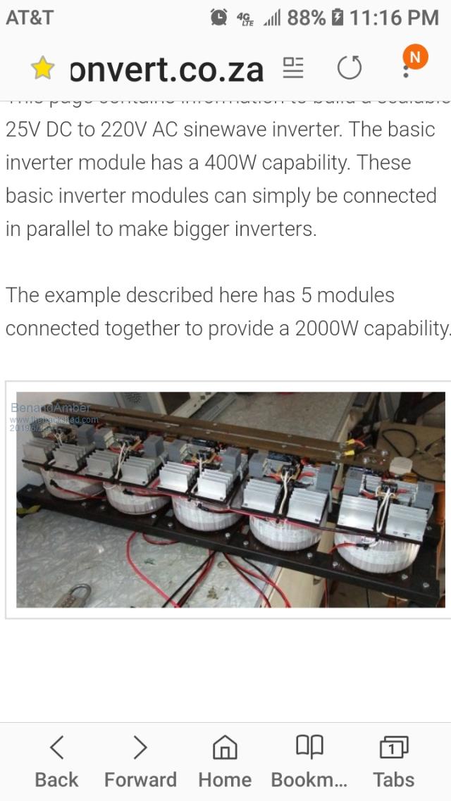

multi Transformer inverter http://evconvert.co.za/solar-panel-charging-station/inverter/
I ran across this very interesting inverter
thought I would share and see what you guys thought about itEdited by BenandAmber 2019-06-25

Posted: 05:19pm 23 Jun 2019
Hey solar Mike I done it
look above at the previous post it has a link
thank you for showing me how to do it
