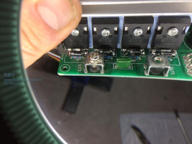

This is how I manage to install the 15V TVS clamping diode between gate and source of the power MOSFET:
I think they're all right, but if could some expert check and confirm please.
I've done it the closer to the MOSFET with the shortest connection as advised.

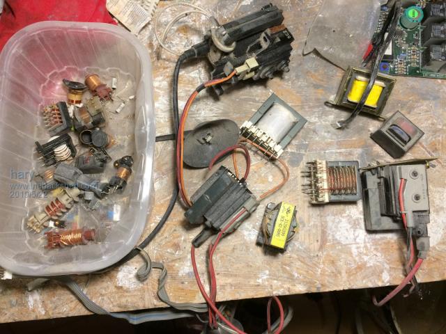

I'm still desperately missing the choke ! I'm still doing some reading to have a better view about the way to go. I'll have a look at my shelves in case I could get something that would work.
Any chance I could get something out of these dusty things ?
Edited by hary 2019-05-23

I'm not sure if you're a diode placement would work or not
I'm not educated enough to know but if I didn't have any extra mosfets laying around
I would make sure to ask somebody that does know
I've heard the one and only warpspeed
Say numerous times that the layout is very very important in these type of inverters

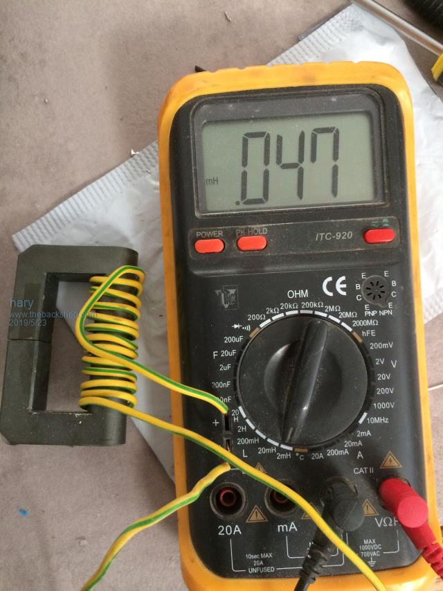

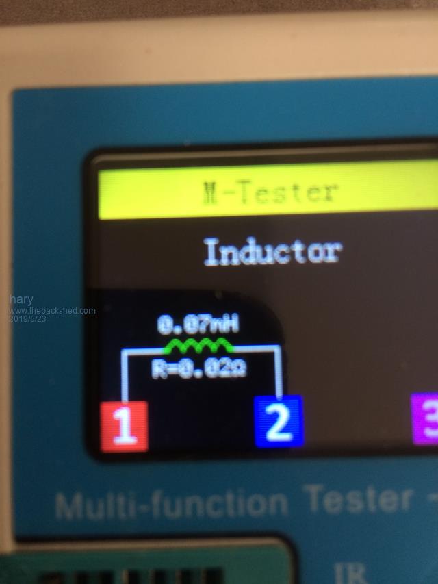

I've been doing some test with some reclaim core from old CRT TV set and I made some measurement.
But the value aren't the same from one tester to the other !
Plus, it doesn't seem proportional to the number of turn !
I've tried with 1.5mm2 thinking switching later with bigger wire if good result would be obtained. Hope, it's not dependent of the wire section ! Can somebody confirm that please.
I don't know which tester is better to trust ? (if any)
Plus I'll still need to get the saturated condition aren't reached. Still need to check how to do that !
By the way, nobody confirm (or infirm) my TVS diode were well installed or not to protect the IR2110s.
Please, tell me your thought.

  hary said   This is how I manage to install the 15V TVS clamping diode between gate and source of the power MOSFET:
You have installed them correctly.
They should behave as a simple over voltage clamp for positive gate voltages
in excess of something like 15V.
And, they should prevent negative voltages, maybe no less than a diode drop
such as -0.5V to appear on the gate.
All voltages measured with the individual MOSFET's Source pin as zero.
So they look to me as "good to go".

About my choke. Can you say something ?
Of course, the hardest value to know about the choke is its Saturation current limit.
How do your guys do to deal with that important value ?
It needs a specific equipment to check it !
Do you all of you measure it, or some just cross their finger and try ?
Of course, I've been given some advises about the choke, and you could think I should just follow these advises, but most of you, if not all, are on 48V.
I'll be on 24V, and so, double the current in the choke, which can lead to unattended fast saturation of the core's choke in my case !
Maybe, the person who gave me the advises haven taken this into consideration, but I'd like to be sure !
Is there any precaution I should take when firing it up first time ? I think I'll put a 10A or 16A circuit breaker or fuse in the inlet circuit for first go.
Many thanks for your time and valuable advises.
