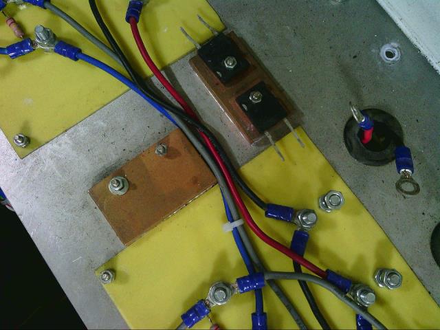

Getting back to thermal design.
One idea I have used successfully, is to first bolt mosfets onto a copper block, then bolt the copper block onto the heatsink.
That is probably of very limited value if the back of the heatsink is really thick, say 10mm thick or more.
But if the heatsink is something like a very large flat sheet of 3mm aluminium, the thermal gradient right around the mosfet can be rather high. Something like a 50mm x 25mm x 3mm block of copper under the mosfet tab can make a significant difference to the heat flow path.

Posted: 12:55am 17 May 2019
Instead of bolting directly to aluminum, using copper intermediary is to help dissipate heat better?
(Copper has a higher thermal conductivity)
How much of a change does this have on the life/performance of the MOSFET?
Posted: 02:10am 17 May 2019
Without the copper, all the heat concentrates into a very small area of some fairly thin aluminium. With a copper plate, the heat is spread over a far wider area into the aluminium.
[quote]How much of a change does this have on the life/performance of the MOSFET? [/quote]
Probably not much, unless you are really pushing the absolute limits of junction temperature. I suppose it depends on your appetite for risk.

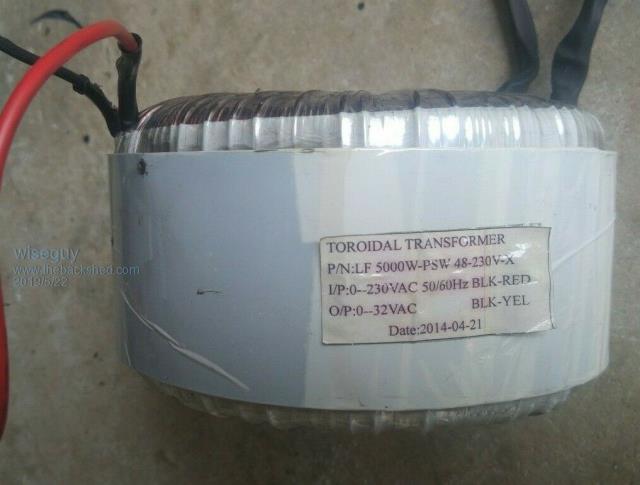

Posted: 06:15am 22 May 2019
Ok now for some transformer discussion on my ebay purchase. The ad reads "5000W 240AC to 38V 80A toroidal transformer" 2 available. Here is a picture from the AD.
Other text from the ebay posting read:
Transformer removed from working device (LF 10000W off-grid inverter).
230VAC to 32VAC/80A
240VAC to 38VAC/80A
or
32VAC to 230VAC/16A
38VAC to 240VAC/16A
Size: D170 x H100 mm
Weight: 10 kG
I emailed him suggesting there is an issue with the text in the ads.
There are 2 wires for primary and 2 for secondary - no taps.
It cant be 230-32 & also 240 - 38, they are different ratios. I also pointed out that ot cant be 5kW and also 32V x 80A as that is only 2.56kW. Also 230 x 16A = 3.6kW.
The transformer finished dimensions are actually closer to OD 160mm, ID 55mm, H 90mm.
Weight is ~ 9.7kG
Compared to an Aerosharp I have is OD 195mm x ID 55mm x H 70mm. weight 11.2 kG.
I suggest that the sticker is either 5kW for both transformers or a peak value for 1 transformer it just doesnt feel like a 5kW toroidal. The cost was $180 for the 2 delivered.
I ask for comments, the transformers arrived yesterday I brought 2 hoping for the 10kW in the AD but I have a gut feel these are only good for 2 - 3 kW each. I will post the test data soon which is excellent. But do I complain about them or just let it slide and accept them for what they are ? I am disappointed but also know the value I paid is probably about right even if they are only good for say ~ 6kW in parallel ? Test data posted shortly.

Posted: 07:13am 22 May 2019
Mike, I think you did fine, as long as you don't have to modify them.
2 x 9.6kg wound transformers for $180 -
Yes, I'd agree that you've got 2500ish VA. Do your testing with them and if you need to do larger, sell them off to someone who really can't handle the transformer winding.
