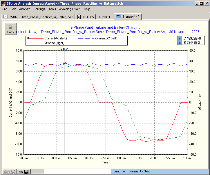

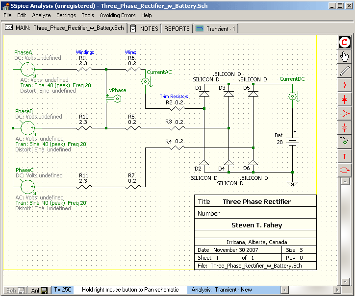

Could I suggest you try modelling this in WinSpice?
I used Spice to model the basic windmill system a while ago, and it really improved my understanding, rudimentary as it is.
Have you tried calculating the reactance of the capacitors at different frequencies (=rpm's)? Wouldn't that help illustrate how effective they are at different speeds?

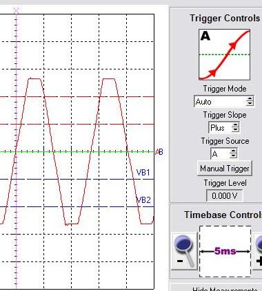

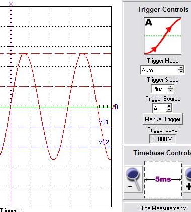

I have some oscilloscope graphs of the outputs.
This is at cutin 26V
This is at an output at 2A.
Note the flat top of the sine wave output and the straightening of the sides.
The mill increased 5 RPM at the 2A power level. The normal unloaded output of the system increased 1V per 5.9RPM. There was an effective 0.85V extra to produce 2A. The capacitor combination gives an effective delta wiring resistance of 0.42ohms. I have not measured the DC resistance of the delta combination of 100S windings, but another reader may have done this for comparison.

I suggested WinSpice because as I experimented with it, I found that it has plenty of modelling and graphing capabilities, plus it looks really nice...
Bear in mind, it only models the electrical parameters - it's up to you to figure out how the windmill system actually behaves under these conditions.
