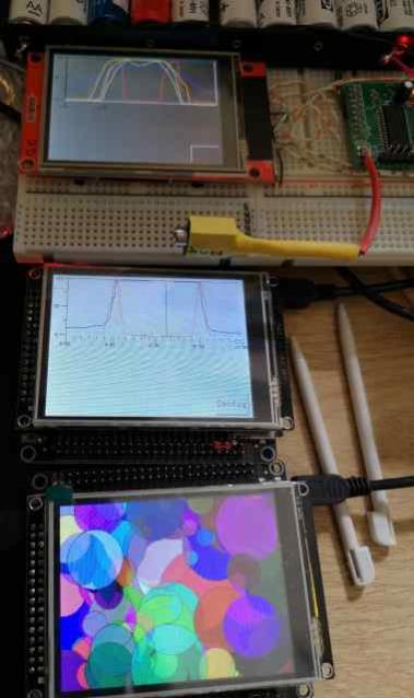

Second one up even quicker... The "twins" on test with one of my MM2 28 pin jobbies at the top.
rough side-by-side tests, I reckon the F4 is 3 to 4 times faster than the MM2 at 48MHz just by judging the redraw of the screens you see here
