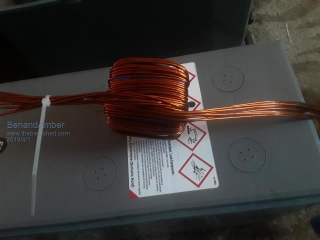

F4
Ten in hand 14awg seems kind of small to me
still really hard to wand on those small toroids
chassis wiring guide says 32 amps four 14 awg
So with temperature rise should be good up to 320 amps
My Transformer is 5,000 watts this will be the upper limit of what I'll be runningEdited by BenandAmber 2019-04-02

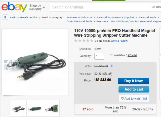

I used the same approach: multiple small diameter wires (awg 19) for the toroid primary and chokes.
Because I will be stripping hundreds of wire ends, I bought and used something like this.

So I guess I'll have to use a little rotary tool for now

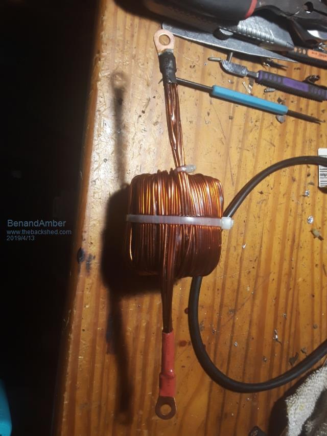

I put ends on that inductor took me forever and a day to get all them wires done but I did get it done and then I coated it in resin so hopefully it won't be noisy

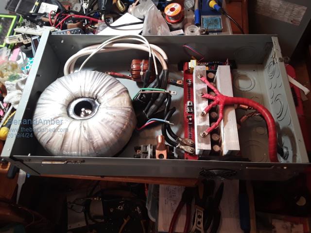

The wire on the low side primary is2 AWG and it has two of them on each side
the wire on the high side secondary of the Transformer is number 6 AWG and there's also two on each side
wire coming in from the batteries is 0/3 it's copper good for well over three hundred amps
it's what was left over from a large commercial building install it is very hard to bend have to have cheater pipes and I'm not a little guy
Believe it or not the biggest problem I am having is the design process wish I would have thought it out a lot more I'm used to bend and wire and tight places this is a whole another Ball Park
I went ahead and ordered a large 48 volt fan it will be on the top sucking hot air out
i have a small 12 volt fan plug straight into the board it's on the side there in the picture and it'll be kicking on and off by the board
I've seen a lot of inverters on this site that looks a whole lot better just a little bit jealous
I've never designed and built an inverter before so I don't think it's too bad for a beginner
yeah I'm talking about you warp speed yeah renewableMark you too clockman France and a lot of others on this list of jealousy I could go on and on hey I just about forgot tinker
give me another 5 or 10 years maybe they'll start looking a little better
All jokes aside really really impressed with a lot of the inverters I see on hereEdited by BenandAmber 2019-04-25

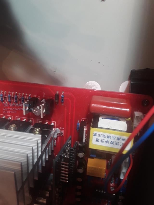

Incidentally where is the temperature sensor. Would appreciate if you could take a photo.

Sorry for rambling on the heat sensor is right behind the little ESG 00 2 bored attached to the front of one of the heat sinks
it's the little grey thing
I have not powered it up yet waiting on a few wire connectors to come in to finish wiring it up
I also am not very happy with the choke that I made for it I may be building a larger choke
when I do fire it up it will be on video for all to see in case of it blowing sky-high

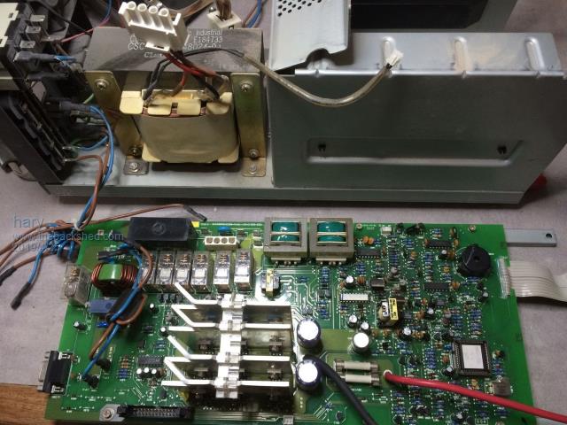

I don't have toroid at hand but have old UPS that I was thinking to hack for my inverter purpose.
Might be a good start with this little chinese inverter board.
Thanks for the photo BenandAmber.
Encouraged by your build I ordered one myself. So I am mentally planning the build.
The reason I asked the question about the temp sensor and whether you have fired it up yet, is because I believe the fan is likely to run continuously because of a small flaw in the egs002 board. You have reported the issue in the other smaller inverter that you have built. Luckily the solution is fairly simple. Its just soldering a fixed value resistor under the board, to get the fan to start at a particular temperature.
In this bigger board, of which you have posted the photo, things are easier in terms of fixing the issue. Since it doesn't have that black flying lead from the main board, the egs002 can be removed for testing. What we need to know are the specs of the NTC sensor in the photo. The application notes indicate that the NTC resistor is of the type that has a value of 10K @ 25 degC. The application note says that a 10K resistor will cause the fan to come on at 40 degC.
So hopefully your firing up and the arrival of my board from China should coincide. What you learn from firing up of the board will be of immense value for me in building my inverter.

BenandAmber
Joined: 16/02/2019
Posts: 961
Posted: 02:46am 26 Apr 2019
Yeah exactly what he said
Thanks for clearing that up poida the great
I hope you and your family are doing well and I'll never forget what you've done for me and my family
And since I've got you here is all current functions shut down on my board
Or do you suggest I do more to the big board done exactly what you told me to do in the Little China board post to all of my China boards
The reason I'm asking is I'm getting ready to fire up the big one here soon and didn't know if it would be any different from the little one
You can only give advice if someone messes up it's on them not you!!!!
Everyone on here is so very careful with the advice they give
I cant understand why they would think it's their fault when someone else messes up
And be so humble when everything goes exactly as planned

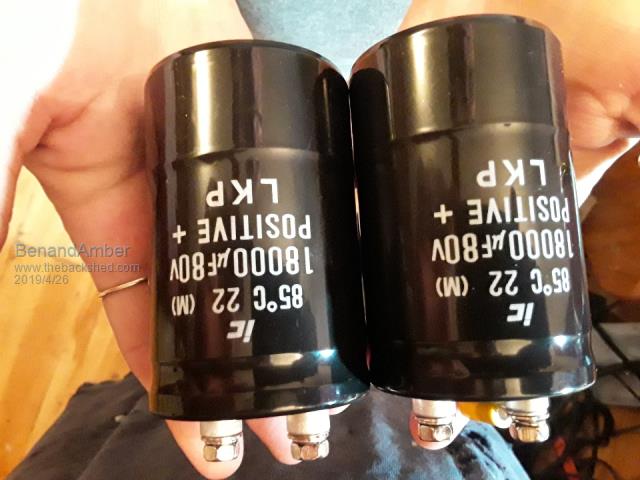

By the way I am very very happy with the little inverter did you see them big capacitors I installed in
it
I know four mosfets shouldn't be powering a small air conditioner and big circle saw box fan and lights and whatever other tools I happen to be using at the RV at the time
But you was exactly right by saying these things are bulletproof when you set them up exactly the way you say
I know it won't be able to dissipate all that heat one day and we'll blow
I put the biggest case fan in there as close to the heatsinks as possible and it runs constantly never shuts off
It's been like the Energizer Bunny so far but I'll keep everybody updated

Azhaque
I am sorry I just seen your last post
I haven't had any temperature sensor problems
someone else was texting about it and I said it would be nice to know how to make it come on at a lower temp
I don't even know the temp that it comes on at
If I remember correctly I read somewhere that poida the great said it was fine the way it is
So I haven't given it any more thought I am using it exactly the way it is in my big inverter build with a really low amp fan
And I will be putting a very large fan on the top of the case that will run all the time it will be powered off of the battery input so if the inverter is hooked up it will be on
