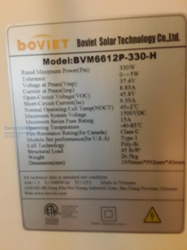

For a example here is the name plate on the back of my solar panels
Vmp37.4 ×2= 74.8
Imp8.83 ×0= 8.83
Voc45.8 ×2= 91.8
I'm going to be going with 48volt battery Bank 4 in series then parallel with the others
13.6 ×4= 54.4
Voc 91.8-54.4=37.4
Vmp 74.8-54.4=20.4
They are AMG 144 amp hour
could this be a good match up to my batterie bank
I just don't know enough about it to know
I bought these because they were really cheap
I couldn't afford them any other way

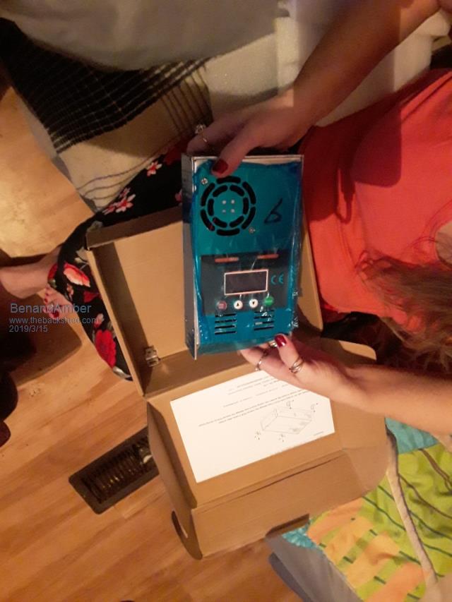

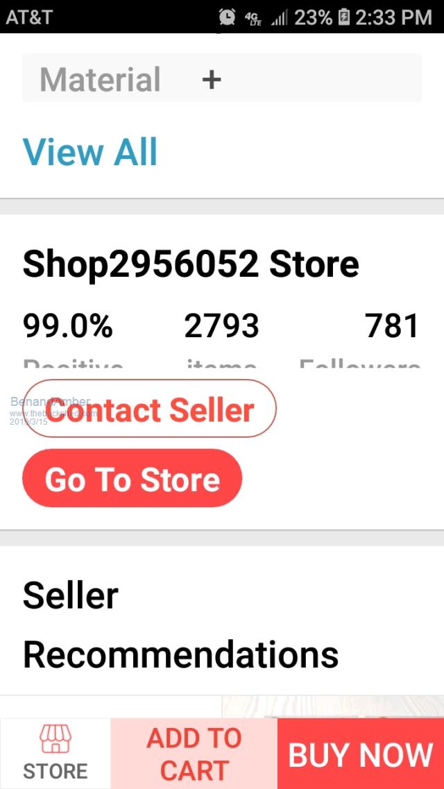

the other picture is of one of three charge controllers I'll be using for now unless you come up with a better homemade one Edited by BenandAmber 2019-03-16

Based on the PV panels you have, with their summed Vmp = 74.8v and Imp = 8.83 the total power output could be 74.8 x 8.83 = 660 watts assuming 100% efficiency and full sun.
Your lead acid bank 4 x 12 volt batteries, when near flat the battery voltage = 44 volts, if you connected this direct to the panels via a PWM charge controller, the panel voltage would be pulled down to 44v at max 8.83 amps = 388 watts input power, so 272 watts are being wasted due to mismatch.
As the bank charges up more to near 50% the voltage might be 12.3 * 4 = 49.2, so input charge power = 49.2 x 8.83 = 434 watts, so 225 watts being wasted.
If you use a mppt controller, then this will better utilize that wasted power caused by voltage mismatch, but these are quite expensive for quality units.
There are lower voltage PV panels that have a Vmp of 30 volts, these provide a better match and less power would be wasted. Paying top dollar these would be the ones to purchase if wanting to use a much cheaper PWM controller.
If you were going to use several KW of your panels then the potential wasted power all adds up to quite a lot. However as they were cheap then just use a few more to compensate for not having an expensive mppt controller.
For those of us using Lifepo4 banks the situation is much better, the near flat voltage = 48volts and 50% = 52.8, so PWM controllers working with 30Vmp panels work out quite well, there is no point in going to mppt.
SolarMike is developing a nice MPPT controller. I am looking forward to see his results.
You have all you need already.
3 x MPPT controllers
a 48V battery
some panels.
I would probably hook up pairs of those 37V panels in series to give about 74V at max power, and send that into the MMPT controllers. Split things into 3 so as to place the minimum power load on each of the controllers.
How many of these panels do you have again?
What is the current rating of the 3 controllers? These are Chinese so we probably
won't want to run them anywhere near maximum current. Ever.
And once you have things working for a few months, you can then see if it's worth it to make one or more of SolarMike's controllers and retire to the spare parts pile the Chinese controllers.
That's how I would go.
the controllers look like these ones Edited by poida 2019-03-16

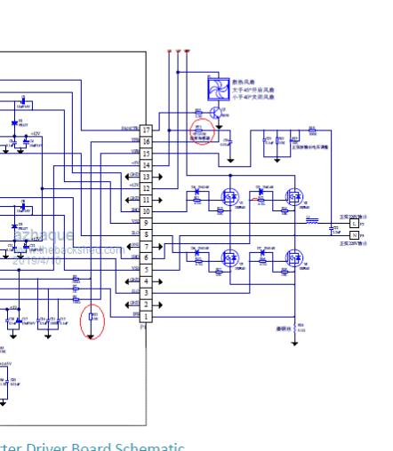

Here is a schematic of the inverter board, it's close enough to be of some value.
But clearly not exactly our boards.
Edited by poida 2019-04-11

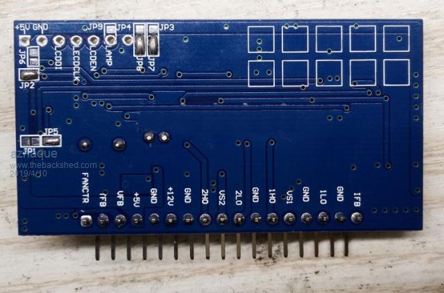

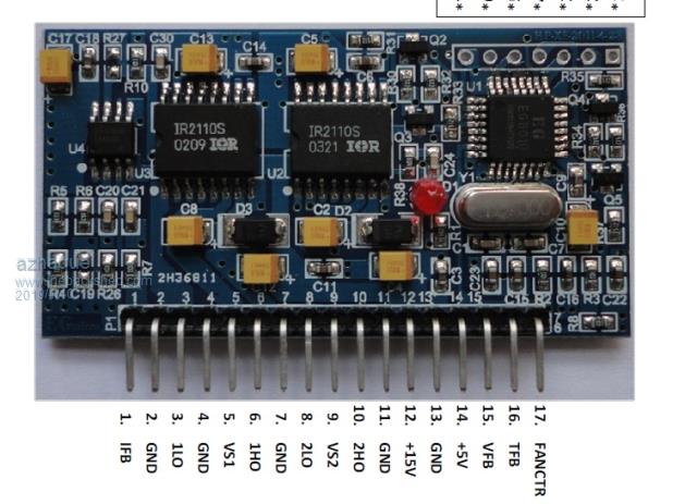

The above image is an excerpt from the EGS002 official paper. The temp. management circuit is composed of a 10K NTC thermistor and a 10K resistor WHICH IS SUPPOSED TO BE ON THE 002 BOARD as R22. The circuit has been highlighted.
The front and back pictures of the 002 board are appended below
FRONT
BACK
There is no R22, either in FRONT or the BACK. So it has to be on the main board OR THERE IS NONE.
So putting a resistor, as you suggest will not help. Maybe it will have to be added.

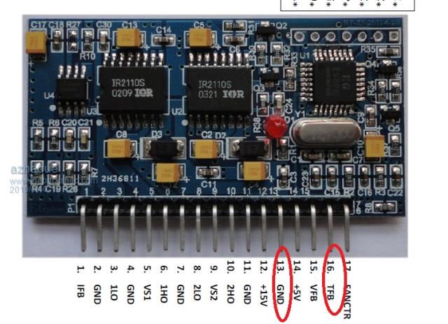

Ben Amber,
Could you please put a voltmeter at PIN-16 and PIN-13 of the small board and measure the voltage as per the following photo.
The voltage should rise to be around 4.3 vdc for the fan to start. In what you describe, you should see a voltage much lower than that value, preventing the fan to start.
Thanks for your help.
I have done this just now.
(Volts at pin 14) (resistance of NTC thermistor), result, temperature from 10K NTC datasheet
less than 3.4V, 4.88K, no fan, inverter running,
3.4V, 4.88K, fan commanded to run, inverter running, 44degC
3.17V, 5.9K, fan stopped, inverter running, 38degC
4.4V, 1.45K, inverter stopped, fan running, 80degC
4.2V, 2.0K, inverter started again, fan running, 70degC
This was done with a 10K potentiometer with 5V at one end and pin 14
on the wiper, to simulate the NTC thermistor.Edited by poida 2019-04-12

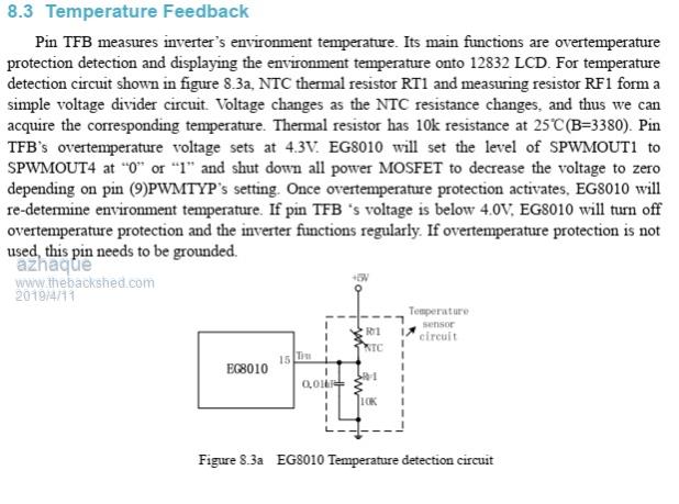

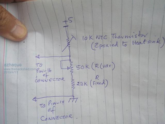

I begin my case with an excerpt from 8010 datasheet, given below
Please note that there is a NTC thermistor as well as a fixed 10K resistor connected to ground in the above figure (call it R(Var) for now). In the EGS002 datasheet that I attached a few posts above, R(Var) should be on the 002 board. But it isn't- not as far as I can see on the images.
The result is that voltage divider is incomplete resulting in serious overheating of the heatsink as reported by Poida and BenandAmber which raises the temp of the heatsink to 80 degC.
So what we need is a simple mod in the shape of a series combination of a fixed and variable resistor. I have modelled the values on an Excel Sheet that I append herewith. With a fixed 22K resistor and a 50K pot, one should be able to adjust the fan trigger temp anywhere between 25-50 degC.
Below is the circuit.
The two components can be soldered together and glued at a convenient location, at which the pot can easily be tweaked. Two leads- one to pin16 and another to pin14 are just the two connections to be made.
Below is the Excel file
2019-04-11_215118_therm.zip
Please note that the NTC thermistor values in the Excel sheet, have been taken from here
Another mod that I would suggest is to connect a small 12volts relay to the fan output. The relay contacts should supply the current to the fans rather than running these off the on-board 12 volt supply which is likely to introduce all kinds of noise into the system.

It seems to me that you are making something simple complicated, unnecessarily.
The temperature feedback had been dealt with extensively some time ago, you (and any other newbies here) would do well to read the many earlier inverter builds on this forum.
Anyway, it works as poida re discovered: the heat sink gets warm,the NTC senses that and turns on the fan.
Now, the fan is supposed to cool the heat sink at this stage. If it cannot because the fan or the heat sink is too small then the heat sink gets hotter still.
At about 60 degrees C, if I remember correctly, the EG8010 shuts down the output, as it is designed to do. It re starts when the heat sink cools down enough. I never experienced any problem with that while testing it.
There never was any need to fit a potentiometer.
However, if you are *really* worried that the heat sink is getting too hot for some reason, why not use an external temperature controller? I did suggest that to Ben in another post.
In my two large inverters I use both, the EG8010 controlled fan blowing air into the inverter enclosure and onto the heatsink. And an independent temperature controlled fan, the sensor of which also senses the heat sink temperature, turns on a bigger exhaust fan. I set that to come on at a similar temperature. This way I get redundancy in case one cooling system malfunctions - has never happened so far.
We have over 40 degrees C in my shed here in summer and the fans easily cope with that. Actually, they rarely run - it pays to use an adequately sized heat sink.
BTW, I do not think epoxying the NTC sensor to the heat sink is a good idea. Use a clamp (miniature saddle like those to hold a cable) and heat sink grease to attach it.
Any equipment I ever took apart *never* used epoxy to attach that sensor.
