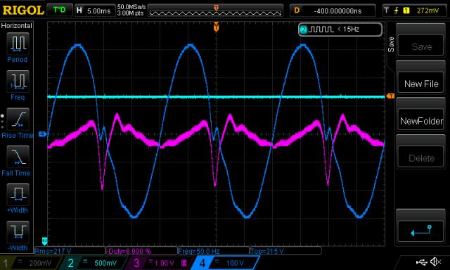

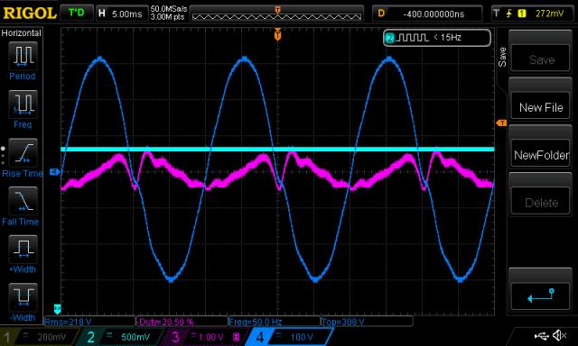

I just completed a little test.
I think it's quite interesting, relating to the unbalanced load issue.

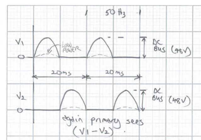

I refer you to the nanoverter modulation scheme, where one 1/2 bridge output does a 1/2 wave, while the other stays at ground, then vice versa.
I try, with some success to ensure that both V1 and V2 outputs are the same magnitude in the development of the code.
They are within about 1 part in 500, in my case of the test inverter on the bench.
I modified nano1 code to permit the addition of a bias to the magnitude of V1 and also to apply the negative of this bias to V2, via a potentiometer.
This now permits me to simulate a very small 1/2 wave diode effect.
Not a complete diode, just maybe 5% of a diode effect on one half wave.
What happens?
Time for more DSO captures, they really tell a story.
Light Blue is bias, zero = centered on screen.
Pink is primary current.
Dark Blue is AC output voltage.
The trigger point is the same in all images, a negative zero crossing
of the AC output.

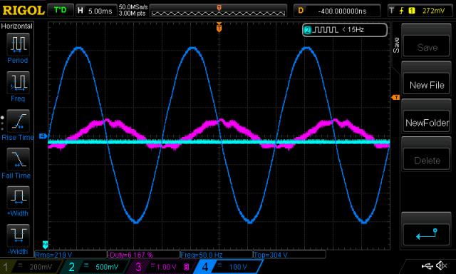

First is zero bias, showing a nice AC output and the typical leading current.

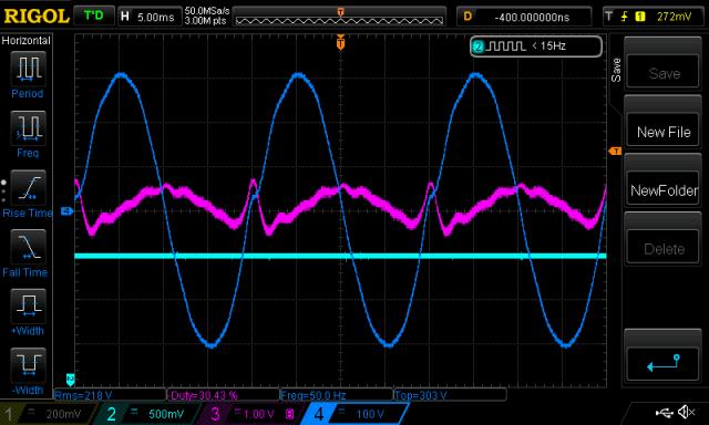

Next is 5 counts of bias, so that means V1 is now (485 + 5) in power and V2 is
(485 - 5) power. this is approx. 1% more for V1 and -1% for V2.
Immediately you can see the effect. A clear increase in primary current on one 1/2 cycle.
Note:
These DSO captures are under a steady state, which persisted for as long as I wanted/needed to obtain the data.

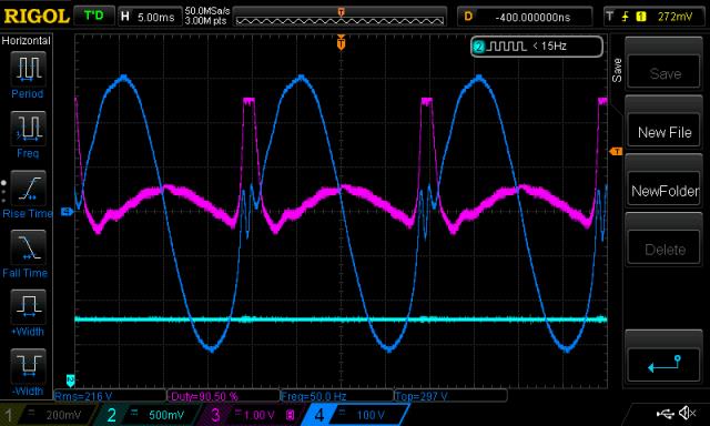

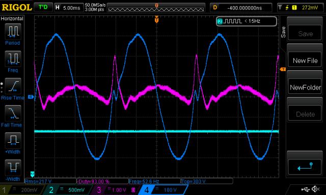

Next is 10 counts bias.
Huge. This is what +/- 2% does.
Here is 15 counts or +/- 3% unbalance in AC waveform.
The primary current sensor maxes out at 80A and it's maxed out now.
Imagine what 1000W pulled from 1/2 wave would mean....

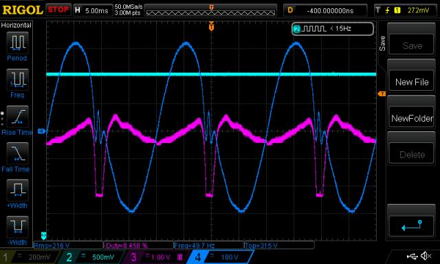

And I went the other way. We see practically identical results, but on the other 1/2 wave.
-5, -10 and -15 bias...

Mark, it would probably make the nasty current spike even larger.
What I find fascinating is the kink in the voltage waveform, but only on one side. That kink looks awfully familiar from many of the inverter output waveforms we have seen posted here.
If the kink is on both sides, its probably more likely due to capacitive coupling between primary and secondary when using unipolar drive. But I could never figure out how it can only occur on only one side. Now we know !
One thing seems particularly strange. The spike on the pink waveform reverses direction. It goes positive on the negative current half cycle, and negative on the positive current half cycle. I would not have expected that reversal.
What to do about it is another matter entirely.

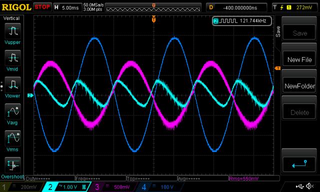

  wiseguy said   Poida, could you please run an experiment and publish the results here if you have the time ?
no problem. See attached excel file.
I performed it at 2 input voltages.
60V was supplied by a 1500VA EI transformer with unregulated output.
There was some ripple on this, as can be seen below.
Maybe +/- 0.7V
Light Blue is DC in, from the unreg supply.
Dark Blue is AC out,
Pink is primary current (inverted, sorry)
I also did it at 27.6V, with 2 x 6A regulated supplies, plus my hacked up 5A regulated supply. Input voltage could be maintained for the duration of the testing at all 4 power levels. I buffered the supply with 100Ah 24V SLA battery.
AC loads were derived from 4 x Phillips "100W" floodlights. (I went to Bunnings to get the 4 globes, 4 sockets, a 4x light switch, cable, etc. Bolted it together on a board, screwed it under the workbench. Now I have my new and improved test load. Thanks for the needed push in that direction!)
Loads were 0, 87W, 166W, 239W and 304W.
When at 239W, it was running at 92% efficiency, according to the DC supply current sensor fitted to the nanoverter. Not too bad.
Testing notes:
nanoverter board, running the current versions.
The toroid is one of the two fitted to a Victron 3000VA inverter.
I used a Power-Mate Lite meter to obtain AC voltage and AC current.
DC supply voltage from a Fluke 87, set to DC.
How to obtain meaning from a DC supply, carrying some AC component?
The Fluke 87 when set to DC and given a 4V DC signal with 2V peak to peak AC
displays 4.00V. Switched to AC input and it shows 0.724V AC RMS.
This is close enough, it should be 0.707 (1/square root(2)).
So the meter can show either all the DC or all the AC. It does not mix the two.

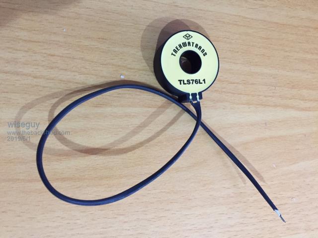

I have an excess quantity of brand new current transformers with a 300mm flying lead connection from an earlier project. The make is Taehwatrans the model is TLS76L1. Their rated current is 300A, the max current is 432A and they are a 2500:1 ratio.
I think they should be very suitable for experimentation along the lines being discussed here - and a lot cheaper than $12.50 each for the 100A units on ebay.
I am happy to make them available at a very discounted rate to any of the back shed members who wants some. I reckon 1 for $10, 2 for $15 or 4 for $25 including postage.
Sorry for the one off price - its the nuisance value.....
Their dimensions are 37mmOD 13mmID 13.5mm deep weight 40gm.

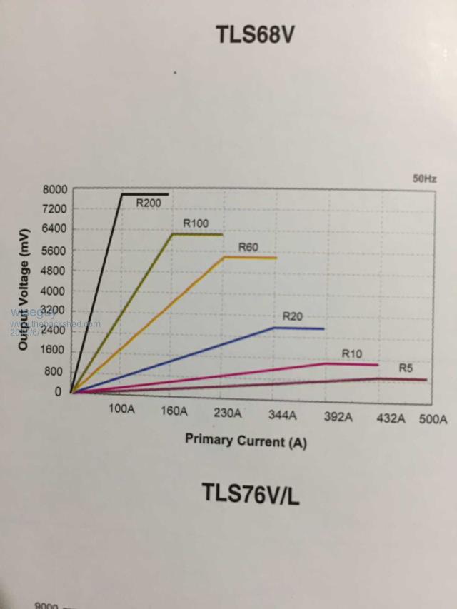

Graphs for various burden resistors @ various currents for related output voltages
Ignore the asterix for the TLS77 type in the pdf below, you want the second one below it, the TLS76
2019-06-01_142023_Scanbot_1_Jun_2019_13.39_s.pdf

Poida, thanks for the test results - they are very revealing.
The first glaringly obvious detail is the output droop when there is no correction applied - regulation is much worse than I expected at around 13% at 27.6V and 13.3% at 60V (input variation at 27.6V was ~ 2% and ~ 8% at 60v).
I note that the current increase in both cases was of the order of 300% and the magnitude of current in the 60V test was half that in the 27.6V test so resistive losses contribution would appear to be quite minor in the scheme of things.
The next interesting detail is the primary current at no load - 10ARMS, yet the actual battery DC input current is no doubt very small. I believe what we are seeing is the charging up current for the AC capacitor on the rising voltage waveform and then recovering that energy back into the supply for the falling part of the wave form.
It appears there is ~ 300W of circulating energy not doing any real work yet. I invite professor Warp to head me back in the right direction if I have made a wrong assumption/s here.
I think the light blue waveform is also inverted (it may be just the input ripple - not sure), the "furriness" every second cycle I guess is switching noise from the primary side that the sensor is attached to, where every second 180 degrees the other side does the switching so the furriness goes during that part.
There definitely needs to be a compensation correction for the output droop but what form will give us the best results is the nagging question and a work in progress.
With the high circulating currents (even unloaded) in the toroidal primary I am not confident that sensing current there will help us as much as I hoped.
Going back to fundamentals, the transformer simply wants to see an ac waveform with an amplitude p-p that does not cause saturation. If the 50Hz p-p drive to the Toroidal is balanced with no net DC component and the voltage correction feedback does not introduce any unintended p-p offset then we should not have a problem - I invite comments ?
Edited by wiseguy 2019-06-02
Cheers Mike

  wiseguy said   Poida, thanks for the test results - they are very revealing.
happy to be of assistance
It is the DC input voltage, AC coupled to the DSO input, to permit viewing at a useful scale.
This ripple is not in phase with the AC output.
Why? The ripple is my street supply, powering the transformer.
I see this ripple progress towards the left or right margin due to frequency differences.
This power supply uses a multi tap primary 1500VA EI into a 40A bridge, then 4 x 8000uF
caps. So it presents a varying impedance to the inverter depending on the full bridge output at any particular time.
I could have captured it where the peaks all line up exactly.
I wanted to show the AC component in the DC supply and measurement consequences thereof.
