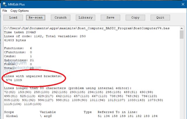

Posted: 04:22am 31 Jan 2019
No speed improvement this time.
I have added checks for unpaired brackets and quotes. If you are using MMEdit or Notepad++, unpaired quotes stand out but brackets can hide.
I have also added 'crunch'
The variable report is still created immediately and then you can 'crunch'
This works the same as the crunch in MMEdit. Comments and blank lines are removed.
You can then 'copy' the crunch output into the clipboard, with optional AUTOSAVE and ctrl-Z added. (It also caters for Maximite and Picromite formats)
Once the crunched (or uncrunched) code in in the clipboard. A right click in TeraTerm or GFXterm will allow you to upload the code with not too much difficulty. You do have to issue your own NEW command first!
In MMEdit, the ending ctrl_Z gets suppressed when 'pasting'. That will get fixed in the next update.
2019-01-31_141722_MMEditPlus.zip

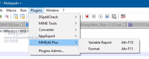

One thing that annoyed me was the need to 'save' before running MMEditPlus from Notepad++
I have created a plugin that uses the clipboard to copy the current active file into MMEditPlus without the need to save. This saves overwriting a god copy of your program until you are happy with the outcome.
Since I went that far, I added a 'Format' option to set the indents of your code using the same rules that MMEdit uses (more or less)
You will need to update MMEditPlus as well as installing the plugin.
The old method using 'run' still works the same.
2019-02-06_163452_nppMMplugin.zip
Edit the inf file to include the path to your MMEditPlus.exe
Place the dll and inf files into a folder named nppMM inside the plugins folder.
It is difficult to edit the inf file once it's placed in the Program Files folders!
My dll is at:
"C:\Program Files (x86)\Notepad++\plugins\nppMM\nppMM.dll"
Exe Path = C:\Program Files (x86)\CCom\MMedit\MMEditPlus.exe
VR Shortcut = alt 121
Format Shortcut = alt 122
Indent = 1
Tab size = 2
For the two shortcuts, choices are alt, ctrl or shft and they do as expected.
The number represents the ascii value of the key eg 65 for 'A'
Function keys start at 112 for F1
The above inf file have alt_F10 and alt_F11
Indent of 1 causes all normal lines to start 1 tab-stop in.
FUNCTION etc starts full left.
Tab stop sets the number of spaces used for an indent.
2019-02-06_163757_MMEditPlus.zip
I don't think I have broken anything but take care, the 'format' alters you code. (Undo seems to work)
I have tested it on notepad++ V 7.6.3 (32bit).
JimEdited by TassyJim 2019-02-07

Posted: 08:57pm 06 Feb 2019
I will work on the 64bit version. There are a lot of problems getting the size of integers correct. I hope the n++ documents are kind to me.
Posted: 02:09am 07 Feb 2019
2019-02-07_120712_nppMM64.zip
64 bit version.
It seems to work but I get nervous working with pointers so give it a try and see how you go.

The formatting partly works and I think you mentioned that when you posted the 32bit version. BTW I really like the way the main MMedit program formats.
Selecting Variable Report from the Plugin or Alt+F10 does nothing, using the existing Run shortcut works fine.
Formatting appears to fails in the latter part of an editor file in NP++ as the file size increases.
Mike.
