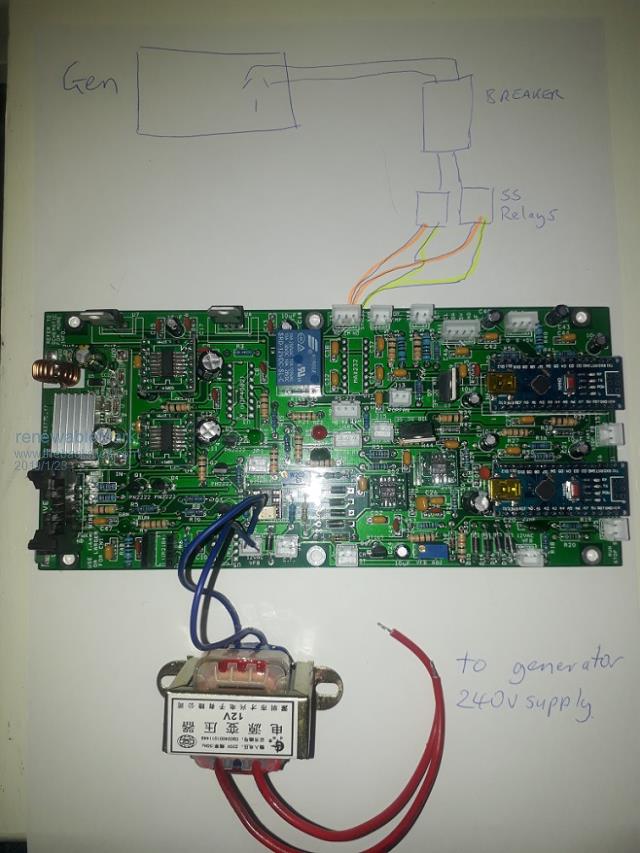

Just checking I am understanding the proposed gen sync connections.
Is this drawing correct?
And are these relays fit for the purpose here
And with the breaker is this OK?

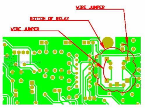

The transformer connection looks OK to me.

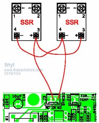

J3 only provides mechanical switching signals coming from the on board relay K1. The solid state relays you picked require 3-32vdc to turn it on. So, as connected they will not turn on. If you want them turned on by the code (if the code supports K1 turn on), you will need to modify the PCB slightly. This is bottom side of the PCB.
Here is the connection of the solid state relays (input). This will apply +12vdc to the SSRs when the on board relay K1 is turned on. This is top side of the PCB.
I am not familiar with what you want to happen when the code turns on relay K1. I have not checked the code. Maybe poida can help on this one.Edited by tinyt 2019-01-25

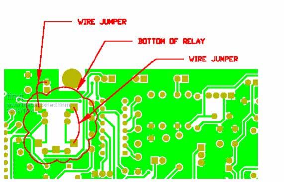

Oops, I made a mistake on the mod drawing, I forgot to mirror the gerber for the bottom view of the pcb.
It should look like this:
Sorry.

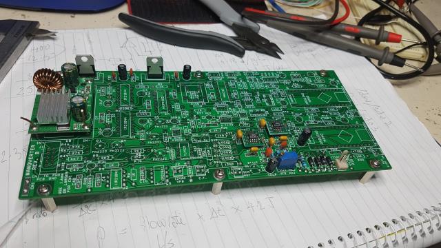

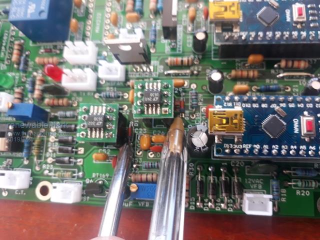

I have at last made a start on a board.
First get power supply going, then passives around nano1 and the 2 Vfb opamps,
put the opamps on to the 0.1" breakout boards you thoughtfully supplied me.
Maybe tomorrow I apply power, first without opamps and nano1, then fit those 3 items and see if it lives.
I need to get to Jaycar for 15K and other resistors tho.

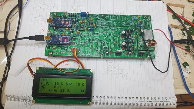

Posted: 02:31am 10 Feb 2019
it lives!, Igor, it lives!
bare minimum:
5V and 12V regs
inverter "RUN" green LED
nano 5v supply, ADC Vref
the two AC Vfb opamps
the two IR 21844 sockets and charge pump, decoupling caps
I2C
A few 2 pin connectors
The pic shows calibrated DC V supply at 28V from the bench PS.
Later I run it in anger..

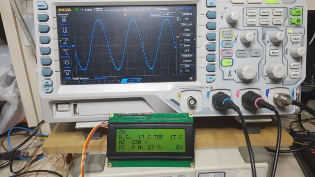

And I have it running the test inverter now.
It was a fiddle getting Vfb right. My Vfb transformer is a 9V, not
a 12V as specified.
I attach the most recent code.
I changed the AC output setpoint, to a smaller value to reflect
my 9V transformer.
When anyone here builds one of these boards, we will need to talk about how
to get a reasonable setting for R31, Vfb adjustment trimpot.
There is ample scope to try running the inverter with Vfb trimpot set to output 300V and that will blow stuff up. It is best to have it set to about 180V and when running, adjust it up to the desired output voltage.
The first attempt was without the shutdown transistor network in place.
This permitted the gate drive ICs to float their shutdown pins.
Naturally, the inverter was unhappy.
But after putting Q1-4 and the resistors in place, it runs really well.
The Gate drive output is disabled upon power up to the DC-DC converter.
Also they are disabled until you switch the board ON. This is perfect.
No spurious gate drive during DC supply ON or OFF.

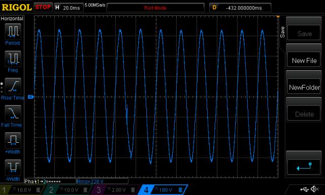

The output waveform, zero load, 27.4V DC supply.

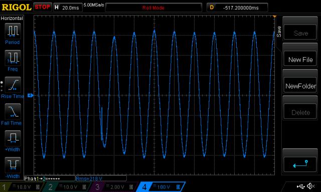

Here is the transient response when I switch 150W incandescent light on.
(my standard test load for the bench setup)
This is very good transient response to my mind. It is very similar to

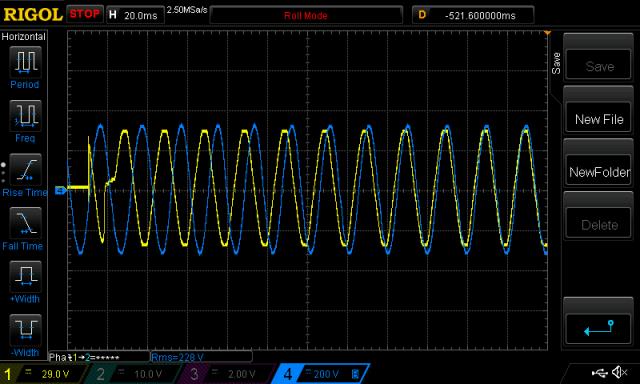

I have mains sync working too.
It's nice to see the LED light up and hear the relay click
when sync is obtained.
Blue is AC output from nanoverter
Yellow is external mains as applied to J2.
It only needed 11 cycles to shift the output nearly 180 degrees.
My external mains isolation transformer is not 12V it's 30V.
And so I applied 30V to the 680R + 1N4007 + TLP523 opto.
What was that smell? No harm done. I added a 1K in series to
reduce the current. All good.
