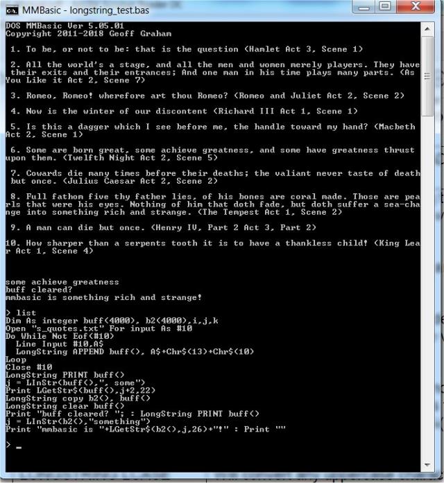

Posted: 03:47pm 21 Dec 2018
  matherp said
  Quote  I've downloaded the source and successfully compiled
Substitute these two files and you should be up and running
Done. Compiled in 13 seconds. Here's the output of a test program, with listing of the program.
[code]
dim as integer buff(4000), b2(4000),i,j,k
open "s_quotes.txt" for input as #10
do while not eof(#10)
line input #10,A$
LONGSTRING APPEND buff(), A$+chr$(13)+chr$(10)
loop
close #10
LONGSTRING PRINT buff()
j = LInstr(buff(),", some")
print Lgetstr$(buff(),j+2,22)
LONGSTRING copy b2(), buff()
LONGSTRING clear buff()
print "buff cleared? "; : LONGSTRING PRINT buff()
j = LInstr(b2(),"something")
print "mmbasic is "+Lgetstr$(b2(),j,26)+"!" : print ""
[/code]
