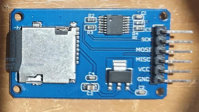

Has anyone got their board up and running yet?
Everything's working: GPIO's, button, LED's
(unfortunately I don't have a RTC yet - it should have come by last saturday at the latest )
...but unfortunately no SD card access!!!
I get always:
IOS: SD error 2 (NOT_READY on MOUNT operation)
IOS: Check SD and press a key to repeat
...I tried four different SD cards - all the same...
Only the BASIC on S220618_IOS-LITE-Z80-MBC2.ino works for me...
Does anyone have an idea?
Frank
jman
Joined: 12/06/2011
Posts: 711
Posted: 05:16am 21 Dec 2018
Hi Frank
Mine works as expected. Does your SD card adapter look like this one
Jman
Frank N. Furter
Joined: 28/05/2012
Posts: 1186
Posted: 04:04pm 21 Dec 2018
Hi Jman,
thanks for your response! It's exactly the same modul! I have checked all connections (from SD card holder to level shifter and from level shifter to ATMEGA32A) and can't find any error...
I received my RTC today - it also works like the rest of the components!
Do you know a test sketch to test the SD card access? Which version of the PetitFS library have you installed?
Which fuses did you use with the ATMEGA? - maybe that's where my problem is?
I tried:

the cards are all of different sizes (4GB to 16GB) and from different manufacturers. They are all FAT32 formatted and work with e.g. Color-Maximite or Duinomite without any problems.
I've measured everything from pin to pin and can't find any errors. The contacts in the card holder look good under the microscope.
It makes no difference whether I insert the card holder at all or whether a card is inserted or not. Possibly the level shifter is defective or I have some adjustment problem with the ATMEGA...
Frank
Update: I compiled the CardInfo sketch and it worket without any problems - I can see all my files on my card! Edited by Frank N. Furter 2018-12-23

Ok, I don't know why, but it works!
I had to go to "pffArduino.h" under
// SD chip select pin
and change the entry to
#define SD_CS_PIN 4
...BUT WHY???
Now I have access to the SD card!!! (I hate Arduino!!!)
Frank

Hi John,
you are right!
I think it was a user error on my part. I probably mistakenly didn't copy all files into the program directory and didn't notice it because PetitFS was already included as a library...
Now it runs!
Frank
