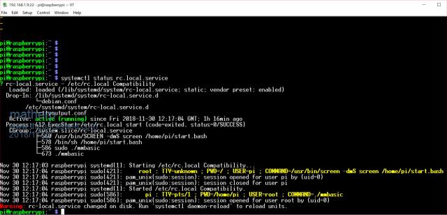

Posted: 09:17am 30 Nov 2018
Just set up another pi with no issues.
  Quote  It still will not boot into screen let alone MM
screen won't be there unless mmbasic has run
You do have mmbasic and start.bash in /home/pi ?
Try deleting .options just to get a clean start without autorun. Reboot the pi and then look at what happened in rc.local with the command
systemctl status rc.local.service
Edited by matherp 2018-12-01

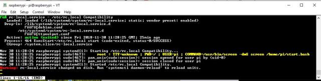

lew247
Joined: 23/12/2015
Posts: 1709
Posted: 11:56am 30 Nov 2018
Yes I have it in the correct folder
I got this result
I don't know much about linux but the TTY=unknown - isn't that something to do with it trying to communicate with something that isn't there?
It says [quote]Nov 30 11:28:25 raspberrypi sudo[467]: root : TTY=unknown ; PWD=/ ; USER=pi ; COMMAND=/usr/bin/screen -dmS screen /home/pi/start.bash[/quote]
Edited by lew247 2018-12-01
Posted: 01:38pm 30 Nov 2018
This is what I get:
Did you try deleting .options and disabling autorun so MMBasic can just start at the command prompt? screen will not stay running if MMBasic doesn't start

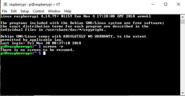

Posted: 02:05pm 30 Nov 2018
Yep
Tried it all
I just this second deleted the .options again
made sure autorun was off
started screen loaded MM
CTRL Z to exit MM
then sudo shutdown -r now so the Pi rebooted
After it rebooted I opened Terra Term again
SSH'd to the Pi
typed systemctl status rc.local.service
and I got the exact same as before
I then typed screen -r and I got "there is no screen to be resumed."

Proof rc.local exists and is in the correct location

List the contents of start.bash with "cat start.bash" in your /home/pi directory. This is what actually starts mmbasic. Make sure you have made it executable with "chmod +x start.bash".
Start mmbasic and enter "OPTION LIST" and "LIST" so we can see that you have AUTORUN on and what your program looks like (PRINT "Hello, world" will do).
Even with no program, mmbasic should be started if you have a proper start.bash file.

I trust this is a cut and paste error. The last line in start.bash should be just "sudo ./mmbasic"
If you do "ls -l start.bash", does it show it to be executable?
If after "ps -A -f" shows that there is no mmbasic running, if you do "screen /home/pi/start.bash", does mmbasic run?
If you end up at the linux prompt (or from another ssh session), try another "ps -A -f" to show that mmbasic now is running?
If from the linux command line you can see that mmbasic is running, close the terminal session that has mmbasic running (prompt is showing after Ctrl-c, for instance, or output from your program), restart it, check that you have a screen session with "screen -ls", and try to reconnect with "screen -r".
Edited by lizby 2018-12-02
