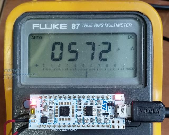

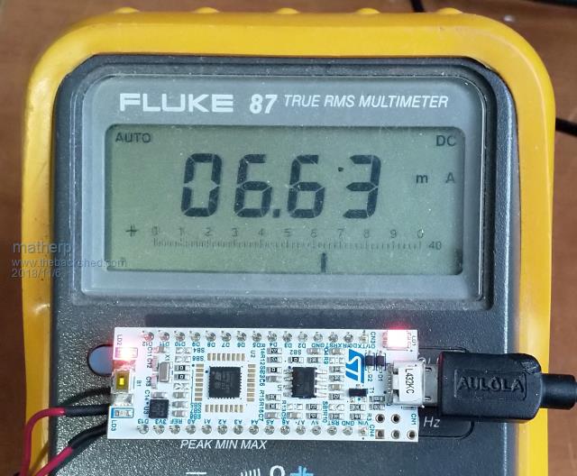

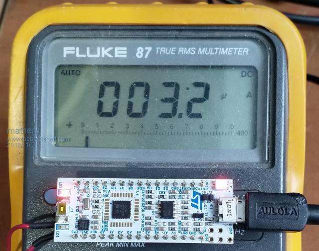

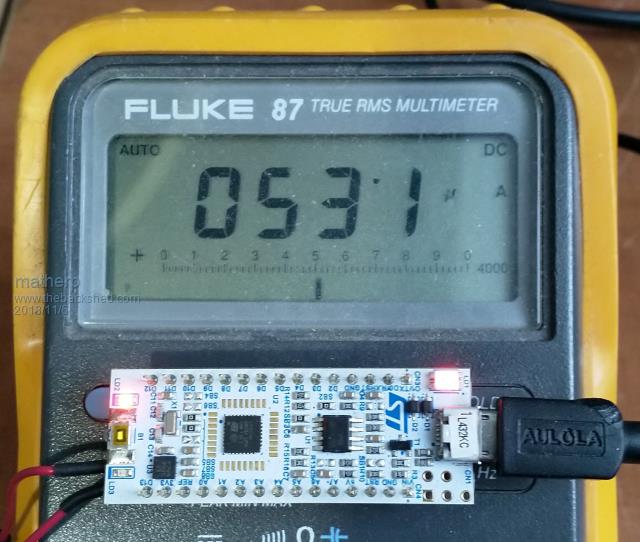

Posted: 03:22pm 05 Nov 2018
Making progress, note the last picture
Normal running at 48MHz
Paused at 48MHz (normal PAUSE command)
Normal running at 1MHz
CPU SLEEP from any speed
Edited by matherp 2018-11-07

Posted: 08:48pm 05 Nov 2018
3.2 Microamps in sleep mode - Wow....
'Nice one, my son!'
@ viscomjim - Yep, I could use that module too, if it has the same chip etc. Smaller is always better for battery-powered things. You don't generally have a great deal of room(physical space) in most battery-powered things.

Posted: 08:56pm 05 Nov 2018
Great work, Peter. I am eagerly awaiting a firmware release as I hope to receive some boards today. BTW how are you measuring the current draw whilst LED etc are running? Have you intercepted the supply line to the CPU?
OA47
Posted: 09:06pm 05 Nov 2018
  Quote   BTW how are you measuring the current draw whilst LED etc are running?
See Nucleo manual page 31. Measured at JP1.
