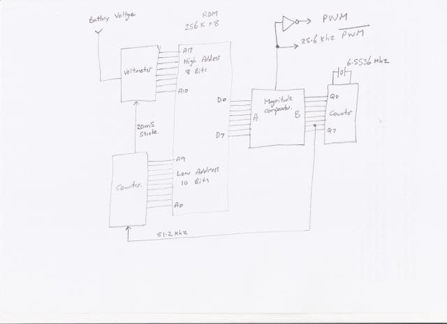

Which approach do others think is the best way forward - I am leaning towards the discrete method ?
I myself am rather "software challenged" and fully appreciate the difficulties. I have always worked with very good software people, and have concentrated my efforts on the hardware side, building a rock solid hardware foundation that the software guys can then exploit to the fullest.
If you want to do PWM, and do it with discrete components you get to choose between an analog solution or a digital solution. Both have merit, and the choice is entirely yours.
My own 5Kw sinewave inverter uses a discrete digital approach but its not PWM. The same technique could be applied to developing a PWM system.
The basic idea is to have a sine lookup table in PROM and use that to generate PWM by comparing the sine data points to a continuously clocked high speed counter in a magnitude comparator. The magnitude comparator output will be direct PWM.
By using multiple lookup tables the amplitude of the PWM can be changed to effect voltage regulation by changing between lookup tables at the zero crossing points.
A further refinement is not to use voltage feedback from the inverter output, as this can introduce all kinds of stability problems if its not made slow to correct.
A complicated PID system would be needed and it all becomes too hard to do digitally without a microprocessor.
A much simpler and more effective approach IMHO, is voltage feed forward correction.
We measure the incoming dc rail and from that decide which lookup table we need to generate 230v output (or whatever). Its very fast acting and can never become unstable.
The no load output voltage from the inverter will obviously be slightly higher than the full load output voltage. But the voltage regulation of the grid is never perfect either. A full load drop of a very few percent is entirely acceptable.
All that is needed is an averaging digital voltmeter to select the high order address of the ROM that holds all the lookup tables, and latch the high order address into the ROM at the zero crossings.
This is the general idea for a proposed very basic eight bit PWM system.
This definitely does work, although a higher bit resolution for generating the PWM would be an improvement. There are not too many parts, and its all fairly straightforward digital.

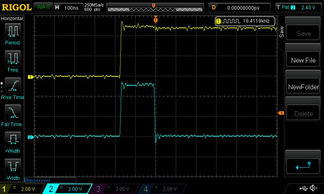

I cooked dinner, had a beer and had a look - my way.
Instead of NAND gates, which I have exactly zero in the collection, I made a simple resistor adder.
Take output of pin 29, put a 4.7K in series, pin 30 again a 4.7K in series, join these two resistors at a point and again put a 4.7K pulling that point to ground.
When both pins are high, I see approx 3.75V, when one or the other pin is high the voltage is about 1.6V. It has adequate frequency response to confirm Wiseguy's observations. I needed to attach 4 wires to the emitters of Q2..Q5 to get the raw output of the EG8010.

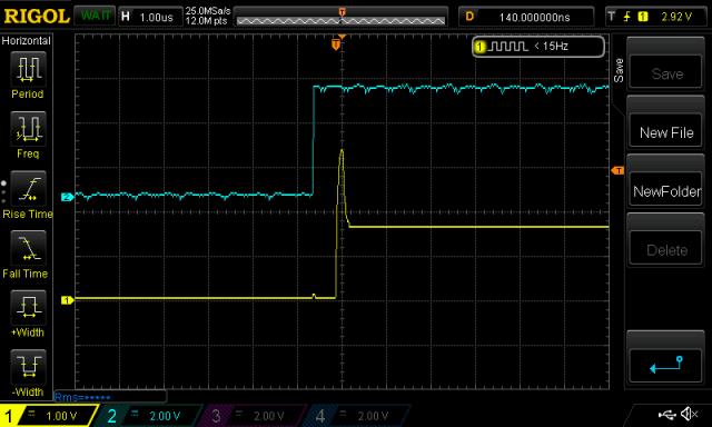

I could not figure out how to configure a trigger on two inputs with the Rigol DS1054Z.
I saw the shoot-through gate drive after the EG8010 resumes from an over temp signal.
Every time. At the start of the first 50Hz cycle.
It happens on the SPWM outputs only, not the 50Hz outputs.
here are a few 50Hz cycles (at the top trace) with a zoomed in view of the shoot-through event at the bottom trace. It gives us some context of when it occurs.
I next took the outputs from the EGS002 pins 8 and 10 which are the gate drive outputs for the SPWM, added them and tried to find the shoot-through situation.
It did not occur. Whether it is prevented by the dead time (IR2110) or the transitors (eg Q2 to Q5) I can't say.
So the EG8010 does in fact generate this unwanted output.
The EGS002 module prevents this shoot-through gate drive signal.

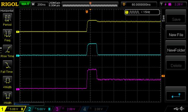

Here is a better sample of the two outputs (pins 29,30).
The 4.7K R resistors I used in the adder let the capacitance of the breadboard
become large enough to low pass filter the signals.
With 680 R resistors things look a lot better.
Yellow is pin 30
Light Blue is pin 29
Purple is the sum of these pins via the resistive adder.

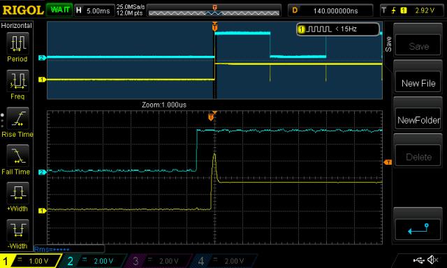

Warpspeed, I do not think the dead time adjustment has any effect on this glitchy output from the IC.
I finally got the trigger working.
Here it is with good bandwidth.
Using the "duration" trigger, I could determine the width of this shoot-through.
No events had shoot-through longer than about 180ns.Edited by poida 2018-09-20
