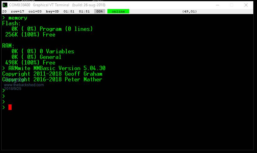

Posted: 12:04am 25 Sep 2018
[Quote=TassyJim]It’s really that simple.[/Quote]
Yes, it really is.
Dead easy to program and get working. I now have a new toy to play with.

Posted: 01:40am 25 Sep 2018
Hi all, also just got mine going - arrived about 20 minutes ago. Also removed the suggested links in Peters manual after looking up what each one did, it all makes sense now.
Only problem I had was when it was first plugged in one of the information lines said "debug in low power mode enabled", while I was reading what to do next it disconnected with a message to open Target - Settings and click "Debug in low power mode" That deselected low power debug, powered up again and it didn't disconnect this time, and the line had changed to something like debug normal mode? Thoughts
As Groster said of TassyJims quote - It really is that simple.
Now to connect a 7" display, external power and select some I/O ports for my program and see if it will run (after removing 2 or 3 things from the program that are not applicable to this MM.Basic version and processor.
