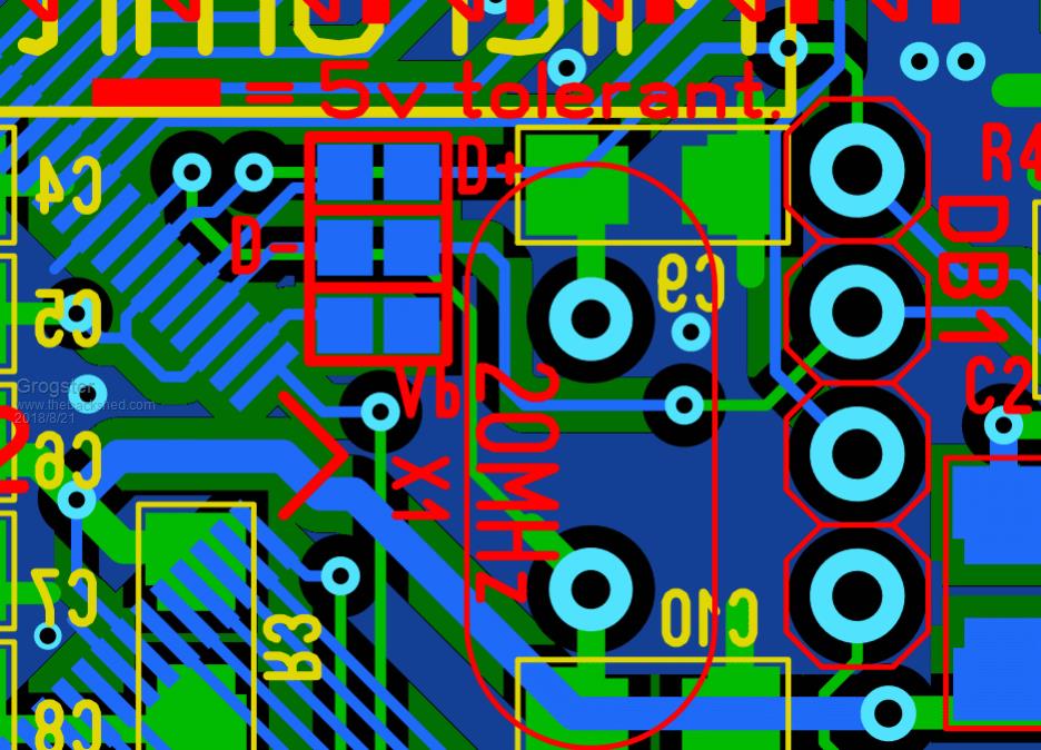

Posted: 07:35am 21 Aug 2018
  Quote  Think Geoff or Peter need to confirm any disadvantages in Vusb being tied high all the time!
Slows down processing slightly as MMBasic only checks for USB input if VUSB high
Posts: 10114
Neither would I.
This is what I have so far:
I have not yet routed Vbus, and it's gonna be tight. I would love to be able to omit that one, and connect it permanently. We just need to know if that is OK to do or not.
Posts: 2998
Posted: 07:37am 21 Aug 2018
  matherp said  Slows down processing slightly as MMBasic only checks for USB input if VUSB high
Thanks Peter. Is it significant to worry about, or do you think tying Vusb high will have a negligible affect only?
Posted: 07:46am 21 Aug 2018
  Quote  Is it significant to worry about
Yes - no reason to give away performance
