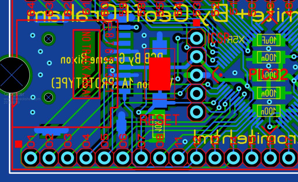

Posts: 10114
Posted: 05:48am 19 Aug 2018
1A is from the prototype run - very old......
From what I remember, the 1A DID HAVE AN ERROR ON THE LAYOUT with respect to the SD-card. I remember having to cut tracks and run thin jumper wires to get it working.
Perhaps this was just my prototype. Does YOUR one say "(PROTOTYPE)" on the bottom silkscreen? If so, it might need a gentle hack.....
I've just looked this up on my files, and YES - the 1A PCB's have errors with the SD card slot, so that is where your problems will be.
HACKS NEEDED TO MAKE IT WORK:
1) Pin-12 on the PIC32 is connected to pin-1 on the SD card, and it should be pin-2 on the SD card.
2) Pin-5 on the PIC32 is connected to pin-2 on the SD card, and it should be pin-3.
3) You will need to cut the ground reference on pin-3 of the SD card and reconnect. I seem to recall this means you have to REMOVE the SD card socket, as the ground track is connected on both sides of pin-3 on the SD card.
Probably not worth the effort for a 1A board.

Posts: 10114
Posted: 05:58am 19 Aug 2018
1A's were the only ones to have that error. 1B's and 1C's had that error corrected so the SD card would work as expected!
The thing I really need to know at this point, is if Bryan's one has that "(PROTOTYPE)" marking on the bottom silkscreen. I might have done a version 1A1 where the SD card error was fixed - but it would still have been called a "1A".
I don't normally sell the prototype run boards unless they prove to have no faults.
