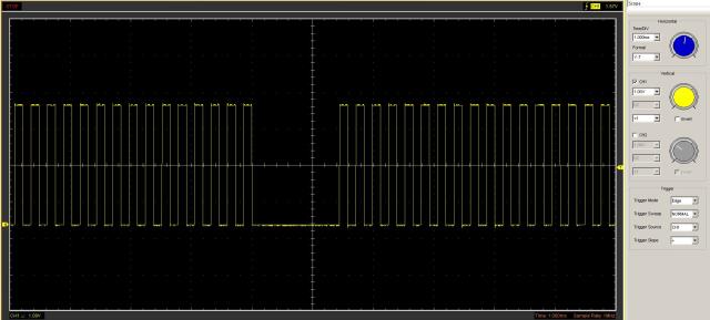

I can see the output stalling. Even this little program will cause it:
PWM 1, 1000, 25
PWM 1, 1001, 25
Loop
Each time the output stalls the signal is low (never high) and each time it lasts for 84mS regardless of the PWM frequency. The occurrence appears to be random. SERVO does the same.
This is going to take some serious debugging as it involves the PIC32 hardware and its documentation (the latter is problematical). Leave it with me.

  Quote  Each time the output stalls the signal is low (never high) and each time it lasts for 84mS regardless of the PWM frequency. The occurrence appears to be random. SERVO does the same.
That's great Geoff (errr... figuratively speaking of course)
I really appreciate you're looking into this.
What you have described confirms what I saw happening on PWM and SERVO commands - I put the time at around 90ms, but that's probably my DSO setup.
Just out of interest, does it happen with the other PWM and SERVO outputs?
Please let me know if I can do something to assist

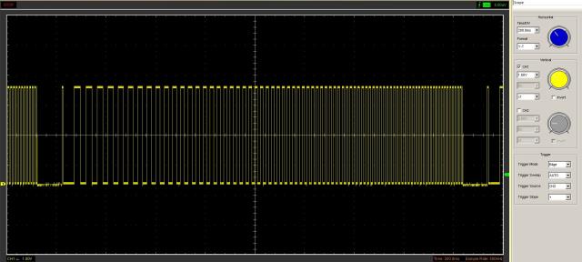

Some experimental observations from this morning...
Here's the code I used (with my running notes as I monitored on the DSO)

Running the "DecreaseForLoop" (which is for decreasing frequency with a j variable) I made a few observations:
1) The first pulse in the sequence is always 3.2 times the width of the second pulse. That's OK for my projected use (I only need the rising edge), but when the duty cycle setting reaches about 30%, the 1st and 2nd pulse merge into a single wide pulse.
2)Setting j to whatever value makes no difference to the final outcome, but it allows more PWM pulses over a longer total time period (more pulses of the same frequency.
3) this works perfectly
(--- I used the j variable to introduce a delay as with the PAUSE statement, but to isolate if PAUSE was an issue, I tried a substitute ---)
Running the "IncreaseForLoop" (Increasing frequency with a j variable)
1) The first pulse is always 10% (in mS) of the set value of the duty cycle. So, if I set the duty to 70, I see a 1st pulse width of 7mS... set it to 20%, I see 2mS.
I didn't try a duty of 25 - presumable I would get 2.5mS, but it may turn out that the first pulse is an integer and will round up to 3mS?
2) Here it gets a little confusing! For the most part, I saw the gaps in the waveform, BUT, changing the j value would produce gaps in random positions but seemingly consistently across the wave form...
So, if I enter a j value of 400 'this' time and run the code, the gap will be in a certain position right across the repeating waveform. I change j to 600 (for example) and I get different gap positions, consistent across all the waveform as long as I ran with 'that' value of 600.
OK, change back to 400 and I get gaps in a DIFFERENT position to the last 400 I ran, but consistent across the waveform for as long as I ran that one!
Sometimes I would change back and forth to all different values and eventually get back to a value of 400, and it would be a perfect signal!
Are we all confused yet with my blabbering, because I sure was doing all this!?
So, running "IncreasePause" (just to triple check the PAUSE statement)
1) The same 10% duty cycle on the first pulse as above
2) PAUSE would create gaps in the waveform and, as above would be in a seemingly random position, but identical across the stream of waveforms. Change the PAUSE value, and I get a different position to the last, but consistent for the time I ran it.
OK, set PAUSE to 10 and I watch the pattern, change to PAUSE 5 and I get a different pattern. Change back to PAUSE 10 - and I get the same gap position as the LAST time i ran with a PAUSE 10 statement!
So, what does all this mean?
I've NO idea
I just wanted to try and learn a bit more on what was happening, but now I'm more confused than ever!
Any interpretations on my observations?

Sorry, I meant to put up the resultant waveform...
That's with MIN=20 & MAX=100

I whittled down the code and ran this...
Const mStep=48, mDirection=50, mEnable=54 <<- Set Constants
SetPin 50, dout <<-- Set Pins
SetPin 51, dout
SetPin 52, dout
SetPin 53, dout
SetPin 54, dout
Pin(mDirection)=Low <<-- CW Rotation
Pin(mEnable)=High <<-- Enable DRV882
Port (51,3)= &B101 <<-- Set to 1/32 Mode
do
for i = 20 to 25000
pwm 1, i, 50
pause 1
next i
loop
Most is to setup the DRV8825 board and I have limited the mode to 1/32 micro-stepping. I've also upped the PWM frequency to 25K, but that's because I've set 1/32 mode.
I kept my eyes glued to the DSO, ready to pounce on the pause icon and finally here's the capture I got.
This is at around 3.7Khz and 1.45mS wide, but I've also captured 1.3mS at various other frequencies too
Again, there seems to be no set pattern or frequency for the gap. Edit: Again, only low, never highs.
With my USB DSO, it could be a limitation of that setup. It could also be my hardware/code, so I'll keep going and see where it ends up.
No doubt, a big improvement on what was prior with a much smoother and sweeter sounding stepper motor.
Edited by Malibu 2018-08-07

A little more...
Here's the code - an adaption of your test code Geoff
PWM 1, 3000, 25
PWM 1, 3010, 25
Loop
That should be (3000/200PPR)*60 = 900RPM... confirmed by the digital tacho.
While I run the code, the motor goes crazy by stopping, starting, hunt forward, run reverse, stop, hunt backward... and so on (It's hard to explain, but it does what motors shouldn't do!)
So, clicking ^C in MMchat, will do one of two things:
1) the Motor runs perfectly sweet.
2) the Motor squeals in a stalled position.
Whichever one happens, the frequency continues smooth and steady at 3Khz and physically, the motor runs according to what it was doing when I actually click ^C.
Still fiddling - I'll keep you updated!
