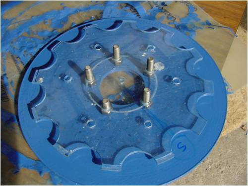

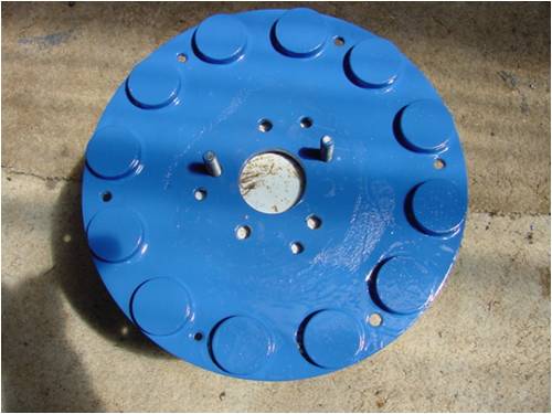

I have finally had the chance to rebuild the alternator of the axial flux. It had magnet cancer of which I will do a story soon.
I have made some statements that flew in the face of other peoples sensible theories on why the axial flux should be riddled with harmonics and circulating currents, and be all but unuseable in Delta configurations. I mentioned the design parameters that I had used, and proposed as guidelines for others.
So, rescuing the magnets gave me a chance to get those real world figures. For the magnet placement the rotor template looks like this.... to get some consistancy:
The populated rotor looks like this:
and the stator has round coils suiting the rotor... this and other parameters can be seen here: http://www.fieldlines.com/story/2008/8/18/83321/8140

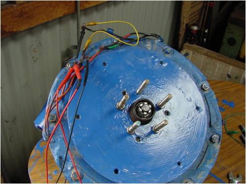

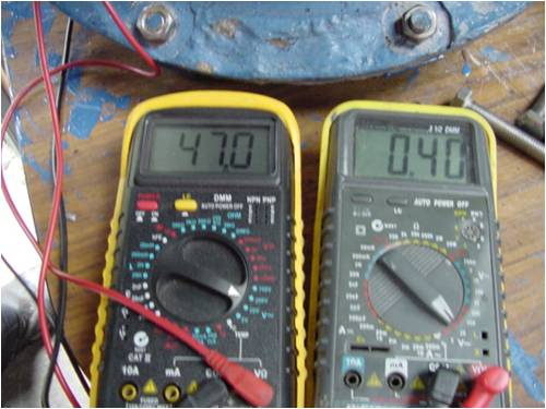

The stator is wired in Delta for this test. A .5R resistor is in series with one delta leg. We measure the voltage across the resistor, and this will give us the AC circulating current. (I=E/R).... unloaded, and knowing the voltage across the resistor causing this current, we can get the power lost due to these circulating currents (ExI).... in this configuration.
This picture gives us the ac phase voltage on the left, and the voltage across the .5R resistor.
So phase voltage = 47v
Current is the .4v across the 0R5 resistor. I=E/R =800 milliamps... this is hardly of significance in a .39R coil. The watts lost across the coil is only IsqR or .8x.8x.39 = .576W... thats all harmonics... everything all up... and it's around half a watt!.... a third of a volt at .8 of an amp... at twice cutin speed for the 36v electric car battery bank.
This explains why I can't notice the torque required to drive the circulating currents.... it barely exists, and is less than the bearing drag and the wind resistance of the magnets whirring around, and also why it takes 12 seconds or more to slow down........and about the same with all phases open ended (no circ currents possible).
So I reiterate, Delta is not the boogie man, it has circulating losses, but these can be small (and mostly overstated), even in a crappy design like mine, or larger in the classic Piggott design. (he has designed for star though).... I agree with Dinges on this aspect.... immaterial if it works better.
It is infinitely more important to match the load, than worry about genny losses. If you don't get the load matched, you will have nothing to lose in the first place.
If delta is matched better for your blade battery combo, then use it, if not I prefer star.... but I will use delta if it works better and currently do..... I'm using a lower voltage battery bank than I designed for... and only using 2 out of 3 blades (one broke) which does not help either on my 36v car... on my 48v mill.... it stalls the star combination at too low rpm..etc)
Of course, there is another simple way to test this without even using a meter. I turned it by hand to get 47vac (about 66 Dc )in Delta.... thats near 300rpm, with only grasping the long bolts in the center....... leverage radius of about 2 inches. If I were using any real power,.. I aint superman....300 rpm by hand is spinning it like a demon..... if it used any significant power at all, this would not be possible, and the run down times would differ dramatically... they are all but the same.
Theory is nice until you test it out sometimes...
