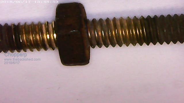

Hi John,
To my eye it doesn’t show any sign of being rolled, I think you see the chamfer on the hex that most bolts/nuts have.
I would think that rolling onto the graphite would risk it cracking but it might be possible..the carbon may be stepped to allow it to be rolled but I think that method is less likely than heat shrunk onto the rod.. at least the electrical junction won’t be liable to arc as the rod can’t loosen, it would have to crack for that to happen..
Of course there are more than one way to most results..
Unfortunately the picture is blurred right at the business end.
If the carbon pad is deemed to be still serviceable you might be able to get the thread phosphor bronze braise welded and re turned/threaded.. I don’t know what the application of heat for the braising would do to it..

Thanks Brian,
I think it’s almost certainly not rolled.. you said the rod went about 3mm deep, is it a plain bored hole or does it look like it’s stepped?
It could be the rod is bonded onto a steel/brass pin that is press fit into the screw.. like i said there are mor3 than one ways to skin a cat.

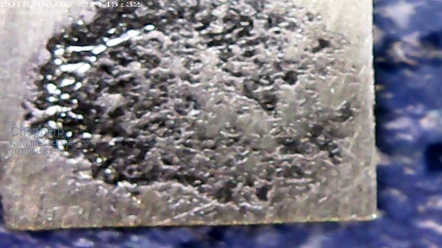

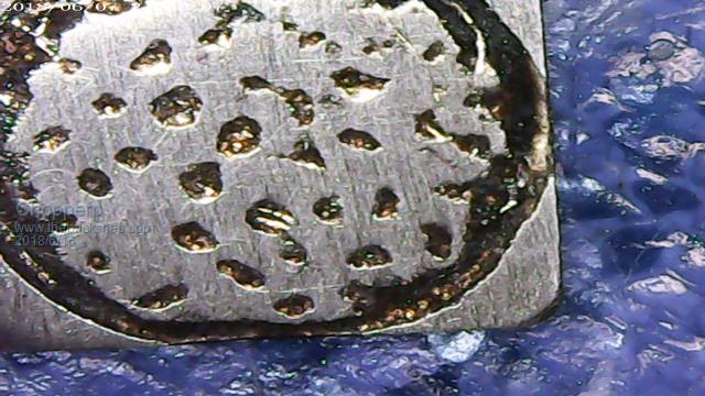

FYI, photos of both sides of the armature contact part way through being redressed. Each totally different 'wear' paterns
ChopperP

Really? The first picture seems to clearly show a stripped thread and the rest of the thread seems pretty ordinary as well. Anyway..

Better Piccie. Old one blurry. Thread is OK. Must remember to upload better quality photos in future.

I have to agree you could not blame anyone for thinking the thread is stripped in the first photo. But it is just an illusion.

Yeh Madness, looking at the photo again, the threads did look bad.

They do have a rather large head for a small thread though.

I stand corrected, I had to have another look. It sure is an optical illusion..

I would suggest the thread is a WHITWORTH thread which have bigger heads than other imperial and metric threads have..
Of course it could have been a custom made job.
