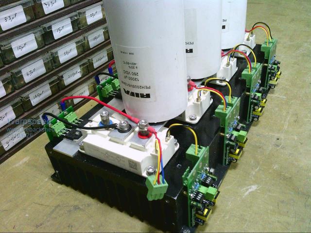

Number of turns (18) was determined by the maximum flux density, voltage, frequency and core cross section in the usual way.
The gap sets the required inductance which was something like 140uH if I remember, although it was a very long time ago since I actually worked all this out.
I did measure core saturation on an inductor tester, something like 50 amps at max duty cycle I think it was. There is some margin there, but not a big margin.
There is a current transformer on each of those PCBs, blue in the top picture, and black in the lower picture, each has a red wire going through the hole. Control chip is a UC3825 run in current mode, so it has a very effective cycle by cycle current limit at 20Khz.
Input reservoir capacitor is a 2,200uF 500v Evox Rifa low ESR electrolytic with a 40A rms ripple current rating.
There are two smaller Evox Rifa capacitors on the dc output rails, each 470uF 385v.
Those are small, but there are two on each dc/dc converter, and more in the inverter, and still more in the mains rectifier, which are all effectively in parallel, but there are long cable runs between
These electrolytics are bolted direct to the circuit board from underneath, so it was simple to use crimp lugs as well for input and output dc connections under the same nuts that secure the electrolytics.
Each 225v dc rail has something like 4,000uF total capacitance to ground, so its all pretty well tied down at 100HZ, so power drawn from the solar panels has fairly low ripple current at 100Hz.

Ahh I had those CT's down as big ferrite beads :) Thats a lot of capacitance, guess I ended up with about 1000uF/Kw as a comprimise on cost & space vs loss of solar efficiency. I see you have an MPPT pot there, do you run your panels at constant voltage or do you have an MPPT finding algorithmn ? I use perterb & observe running at 30hZ that I find is fast enough to track rapid cloud edges.

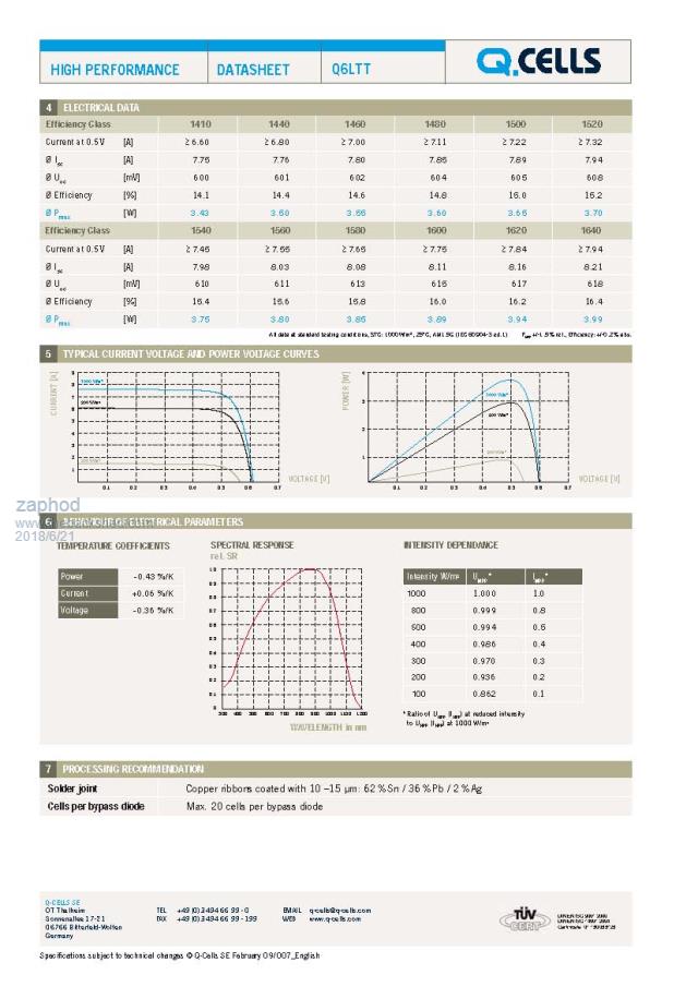

A very long time ago, I did some testing of solar panel output with a watt meter and a continuously adjustable load, and discovered that the power does not fall off as much or as quickly as many people think it does. I also have far more solar capacity than I need, so trying to squeeze the last half a percent out of it is just not worth the effort involved.
I just use a PID system that holds the panel voltage constant to prevent falling off the broad hump under low light conditions. It just overpowers the voltage feedback to reduce loading on the solar source as required.
At sunrise the solar panel voltage springs quickly up to 220v or whatever the setting is, and the solar panel current slowly rises up from zero as the sun gains strength.
Its just an op amp integrator, but it seems to work perfectly well.

Yes I should have mentioned the voltage as C alone is a bit meaningless! Well my bus voltage is just a nominal 180V so about half the energy storage you envisage so at full power some of the 100hZ ripple is reflected back to the panels with a consiquent loss of efficiency however for axample doubling the energy storage is simply not worth the gain in efficiency IMOP I vexed a lot about this and somewhere there are some graphs and figures to justify my choice.
I dont know why I didnt use IGBT's in the first place, all I remember is I did not want thyristors due to drive consumption, I had not used IGBT's anywhere before and as high voltage mosfets are available they were just a natural for me. I still don't know clearly why they were failing and it seemed random and intermittent. The problem with a CSI is zero cross timing is extremely critical but at the same time (pun) difficult to derive as it is an extremely noisy environment. My best guess is despite all my fixes occasionally it just went wrong and whereas an IGBT can swallow the resulting surges a mosfet hasn't got quite the same overload capacity, at least the very high voltage ones (I was using 800V). So far the 1200V IGBT's I am using have survived (touch wood)..........
There have been many discussions about the pro's n con's of true MPPT (the Tracking bit), lot's of misinformation and misselling especially amongst Chinese charge controllers. Realistically it depends if you want to spend a few more bucks optimising your output, there are quite large changes over temperature and output current that can quite easely tip you off mpp especially on the voltage increase side where the slope is steeper as in this picture for example.

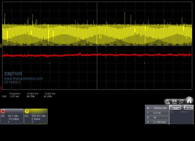

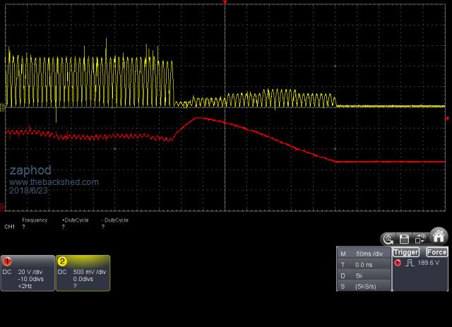

Each day for testing I have to wait for the hot water to reach temperature before I can begin testing the CSI as I have now moved from bench test to real installation.
I am going to put you off MPPT and digitally controlled converters for life as 99% of my problems result from two digital converters fighting each other that fight is over the buss voltage they share.
When not heating the MPPT controller/boost converter tries to maintain a bus voltage of 180V however due to both using IRFB4227 mosfets (very robust) rated 200V it overvoltage trips at 190V. Meanwhile the CSI (that also uses IRFB4227's on the primary) regulates power to maintain a target bus voltage a little lower, maybe 175V. Ok so far so good BUT when a fault of somekind is detected by the CSI it shuts down and due to the low C on the bus it's voltage rises rapidly (due to sudden loss of load) and hits the overvoltage trip! (of the booster). Unfortunatly I already discarded some of the best scope shots of what happens but in this pic you get the rough idea, red trace is bus voltage, yellow is CSI demanded power.
So you can see the bus voltage drooping (bloody UK clouds) and the demand power (yellow) trace starting to reduce but then BAM the CSI primary overcurrents (due to reduced voltage) and unfortunatly hits the power demand to low so the bus voltage uncontrolably rises till the booster hits overvoltage and cuts off! The CSI is still soft starting at this stage and desperatly tries to hold regulation but the booster is in shutdown and the CSI finally gives up when the bus falls to low. Well the fix was not to unload the booster so fast just for one little meany overcurrent event Of course another equally valid (but expensive and space consuming) fix would be to employ a much larger DC-link capacitance.
This picture shows them co-operating perfectly
I enjoy this sort of debugging, it's hard to capture the actual events and work out the sequence, there were quite a few more including switching noise creeping into the heatsink temperature measurement causing random shutdowns but today its basically working hooray
Sadly however after adding half a ton of extra ferrite the EMC problem remains and needs to be dealt with. The hard part of EMC is localisation and meaningful comparisons when changes are made As everybody is at home for the weekend watching football I don't think I can do anything except theorise till Monday

Posted: 09:35pm 22 Jun 2018
I doubt if adding extra bus capacitance would help all that much anyway.
Its basically an unstable load sharing situation, and slowing down the catastrophe is not really a solution.
Stable load sharing is probably the key to this, and the two systems may need to be linked somehow either in hardware or software, or a third system arbitrate.

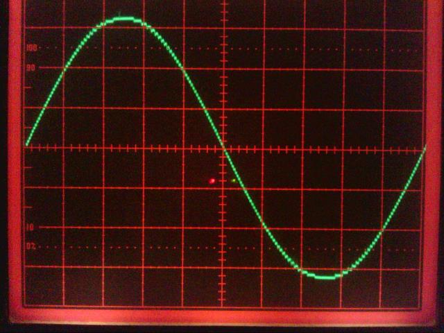

The Intersil 12 bit dual slope A/D integrates over the first quarter of its operating cycle which is 10mS in this case. That averages out one complete ripple cycle of 100Hz ripple.
The whole thing takes up to 40mS to take one dc input voltage reading or 25Hz, but the de-integrating time is variable.
The lookup table address is updated every second mains cycle via a latch synchronized with the zero crossings.
I probably could run it faster, but then I lose the wonderful noise immunity that the synchronous integration provides. Twenty five corrections per second is in practice quite sufficient.
Updating the waveform right at the zero crossing means I can make massive step amplitude changes without any waveform discontinuity.
Also, the positive and negative half cycles always match up, so there can be no staircase saturation of transformers, or other oddities that might progressively grow and possibly cause dramas.
Its pretty simple, the solar dc input provides power to the control board and does all the amplitude controlling. Optically isolated gate drivers then just drive four separate bridge inverters. 4.5Kw, 1.5Kw, 500W and 167w. And that is all it is...
Measured distortion is 1.0% with 81 steps at minimum input voltage. Max measured distortion is 1.7% at 41 steps with twice the minimum input voltage. That is the broad band THD measured without any output filtering.
There are 256 lookup tables that provide better than half volt amplitude steps at 230v, so its pretty seamless in operation. Its a quite unique design approach as far as I know, and that is the fun part of it.
This is the actual mains waveform of my current inverter at 100v per division with 81 steps peak to peak. This is actually powering my house with all the mixed reactive and non linear loads, so the steps here look a bit more ragged than testing with a pure resistive load.

Four inverters on the same heatsink. The two high powered ones on the right use Semikron 200amp IGBT half bridge power blocks. The two small inverters on the other side use individual 50amp mosfets (which I already had) but which will probably later get replaced with suitable IGBTs.
I have had all this powered up, and running with the final drive waveforms from the control board. So far so good.
Still have no transformers for it yet. That comes next.

My very first attempt at this used a single 1K lookup table, and the eight data bits provided eight gate drives for four inverters. One very important detail of this is that the inverters in the zero or "off" state MUST present a dead short across the particular transformer, as the secondaries are all in series. You cannot just open circuit a primary winding. Its pretty easy to do with a bridge, just turn on either the two upper, or the two lower devices together, instead of diagonally.
I did then build a microprocessor version which crunched numbers real time, and it worked fine, but I quickly realized I could simplify things a great deal by having just a huge ROM.
So using the same processor and number crunching software, I added an EPROM burner routine to it, and it made me a very nice 256K x 8 EEPROM in about two minutes of running time which I now use.
The lower 1K is just incrementally addressed forever by a crystal driven counter.
The upper 256 blocks are addressed by a A/D converter.
It could not be simpler.
The idea is that as the dc input voltage rises, each step is made very slightly narrower. Not much happens down near the zero crossing, but the top step rapidly narrows until it disappears completely. In this way you can control the ac output voltage by very fine increments.
Its still a form of very slow motion PWM, which has to work at only 50 Hz.
