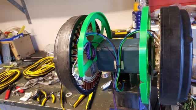

Hi Bruce

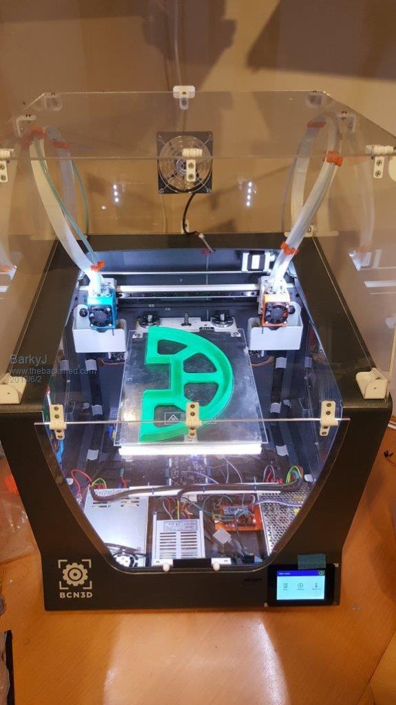

Ha - the green thing is 1 of 4 of the things I have 3D Printed to act as an outer cover holder for the generator, just to keep out most of the weather from the inside.
So the glass plate goes inside the 3D Printer, and it then prints plastic in the design you load in.
Here is a pic of my 3D printer, pretty heavily modified from stock. Working pretty great really. Good for making prototypes of things, or in this case, good for making bearing holders and brackets and stuff.
Got distracted doing a few other bits today, but got some of the wiring done, just temp until the slip rings arrive, and till its all proven to be OK, then ill strip it all down and paint the steel etc.
Can see 3 of the 4 of those holders in place, the last one just finished on the printer, in the first picture.

Bruce 3D printers are pretty much like your Office Works scenario but instead of buying ink and paper you buy spools of plastic filament. Aldi have had 3D printers a few times now.
They work with a print head that is a heated nozzle and motor that drives the filament into the head force molten plastic out the nozzle. The printer puts down one layer of the object on the glass bed then raises the head a touch and puts down the next layer.

Prints layer by layer, starting from the glass all the way up to the top of the model. They come in various forms, but the concept is the same.
I got my first 3D printer about 9 years ago now, it was small and could print things about 120x120x120 or so in size, max.
This printer I have now can print 210x297x210, it has dual heads so you can do 2 colours easily on a print, or 2 different materials.
Very handy things to have.
