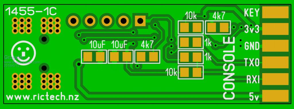

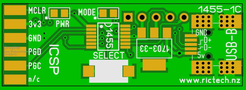

I like the way you think, CG. As soon as I read your first post on this, it made me think, and I have rustled up a preliminary 1C:
This uses a 6x2(assuming you can get such a thing), and has standard ICSP on one side, and console on the other. Console side has 3v3, 5v and ground connections so you can tap into the USB 5v, or the 1703 regulator's 3v3 output.
EDIT: Of course you can get 6x2's..... Edited by Grogster 2018-06-13

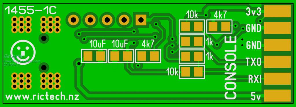

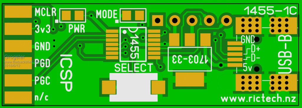

Here is the new version:
This PCB is 43.6mm x 15.0mm in size - small.

However I believe there is a wiring issue with the 1C board. The ground end of the power LED series resistor is no longer connected to ground! Check the left end of the 4K7 resistor just above the word CONSOLE in the lower image above. It connects to a small area of "ground plane" copper, but that no longer has a connection to ground as it was severed by the 3v3 track relocation when you moved the 3v3 pin down one position.

my personal preference would be a small slide switch to connect/disconnect the 3v3. something like this:
https://www.ebay.com/itm//183147427235
you could place the pads for both this and a 0.1" 2-pin header, with those who want 3v3 permanently connected just soldering in a link.
personally, i'd also prefer the SOIC version of the 1455, much easier to solder for the beginner, and only a little bigger.
have you looked at what cases are available that the PCB could drop into? combined with a tidy looking case this could be a marketable PICKIT3 alternative for those just interested in programming PIC32 devices.
rob :-)Edited by robert.rozee 2018-06-15
Posts: 10114
Posted: 01:09am 14 Jun 2018
@ erbp - I will look into this. Yes, the LED has no ground reference in the above photos. That has been corrected.
@ Rob - SOIC is too big to fit in the current layout, however, I will have a play with the layout and move things around a little and see if that can be made to work - you were right last time. (the E28) The SIL switch is a neat idea. I will play with the layout. No idea on case. I was never planning to case it.
