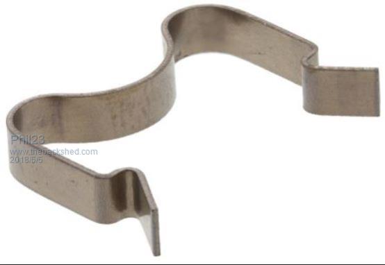

I'd try something like this from a spring steel clip a bit like they use on some heat sinks, but with the catching edges facing outwards, so you can squeeze them in to get them down the slots & then squeeze again to release them.
bit like these, but with some insulating material below.
Legs are wrong above, would need to be folded 90° outwards & have just enough width the fit down the slots.
Phil.
