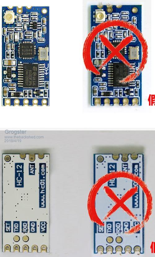

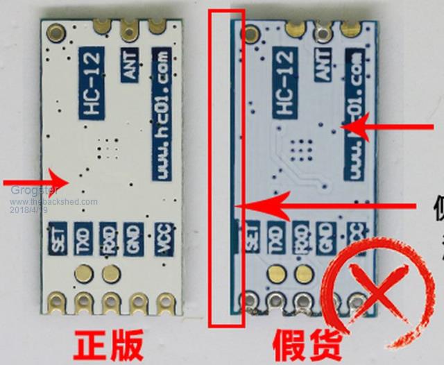

For this thread's reference, here are the photos that Dave is talking about from the HC12 website:
Apart from the slight silkscreen misalignment on the fakes, they are also easily spotted as fakes by the two extra holes on the PCB, indicated by the arrow. If you have those holes on your HC12's, they are fake ones, so it would seem.
I will now check all the ones I have in stock, and if I find ones without those holes that appear to be genuine, I will then test THOSE - but I fully expect them to be spot on frequency wise, being the genuine article.
Certainly something to be VERY aware of now we know fake HC12's are being sold.
EDIT: The 'Holes' I mention are actually on both. The arrow seems to be indicating the thin silkscreen on the fakes, which shows them up. The genuine ones have a thicker whiter silkscreen. The ones I have certainly seem to be the fake ones based on what I am seeing. Luckily, I have only built about six units with the new 'Fake' HC12's, so I will have to f-ing pull them to bit again, and remove the modules and obtain and install some genuine ones. *sigh* However, looking on the bright side(of life!), I had only built 6 units, not 60 or 600 - that would be an absolute nightmare.Edited by Grogster 2018-04-20

One of the things that is visually different between the real and clones, is that the genuine ones have a thick white silkscreen on the bottom. You can't see the bottom tracks because of this. The fake ones have a more see-through milky looking silkscreen on the bottom.
The clones seem to actually work OK from what I have found, but cos they are off frequency, you can't use clones and genuine ones on the same link or network, as they won't talk to each other on the same channel because of that.
