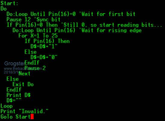

This was my first attempt:
That was a total failure. Just with the white-noise it was outputting all kinds of code, none of which were valid ones. I was trying to detect the long-low and go from there, same as you suggest, but I was doing something wrong cos it did not work. I tried playing with the pause, but it made no difference.
Admittedly, this was just my first attempt.....

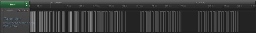

EDIT: Here is a screen-shot of the white-noise vs the data:
The white-noise is on the left, the sync and data words start from about the 50ms mark. This image shows TWO copies of the wanted data on the right, and white-noise on the left when the transmitter is off.
EDIT: Forums have squished this image. If you want a clear GIF image, let me know and I will externally link to it.Edited by Grogster 2018-03-15
