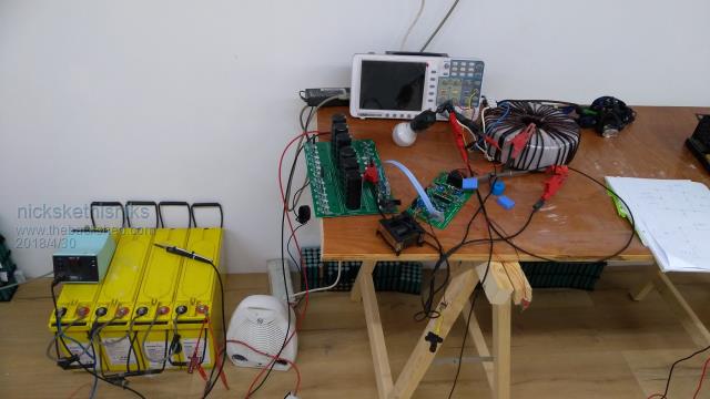

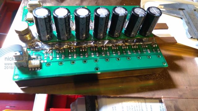

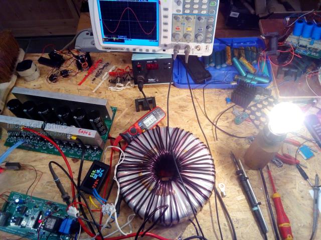

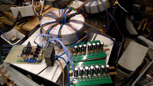

Today I had the chance to make further progress on the inverter. I did assemble the control board without any problems, although I'm missing the thyristor for the overcurrent section. Apparently I forgot to order it...
So, I did test the board, all signals were perfect. I connected it to the powerboard were I allready soldered the caps ( I know, not verry wise..) and soldered 4 mosfets.
I will
Testing was done with a few sla batteries, but I forgot to disconnect the charger, the charger dc current was not isolated, so my scope probes were... . Not good when you want to test the high side signals...
That way I destroyed one mosfet driver and 2 mosfets...
I repair electronic devices for a living so I had to know...
Well it's working... Although I have one problem (I think), I didn't connect the voltage feedback (yet). But the pulses were not going away (good for testing though), it stayed working, is this normal?

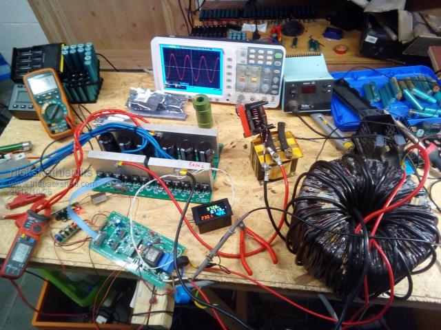

So here the testing rig:
Next step, choosing the output filter cap and the filter coil.
I've tested with 3 turns around a ETD59 N97 ferrite and an 1uF capacitor, that gave me a decent sinewave, I will add another capacitor. I think the core sufice for the kind of power, I designed it for 2000VA, but number one is the low idle power, it will be used for lights. But it will be used for power tools and induction motors during the build of the house.
The above testing is with the 2000VA core, it runs a 6W led bulb with 15W incoming power, I will do more testing next week.

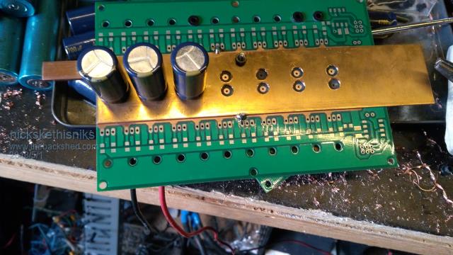

The only reason I bought the book with the boards is because I'm building a house by myself (and my wife) so I have to little time to design the inverter by myself. So I wanted something straight forward.
I like designing boards but I always keep changing the design so I never finish something...

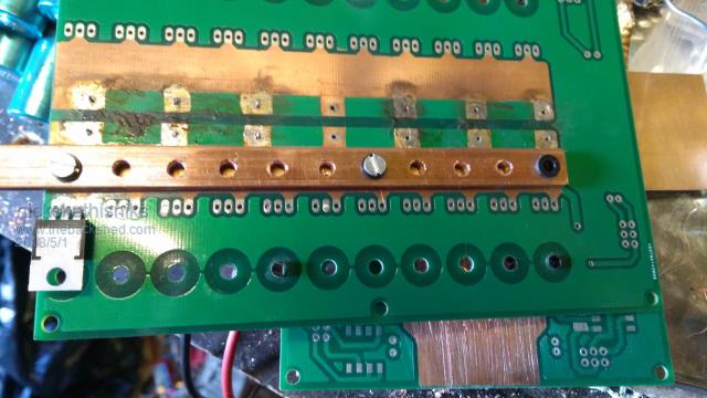

This was something I didn't finish (yet):
Designed for a bldc controller but it's also suitable for an inverter, but it's impossible for cycle by cycle current measuring and soldering busbars is verry difficult, and once cooled down, the pcb is misformed.

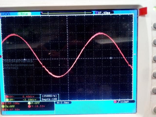

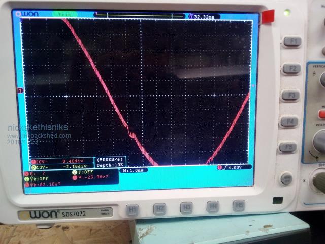

So tested the gate pulses and the problem was in the high side sine pwm. I think the 13V for the mosfetdriver was not enough, I also saw a small ripple on the 13V line.
So I started using a dcdc capable of 15V 750mA. This solved the problem for now.
I also added a ceramic capcitor (100nF) over the 10uF bootstrap capacitor in the gate drive.

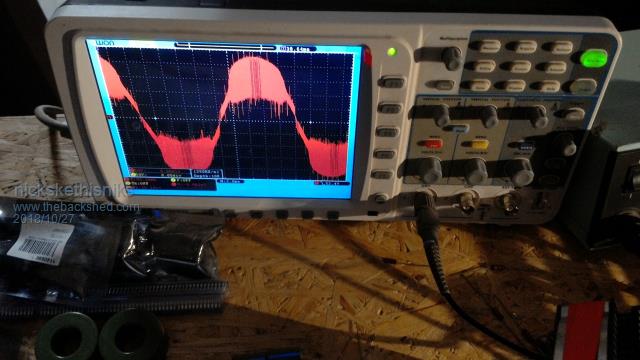

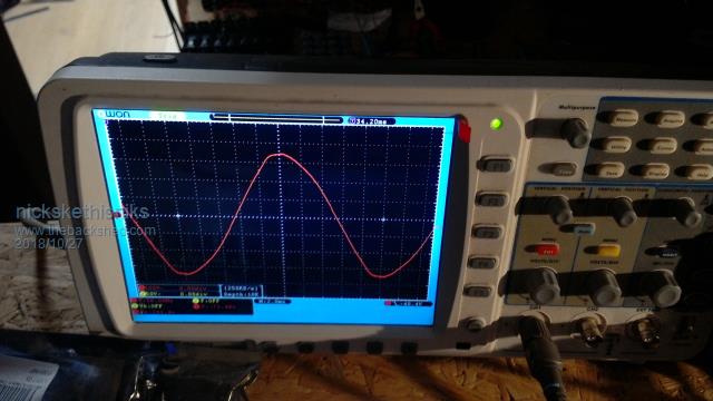

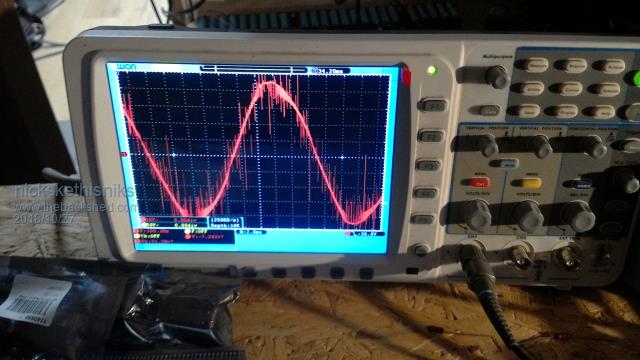

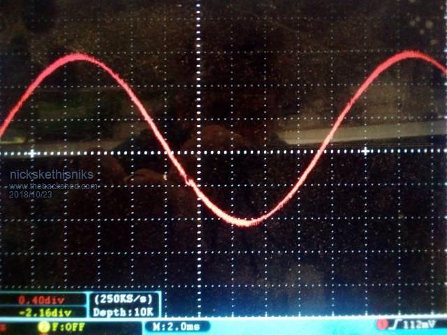

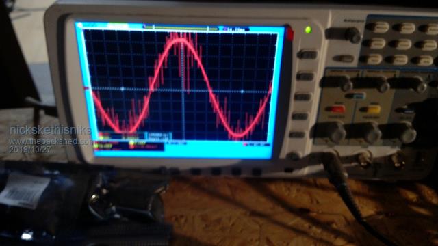

But I still have a woble caused by the same high side sine pwm, this can be seen on the scope screen.
It's presented when using 0,47uF or 1uF at the 230V side. When using 2uF I think it's gone.
So the question is, do I need to worry, and do I need more adjustments in the control board? The tests were done without voltage feedback.

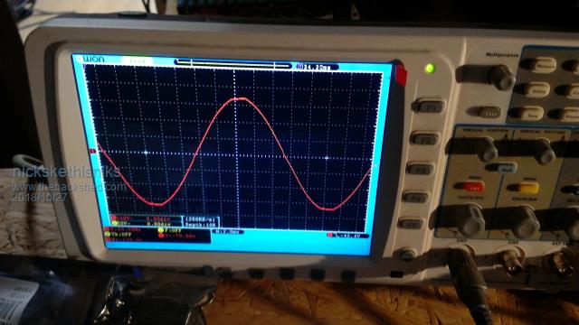

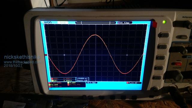

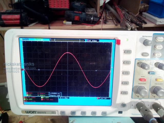

I saw that others had the same scoop images, I tested everything verry good so I finaly dared it to test the toroidal 2000VA core with voltage feedback.
So I made some time to do testing although I need to adjust the current cut off and the final filter choke and remove a few more turns on the primary for higher output voltage under load.

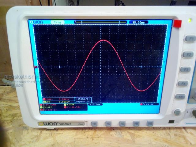

So I tested the 2000VA core, ( isolation transformer with primary and secundary in series, and a new 48V winding)
The zero load @ 230V output is somewhere around 9.5-10W and that is with voltage feedback adjusted for 230V output.
Loadtest:
Output 40W --> 74%
Output 56W --> 80%
Output 966W --> 91.6%
Output 1599W -->89.2% (output was only 211V (47Vdc in), I need to remove a few turns)
Testing was done with a resistive heater and a 40w halogen bulb and an old 48V 92Ah SLA batterypack.
I think it's a good result, I use 2uF output and 50uH filter choke. The output sinewave looks verry clean as well.
It's good for medium loads, I still need to test induction motors, like cuttoff saw.

Testing:
1599W
966W

sine wave looks good You should very pleased with the results.

  nickskethisniks said   UPDATE:
Not sure if you know, but the 13v zenner on clockmans boards needs to be replaced with a 18v zenner...but good jobb all the same, the grid is much worse a lot of the time..Edited by noneyabussiness 2018-10-27
I think it works !!

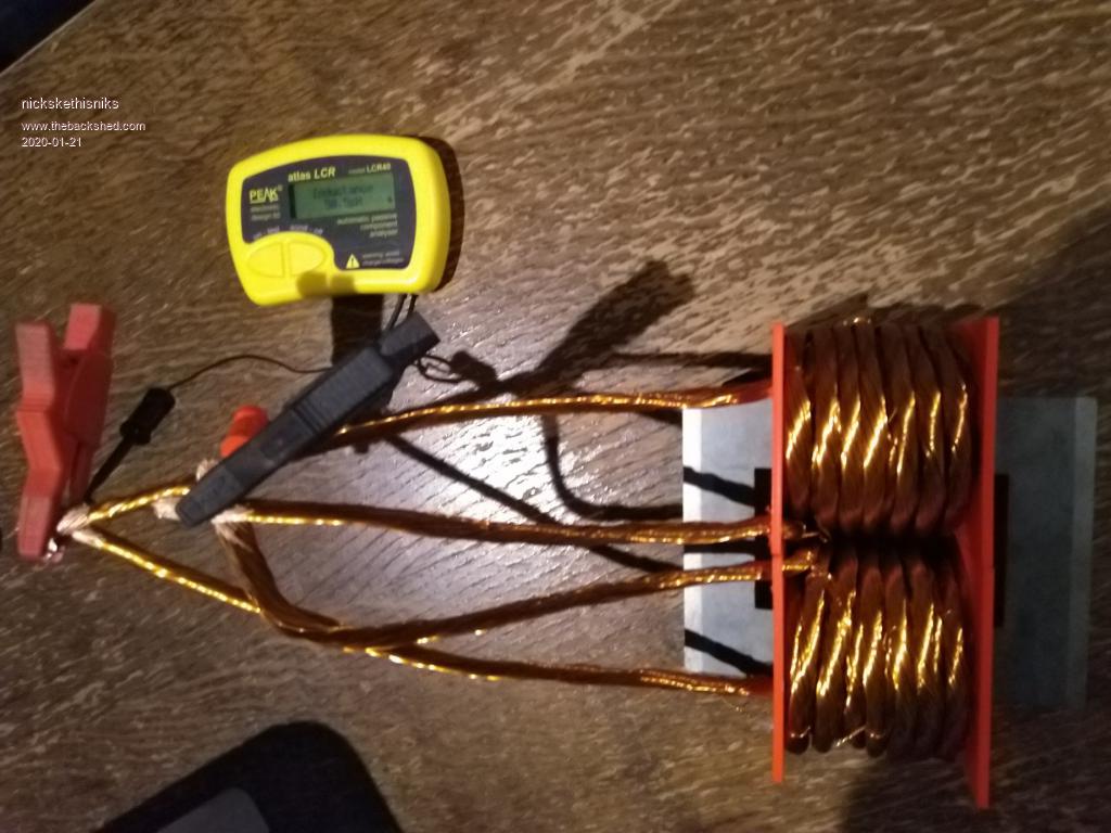

In the meanwhile I did the finetuning of the smaller transformer, just need to make an inductor saturation meter for making an apropriate inductor.
The next step was defining the number of windings in the bigger transformer before I start winding the massive wire.
I did testing with a flexible 10mm˛ wire, I need between 19 and 20 turns.
Testing results:
zero load 0,37A @ 49V output +- 18,1W I think I could improve this further with a better inductor better output filtering? I'm using 2uF output capacity.
21,3A * 49V 1043W --> output 973W --> 93,3%
44,2A * 47,3V 2090,66W --> output 1893W --> 90,5%

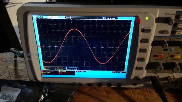

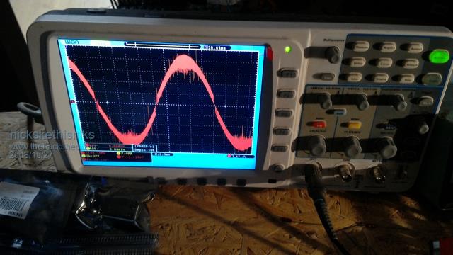

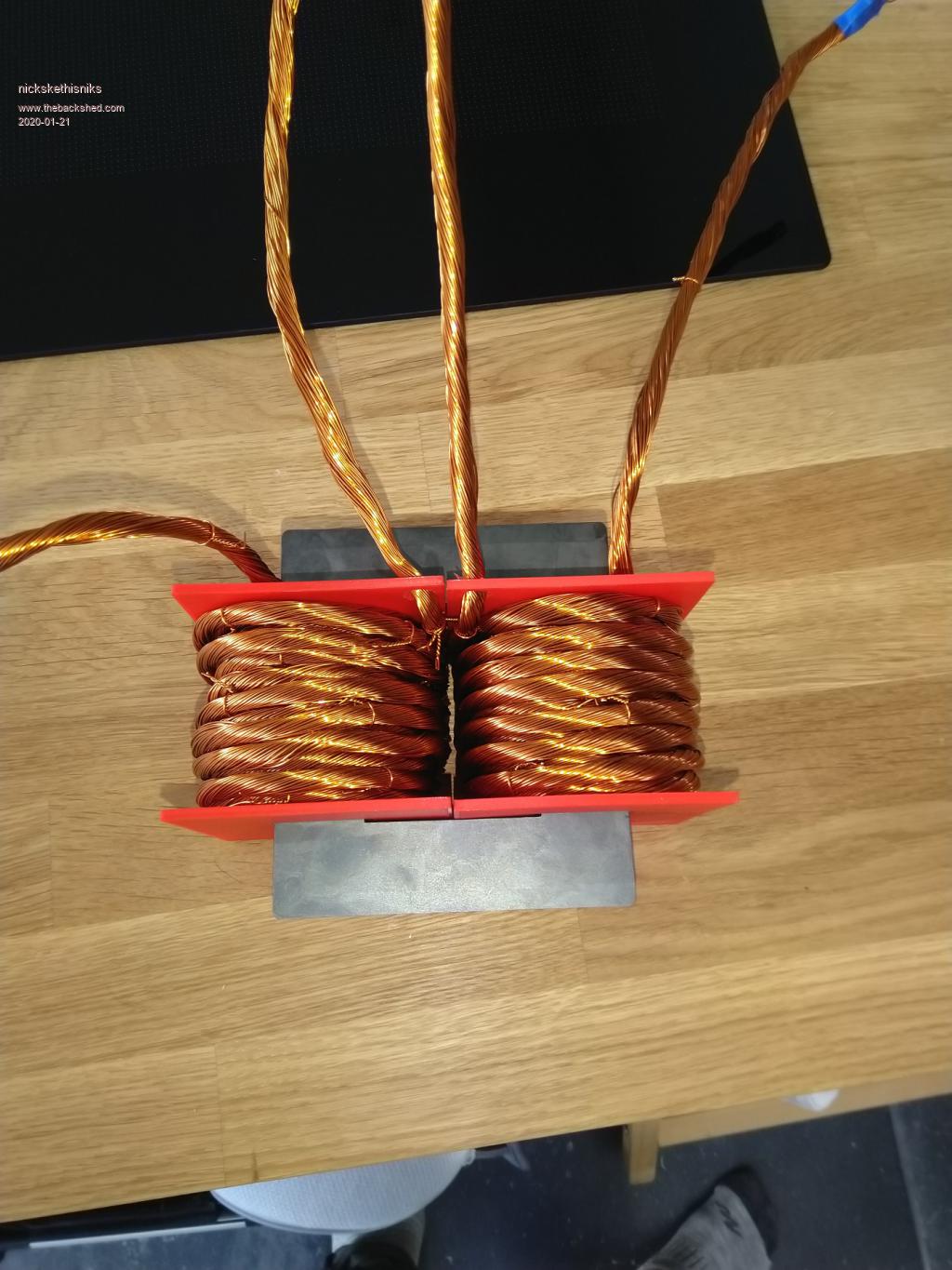

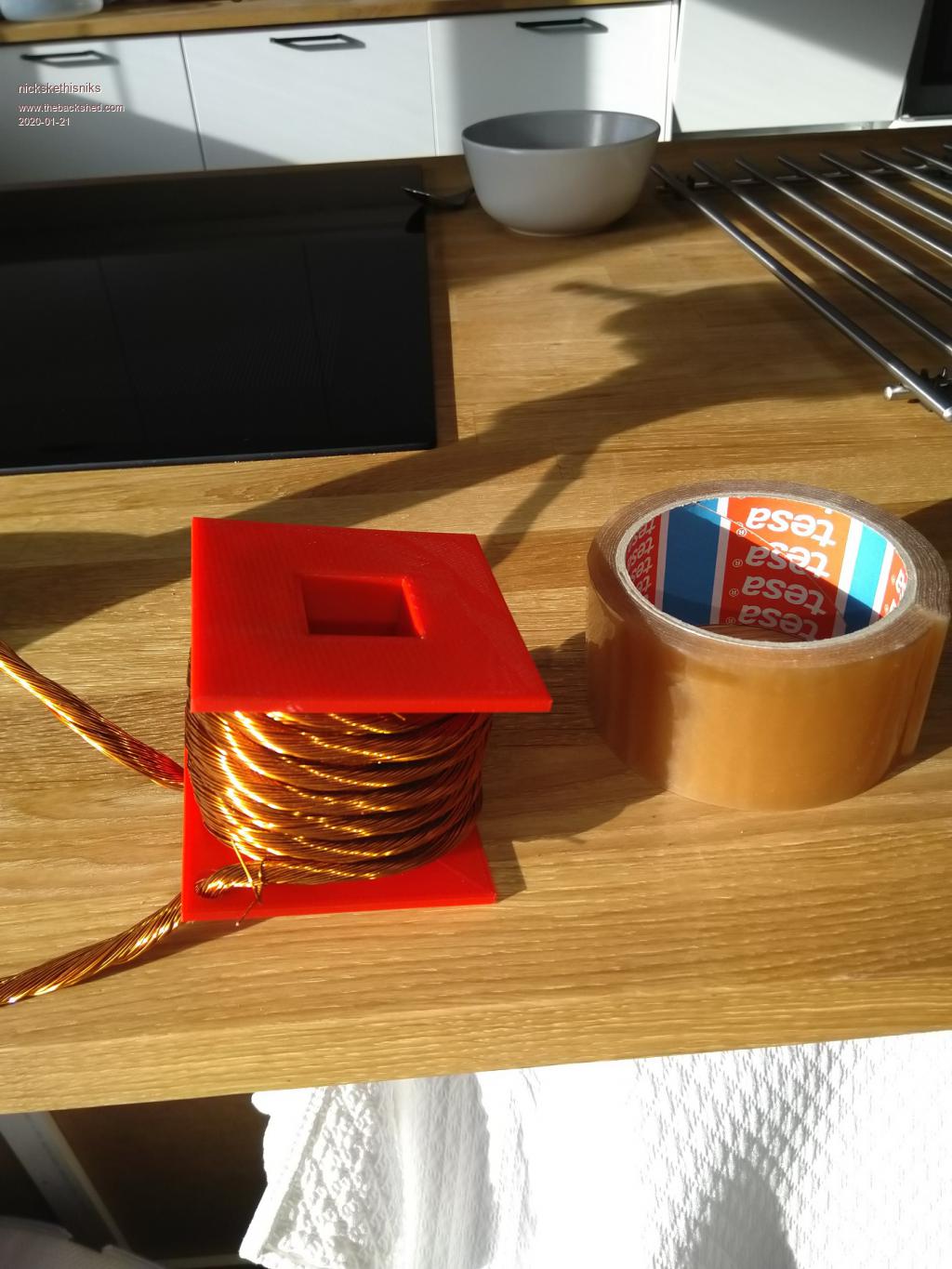

Hi nick, your numbers and waveform look great to me. In the picture, are you using a ferrite choke and an EI laminated choke in series?
nickskethisniks
Joined: 17/10/2017
Location: Belgium
Posts: 499
Posted: 08:10am 27 Oct 2018
Ok, I meant no load 18,1W with 230V output...
The other inductor is a ferrite with 213uH, and is rated at 40A I think, I was lucky to find it somewhere in a scrap container.
What I did noticed was that with the 213uH the output voltage was around 235V instead of the 230V with the 50uH choke.
I did not (yet) make a combination of the 2 choke's in series.
I think the higher inductance is making a nicer sinewave at the primary(48V), but I'm not sure because it could also be the hihger or lower saturation current...
I made some scoop images:
1000W load 50uH primary choke: ( primary 48V winding)
1000W load 213uH primary choke: ( primary 48V winding)
2000W load 50uH primary choke: ( primary 48V winding)
2000W load 213uH primary choke: ( primary 48V winding)
1000W load 50uH choke, 2uF output transformer
1000W load 213uH choke, 2uF output transformer
2000W load 50uH choke, 2uF output transformer
2000W load 213uH choke, 2uF output transformer

Can someone advice me about the EI laminated choke? I have EI steel from salvaged transformers/inductors. What I have is 35mm wide and 25mm wide (the midle leg), I can make it as wide as needed. What is the cross section I'm looking for, with the big transformer I'm looking for 9000VA nominal (1u use) and 20kVA peak. The smaller one needs to handle 2000VA and 4kVA peak
At the moment I have something put together with 35mm*90mm cross section, it's about 4Kg iron, I can increase that if needed. The iron came from 2salvaged 160VA transformers, but I have more... :).
Thanks!Edited by nickskethisniks 2018-10-29

Hello,
Another attempt in making a good sized inductor for my inverter. My current inductor has only that 10mm˛ wire and is on his last breath. They epoxy has a hard time when my wife find the power outlets. One time It got really smokey arround the inverter...
So I need advice, I have those really nice cores,
https://www.ferroxcube.com/upload/media/product/file/Pr_ds/U100_57_25.pdf
and a coworker of mine, made some coilformers with his 3D printer. So it let me make 2 bobins with each about 25 turns (not quite sure). Each with 60 strands of enamelled wire, good for 60A each. So should withstand 120A in parallel. As an aircoil they have 23.8uH each what I find quite high but that's what the lcr meter says.
So with the core (2 halves) in place it's about 375uH, with one half it's 30uh, I need to have an airgap around 15mm to get my 50uH. Before I solder lugs on it, would this kind of inductor work?
I joined the wires that way the 2 bobbins are acting like one bobbin.
It's the airgap that troubles me, I'm not confident about that, isn't it to much. I know I could allways remove some turns, but I prefer not to do that. Than I will use it in another project, in my solar buck converter for example.
I have another set of coilformers and cores, so I could make more.
During previous testing it was 50uH that worked best, 200uH gave to much distorted wave forms. So I'm aiming for 50uH.
So would this type of inductor "setup" work or do I look for something else? I'm not looking for high saturation
Here some pictures:
Edited 2020-01-21 06:54 by nickskethisniks
