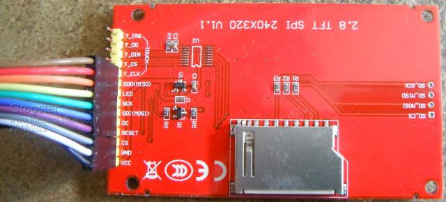

My display looks similar to that photo with transistor in same position and it works fine with MM BP V2. Unless you are suggesting his one has developed a fault for some reason.

  Azure said   Unless you are suggesting his one has developed a fault for some reason.
There are two common types of TFT 'out there' - one with a single transistor (as in this case), and the other type has two transistors.
The single transistor type TFT module seems to run warmer than the other type; and I believe this transistor drives the BackLight (I may be wrong - not got a TFT module next to me at moment to check). It could have a dry joint and I was going to recommend running an iron over the three pads. However, that said; the mention of a 'burnt smell' is worrying - so looking for the component most likely to have failed.
Unlikely to be any damage to the BP - but then why would the backlight suddenly fail

I just checked the display I have with me at the moment, it is labelled the same "2.8 ... V1.1".
My one does have 2 transistors. I try and rummage through the others when I can get access tonight.
Posts: 10114
Posted: 04:14am 22 Feb 2018
Very odd.
Can we assume that this is your LCD display:
I would be wanting to DISCONNECT the LED line at this point, and then connect it directly to 5v via a resistor - 100 ohms will do for now.
Run your GUI TEST LCD DISPLAY command, and leave it running.
Change the value of the resistor on the LED line up and down, but don't go below about 33R or you might hurt the backlight. The more resistance you put in series with the LED line, the dimmer the display should get.
What this test does, is just remove the PWM drive from the LED line totally, so you can see what's going on there.
Personally, I suspect that the PWM output signal from the MM's BACKLIGHT command, is not working - although you say it does, so something does not make sense here....
I don't suppose you happen to have a logic analyser do you?
EDIT: My photo shows that U2 - the XPT2046 touch controller chip - is not installed, so you can ignore that fact. We're only interested in the LCD and it's backlight for the moment. Edited by Grogster 2018-02-23

@Grogster
That is the same the LCD I have with me at the moment (working on location).
His panel only has 1 transistor.
I agree with your suggestions and also that something does not make sense.
Seems like an LCD Anode or GND connection issue.
What is confusing is that the LCD Backlight is a backlight to the LCD Display panel. So the brighter the LCD Backlight the brighter the display should be.
