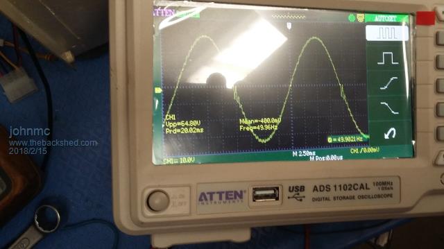

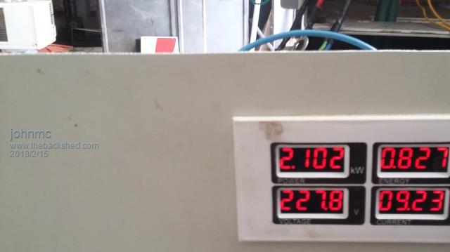

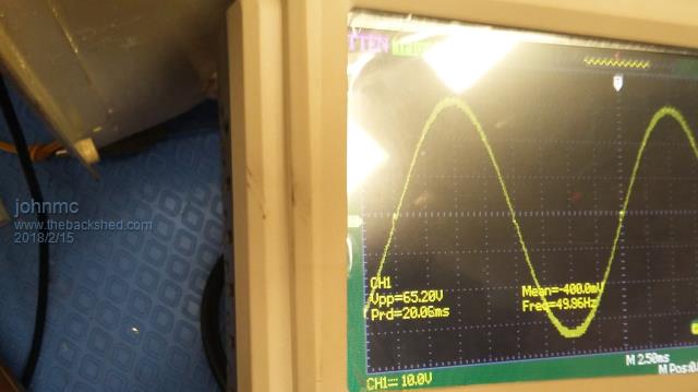

Good day Madness,
Thanks for the information, I fitted all the 6 * 10000uf main capacitors and also the 4.7uF poly cap had trouble starting inverter after charging the main capacitors through a 100 ohm sesistor.
Disconnected the 48v supply then discharged the main capacitors,then switched the inverter on at the control board , zapped the 48v on to the inverter supply
Now the control board soft starts with the on switch or with the reset button
the no load shape of the sine wave.
the wave shape with a 500 watt or a 2kw load
voltage and load for above picture
I have learnt that with no main capacitors there is still a sine wave when the inverter is just starting to raise the transformer voltage, then the sine wave
develops triangle peaks also blows the 4.7uF poly.
When the main capacitors are fitted, this causes the wave form to be corrected as per the pictures

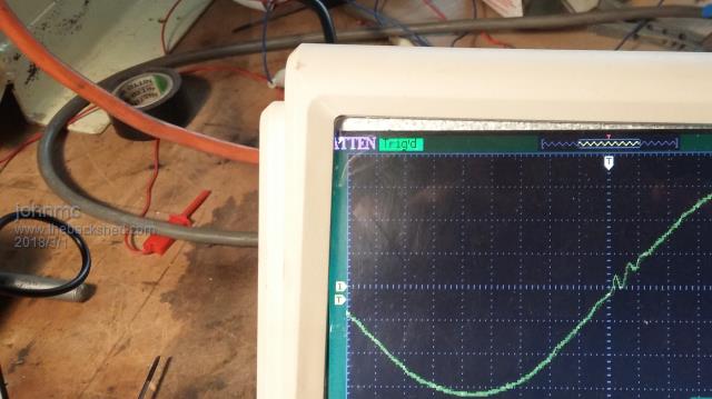

Posted: 10:59am 01 Mar 2018
Good day all
Rebuilt the ozinverter from the last blow up with 24 fets (slow learner) .
With no large capacitors the system started sine wave had a very slight ripple at the zero cross over point and only the common heat sink slightly warm.
Replaced the capacitors, charged the capacitors slowly system started no noise
from the system but the sine wave had a marked oscillation at the zero as per the photo
Stopped and started the inverter a few times then
As I started the final time the 8010 gave two blinks and 24 fets died with a load bang .
As Maddnes ,Tinker and others have found, they need totem pole drives, as the 2110 by themselves are not up to the task.
Waiting for some transistors and will have to make some driver boards.
PS still have 40 of the original 100 HY4008 FETS
cheers john

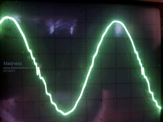

Posted: 11:16am 01 Mar 2018
Get it working with just 4 FETs and add from there, 16 in total will still give you 5-6KW, I run a total of 12 in one Inverter and it will produce 4.5 KW happily until the Toroid warms up.
The squiggle at zero crossing is most likely a choke issue.
This is one of the more subdued results I got before adding Totem Pole Drivers.

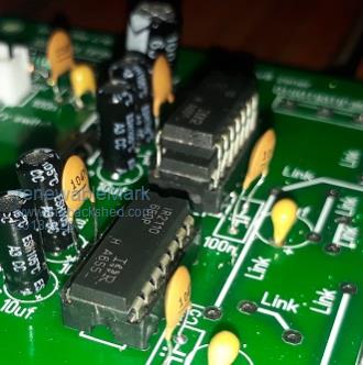

renewableMark
Joined: 09/12/2017
Posts: 1679
Posted: 02:26am 02 Mar 2018
Where are your 2110 chips from John?
Cheers Caveman Mark
