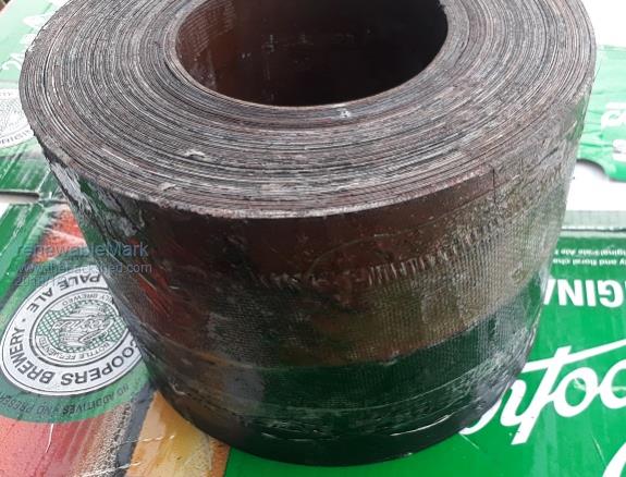

Had to work today, so not much progress.
Just fibreglassed the two halves together.
With all the different builds and the different progressions of the builds, it's a tad confusing deciding on a number of turns.
Core thickness is 53mm, two high it's 140mm =7420 /2800=2.65
240/2.65=90 turns
Now why does that sound wrong?
Edited by renewableMark 2018-01-21
