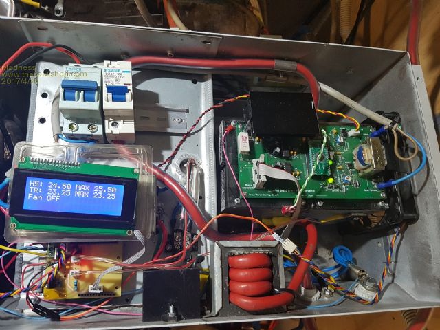

The small Inverter I have been working on is not quite complete but it is fully functional now. It has a single core from a 3KW Aero-sharp and the power board has just 12 4110 MOSFETs. I just need to tidy up the wiring and make a lid for it.

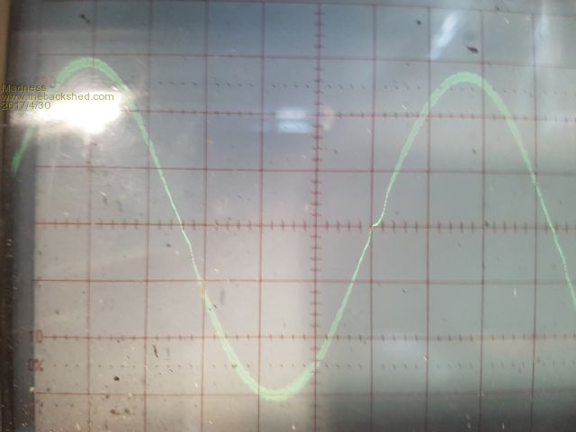

This is the waveform with 2.4KW fan heater, I have a 5uf cap from an Aero-sharp across the secondary.

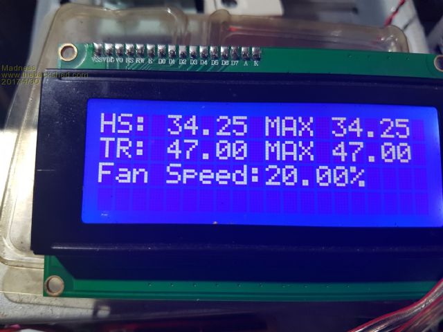

Here is the insides of it and the Arduino fan controller I just made. If anyone thinks this is overkill keep in mind it will always show what the maximum temperatures have been, I think it is worth to have that information.

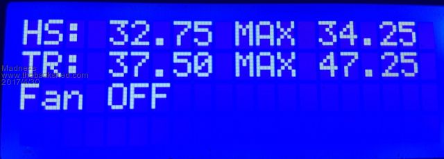

The fan controller displays the current temperature and the highest temp since it was last reset. It is programmed to turn on fans at 45 degrees with PWM minimum set to 15%, so at 45 the fans turn on and stay at 15% until the temperature gets above 46.5 then increases by 10 times the increase in degrees up to 55.
here is how it goes
44.75 off
45 15%
46.5 15%
46.75 16.5%
47 17% etc
55 100%
There is a sensor on both the heatsink and the Toroid, however, the heatsink is much cooler.
Today we had a cool 24 degrees ambient temp so it took 17 minutes from a cold start to get up to the point where the fans started with the fan heater load.
Here is the Arduino code if anyone is interested.

oztules
Joined: 26/07/2007
Posts: 1686
Posted: 11:52pm 29 Apr 2017

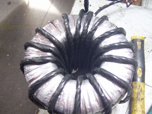

That little unit will power most small to med off grid houses without air conditioning. It is not a toy... I like it.
My new boards are on their way from China, so should be here in the next week or so.
They will use 4 x hy4008, and coupled with a decent tranny will power the house just fine and easy.
The control board will have the current limiter on board, and they will do 20kw surges without a problem.... thats enough for me now.
I don't really like the algorithm for your fan..... as I don't see why you would let the thing get any where near 55c if you can avoid it.
I would prefer to have a tight ramp... depending on your weather I guess, but i won't let mine get over 40c if possible. I will start the comparator at 35c, and it will virtually never get to 45.
I don't take a lot of notice of transformer temp, particularly now i am following your lead with the enamel primary. I use the heat sink temp to drive both fans. The heat sink is easy to keep cool, the tranny not so easy, but not important... I want cold capacitors if at all possible, and cold fets if I can... the big tranny will look after itself.... probably up to 55c in heavy long use.
The tranny is in a separate compartment, so does not contribute it's heat profile to the power electronics.
Looking forward to your using this thing in the field to see how well it performs.
........oztules

Posted: 01:09am 30 Apr 2017
It is very easy to shift the temperature settings, from what I have seen toroids are supposed to good for up to 100 degrees in most cases, some to 130. The heatsinks are quite a bit bigger than what you use also so they do stay quite cool. The temperatures on the LCD show HS for heatsink as you no doubt guessed anyway, so far the HS has stayed at least 10 degrees cooler anyway. I could stick a sensor on one of the caps to see what is going on there. I will try setting it to start at 35 and get to 100% at 40. The 140mm fans I have shift a lot of air even at 50% PWM, even 15% gives a good breeze. There is Arduino software now that runs on my phone so I can use it to reprogramme it off the phone.
You live in an ice box, this last summer here it would have been running all day long blowing 35+ degree air through it before trying to cool down anything. I know you are not a fan of them but the Midnite CC's I have run at 55 degrees, anything under that and the fans turn off. It is extremely rare to hear of anybody having failures with them and when they do it usually lightning or something external that causes it.

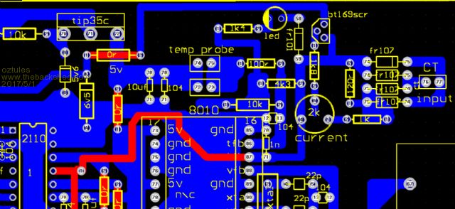

Are you planning to post your circuit with the new over current shutdown?

Posted: 06:07am 30 Apr 2017
It takes no effort to keep the heat sinks at 45c, rather than a minimum of 55c... note this from https://en.wikipedia.org/wiki/Electrolytic_capacitor#Lifetime
"This rule is also known as Arrhenius rule. It characterizes the change of thermic reaction speed. For every 10 °C lower temperature the evaporation is reduced by half. That means for every 10 °C lower temperature the lifetime of capacitors doubles. If a lifetime specification of an electrolytic capacitor is, for example, 2000 h/105 °C, the capacitor's lifetime at 45 °C can be ”calculated” as 128,000 hours—that is roughly 15 years—by using the 10-degrees-rule."
So, midnight can do what they want, but I would prefer to err on the side of cool.... as it does not seem to hurt to have the fans running at very low speeds most of the time to achieve this.... so the simple act of using 35c cooling quadruples the lifetime of the caps... in other words crap caps at 35c will probably outlast good caps at 55c..... eg 7 years to 30 years... so why not?
Yes if the boards work as expected, it will all be published.... the boards that is... don't do circuits

Posted: 01:59pm 30 Apr 2017
I have set it now to start at 35 degrees full speed at 35, I will see how that goes.
if(FANtemp <30 )
analogWrite(10,0);
lcd.print("Fan OFF ");
else if(FANtemp>=30)
fanpercent = (20*(FANtemp-30));
fanpercent = constrain(fanpercent, 5, 100);
fanpwm=((fanpercent*255)/100);
analogWrite(pwm, fanpwm);
lcd.print("Fan Speed:");
lcd.print(fanpercent);
lcd.print("%");
lcd.setCursor(0,3);

The previous post I should have said it starts at 30 and fans are at the maximum at 35. I am going to change this as the Toriod triggers it when the heatsinks are still well under 30. I am thinking I will change the code so it has different thresholds for the 2 sensors.

Mad, the current limiter that is shown on the schematics I posted a while ago works very well with the IR2110 drivers. It can be set to whatever surge limit one wants and turns off lightning fast if it is exceeded.
look here
I very much doubt that oztule's is much different. In any case, we could challenge him to say so if he does not do schematics.
Edited by Tinker 2017-05-02

Here is the relevant part of the board.... NOT tested until they turn up.
It is supposed to turn off the 2110 and the current pin of the 8010. This allows the use of all the led output signals that the 8010 does to the front panel.
Reset is done by shorting the 120r power resistor on the input... it does 2 things. First if your input voltage rises too slow, the 8010 locks up ... so it allows a hard fast reset, and you can also reset the o/current event. It is a a bit quicker than Tinkers as the damping is less.
I'm betting it works out of the box..... or I am in for some disappointment I guess
......oztules
Here are the gerbers for better definition perhaps
2017-05-01_120900_CAM_for_CONTROL.zipEdited by oztules 2017-05-02

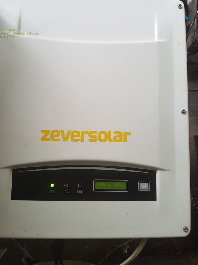

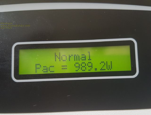

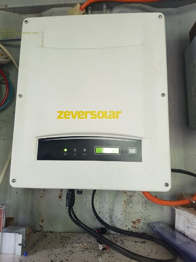

I have managed to get the Zeversolar 5KW TL5000 GTI operating with my OGI, before it was tripping the 20A breaker as soon as it tried to connect the AC, I tried it with a 63A breaker and it worked. This Inverter was a bargain from the local tip shop, cost me $5 looks brand new even came with the wall mount for it.
It is connected to a single bank of 1500W of panels here it is just after 9AM so power output is to be expected.
Next week I plan to setup the 5KW of 2 year old 250W panels I just bought for $700 with this GTI. I had considered doing it with DC but it involves a lot of wire, the GTI only needs two pairs of cable and has dual MPPT.

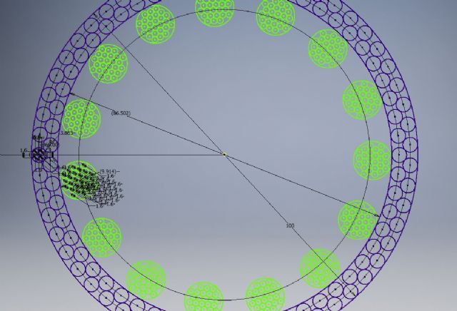

So I was unwinding my second 3kw Aerosharp toroid and was thinking..... Could we wind the secondary like this??
Line up give or take ~4x ~1.6mm dia enamel wires, wind it up into one cable.
Then
  Madness said
what I found helped a lot too is to wind it through the core into about a 600mm diameter coil and tie the turns together leaving the first couple turns free, then rotate it through as you go.
Maybe then epoxy and mylar tape around as you come around for the second or third pass.(or heat shrink it??)
I'm thinking this for primarily 2 or 3 stack cores??
Have i got unwinding delusion or is this a possibility?
Shane
Posted: 12:17am 07 May 2017
Then
Shane
IMO, the the secondary has too many turns for for this idea to work. You would need to twist wire some 40m long, a bit awkward. Then, you will take more core room to wind that bundle back on neatly, resulting in a smaller hole for the primary winding.
But you could do what I was doing, winding two in hand at once. You will need an about 600mm diameter 'reel' to store the wire side by side on while you wind two in hand at once.
I did describe that method in my toroid build somewhere.
Posted: 01:02am 07 May 2017
I tried the bike rim idea first off but quickly changed to using the small spool so you can unwind against the core. Keeping the wires parallel will save space. The secondary has much higher voltages, especially when you get near completion of the turns and are against the beginning so insulation is critical.
You could try a test of a few metres and see how it goes on. Twisting the length you need may be a handful to get that right.
Another thing to watch is if you can do it in one layer, twist a short length of the 3 or 4 wire together that you plan to use. Measure the diameter of the twisted wires and calculate the circumference of the inside of the core less the radius of your wire bundle. Just calculated it from when I did it with 75mm inner diameter and 98 turns that I used on a double core you would need to have your wire 2.4 mm in diameter to do it in one layer which just is not going to happen.
Mulver
Joined: 27/02/2017
Posts: 160

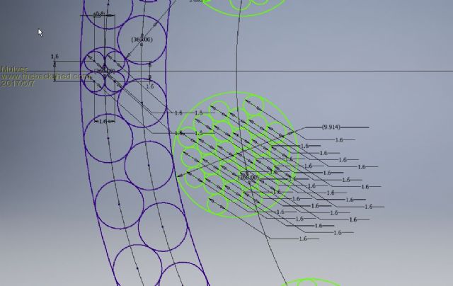

Posted: 01:26pm 07 May 2017
Just a quick mock up this morning, 2 stack toroid, 4 in hand (could be a handful) secondary, 114 turns (2 x 57) Primary 26 in hand, 16 turns.
Posted: 02:19pm 07 May 2017
Nice CAD work, what software do you use?
