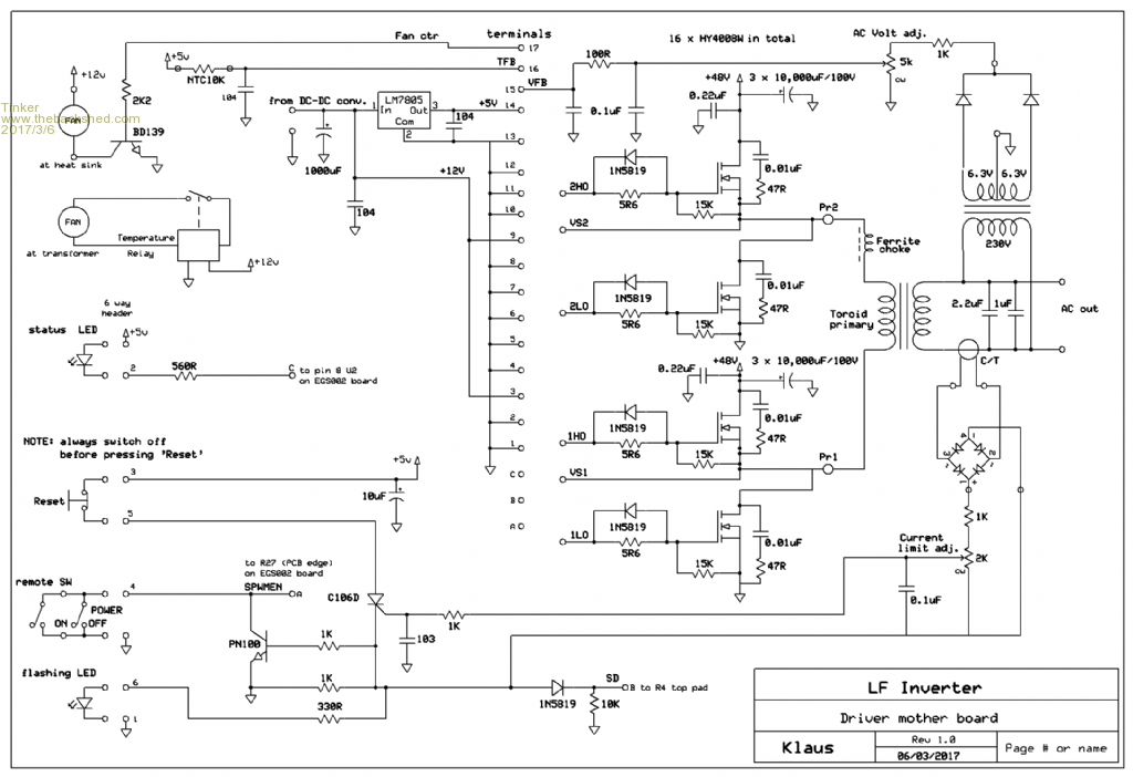

I made some more adjustments to the inverter control with regard to the VFB voltage source that is being discussed at present.
Here is the latest updated schematic:
Great work. I want to clone but also want to take it a step further by adding a microcontroller.
What should be added. I can immediatly think of external comms for sharing data about volts amps degC etc. What else do u think will be needed.
I will use EAGLE for the PCB.
azhaque.
Posted: 09:24pm 28 Mar 2017
If you are adding a microcontroller the only thing I would change on the circuit above is perhaps the means to turn it off if it gets too hot or battery voltage drops too low. Everything else should be independent of the Inverter circuit. You can sense temperature, current, volts and control fans with sensors that don't change the circuit above.
I have planned to do the same but have not got that far.

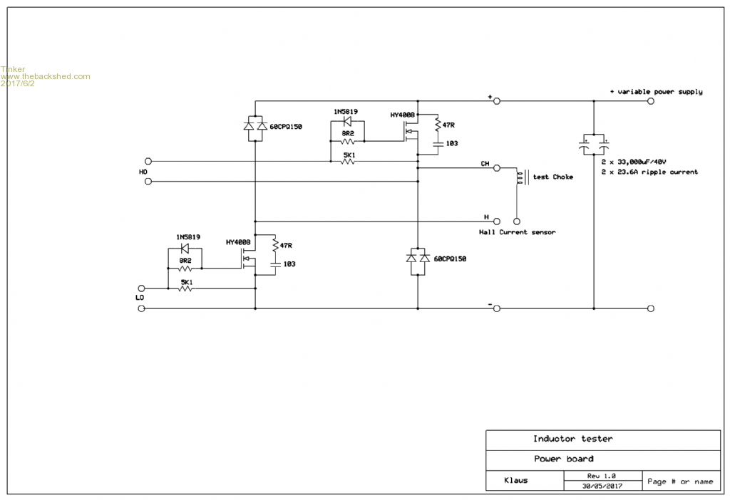

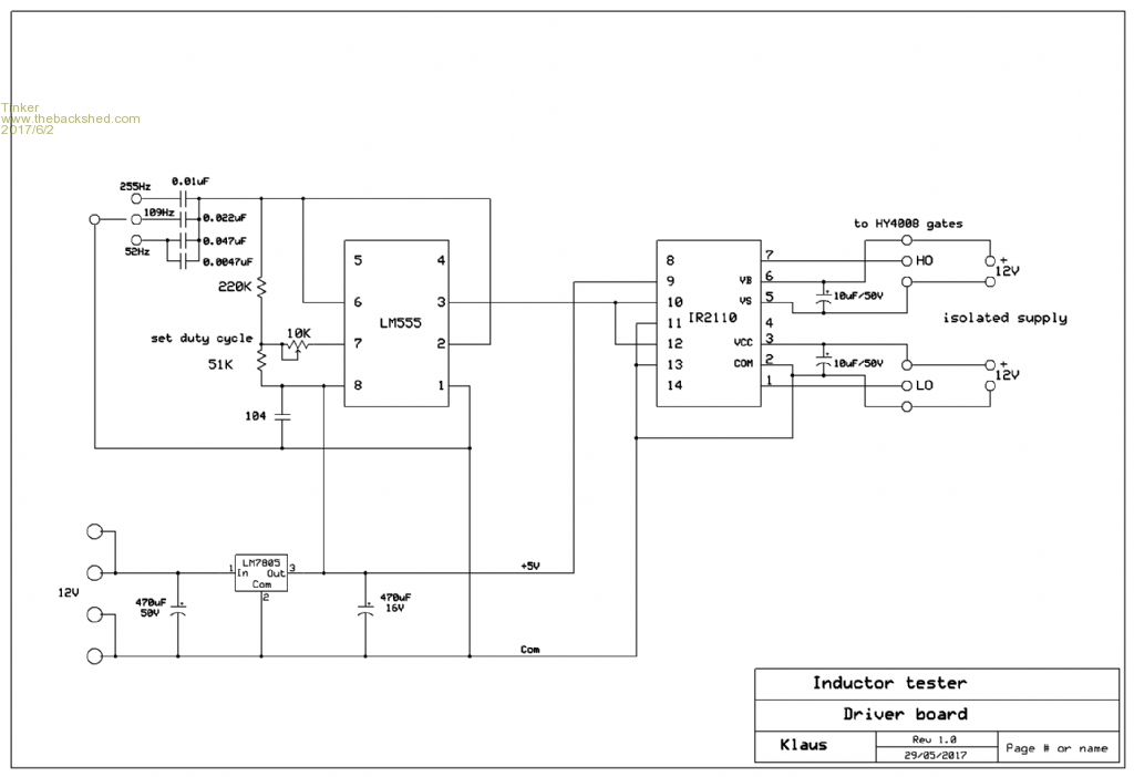

A little progress on my inductance saturation tester. The PCB's (2 off) are made but I'm still waiting for the power schottky diodes.
Here are the schematics, much simpler than Solar Mike's but then this is just a basic test unit.

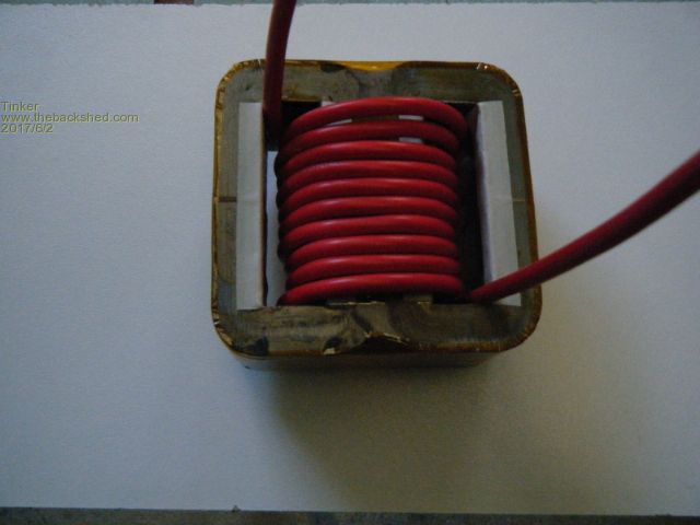

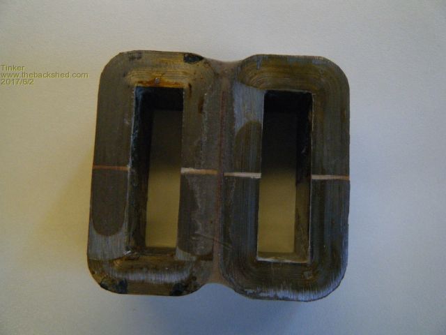

This is my test inductor core:
Its made by epoxying together two of the large inductor cores found in the 3KW Aerosharp inverter. I used 2mm thick plywood between the two cores. The air gaps are about 1.6mm.
10 turns of test coil wound on:
Hopefully I will soon find out at which AT that core saturates.
On another matter, while testing the gate pulse generating board I realised this also makes a neat way to test those IR2110's that experienced the magic smoke from the exploding mosfets. I had my fair share of that magic smoke and usually ditched the gate drivers as well since I did not know if they survived.
There were a few still on my bench and plugging them in, then shorting the gate drive with a 1K resistor (no mosfets), its easy to see on the scope if there is a neat square wave on the hi and lo side drive output or rubbish, as happens with a busted driver chip.

Yes, I did try oztules method of testing and it always seems to work well but the resistor limits any power drawn from the inverter. My problems started when I tried to draw more power.
I have made the boards for the TIP41/42 drivers but will first investigate a decent choke that does not get saturated when more than one light bulb is powered from the inverter.
If that cures the sine wave 'wiggles' then I think a working inverter follows.

Looking really good there with the choke Klaus.
Your saturation tester really needs to have a fairly widely adjustable frequency range with a fixed 50% duty cycle. Not sure why there are just three fairly close switched frequencies provided. Something like 20Hz to 10Khz continuously variable might be more like it.
If the "on" time ever exceeds 50% its going to go bang.
The current will ramp up fine, but will be unable to fully ramp down back to to zero because there might be insufficient time for it to do so.
The current will then quickly ratchet up a bit higher each cycle in an uncontrollable way until something fails.
A 555 is fine, but please use a divide by two flip flop on the output for safety.
Pin 4 of the 555 (reset) needs to be tied high.
The 4046 VCO solution is a lot nicer and uses no more parts.
Edited by Warpspeed 2017-06-03
Posted: 03:50am 02 Jun 2017
Thanks Tony, your input is, as always, very much appreciated.
Its just a simple 555 circuit I found on the net. I thought since the working frequency of the toroid is 50Hz the choke should be tested at the same??
Anyway, its a simple matter of putting smaller capacitors to raise the frequency but I'm curious why it should be continuously variable?
I did not know about the danger of the greater than 50% 'on' time. The circuit will easily adjust to a little less than 50%. Else a divide by 2 flip flop chip.
I did not have a 4046 phase locked loop nor am I familiar with this chip. Bu I can get one from Altronics and experiment. I'm sure Solar Mike does not mind me flattering him by copying his circuit.
Posted: 12:45pm 02 Jun 2017
I suggest you get the 4046, it already has the necessary flip flop inside, and its much easier to use for this than a 555 anyway.
For testing unknown chokes, or any chokes that can vary widely in size and inductance, we need a variable voltage source, and a continuously variable ramp up time.
A wild guess might place your new choke at roughly around 100uH (we shall see).
If so, it will ramp up at one amp for each applied volt over 100uS.
Maybe ramp up to 30 amps with 30 volts applied over a 100uS ramp up time.
That is just an example, 100uS up and 100uS down requires 5Khz.
If we wanted to ramp up to 90 amps it is going to take three times as long, say 1.67 Khz.
If we dropped the test voltage down to only five volts, it ramps six times slower than at thirty volts. So our 100uH choke requires 1.67Khz/6 = 278 Hz to reach 90 amps.
So you can see, depending on what you are testing, or how hard you wish to push it current wise, we might need a fairly wide choice of frequency. Its a lot easier to do if your voltage control knob and frequency control knob both cover a suitably wide range all in one continuous sweep.

The gate drive is a square wave, but when both mosfets turn on, the current through the choke ramps up.
When both mosfets are off the current (through the choke) ramps back down back through the diodes.
As long as we give it enough time to completely ramp back down to zero we are sweet, a 50/50% duty cycle always allows that with a bit to spare.
If we turn or mosfets back on too soon before the current has fallen completely down to zero, it again begins to ramp up BY THE SAME AMOUNT, and as we started off with something greater than zero it ramps up to a higher peak than it did the first time.
This keeps on going with each successive ramp up peaking higher and higher until something really bad happens. The current just runs away on you. So an adjustable duty cycle is a bit dangerous if it can be set to go over 50% on.
That is why the 555 could be a fearsome device.
With the 4046 we get a flip flop for free, and when we increase the on time, the off time also increases in direct proportion, so we need never worry about the runaway condition. Its one less thing to go wrong.
