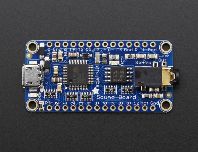

It was to use instead of switches on THIS
I could use control it through the serial port but I have no clue whatsoever how to convert Arduino code to Micromite code and the only example they give is Arduino

Posted: 06:51pm 04 Dec 2017
Yeah, thought so... when they say "GND" they mean "nominally GND" = as near as... we call it logic 0, the actual voltage is usually not important - the datasheet for that device will tell you what it considers as logic 0 in the same way as the PIC data sheet does, but I wouldn't worry about it... all the manufacturers tend to agree and make their stuff "nominally" in the same ball-park so their devices can all talk to each other - makes $$$ sense
So it looks like you need a lo on any of the 0-10 inputs for 125mS to start it:
"When the # pin is connected to GND for more than about 125 milliseconds it will trigger"
Micromite will drive this just fine. Each of the # pins has a 100K pull-up. If the amplifier board is being powered by more than 3.3V you will need to connect them to a 5V tolerant pin on the MM or with a 1K or 1.5K series resistor to any other pin.
But other than that there is nothing to stop you driving this from a MM - Arduino code has nothing to do with it.
for each pin you need this set up:
PIN(x)=1
SETPIN x,DOUT,OC ' need this open collector makes the PIC pull lo but not drive hi
then to trigger each pin:
PULSE x,125 ' read the pulse command - page 67 of the MMBasic manual
or if you don't like that
PIN(x)=0
PAUSE 125
PIN(x)=1
same thing.
Edited by CaptainBoing 2017-12-06

The one I have must be faulty, it wont work
Works fine on the computer to load and play files, but wont play grounding any of the pins, through the MM or manually
Posted: 07:05pm 04 Dec 2017
What are you feeding the output sound into? does that work with another sound source?
What are the filenames you used? It wants names following a specific format - start with "T" then have two digits following.
so "T00FRED.wav" is OK, but "FRED.wav" is not
the xx is the associated pin number.
Also if the files are .ogg, you need at least 200mS low on the pin (not 125ms)Edited by CaptainBoing 2017-12-06

T01.wav, T02.wav and so on
I even downloaded their example sound file to double check and use that to test
Edited by lew247 2017-12-06

I've ordered a new module, seems like the one I have is faulty

You cannot run the module if the USB port is connected to a computer. The unit must be powered from a power module only or via the power pins to be in GPIO mode (run using the play inputs).
