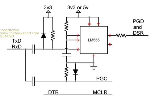

here goes a more complete schematic of what i was talking about earlier:
with the comm port set to 1Mbps, 8 bits, no parity:
1. transmitting chr$(0) should create a 9uS negative-going pulse at TxD and cause a '0' to be clocked out to PGD;
2. transmitting chr$255) should create a 1uS negative-going pulse at TxD, causing a '1' to be clocked out to PGD.
by counting in the character echoed back on RxD, when it is desired to read back from PGD a program just has to pause until count out = count in (ie, for all Tx buffers to empty out), then read back PGD using the DSR input. DTR is used to handle driving the MCLR line as before.
how it works:
TxD idles at '1', and goes to '0' at the start of transmission. how long it stays low depends on the character being trasmitted: 10uS for all zero bits, only 1uS for all one bits (chr$255).
the falling edge passes through the top RC/diode network creating a short pulse. this initiates a 5mS high-going pulse at pin 3 of the LM555. this output is fed into PGD via a 3k3 ressitor so causing PGD to be set to '1' for the first 5uS after TxD goes low, then back to '0' thereafter.
if TxD goes high after 1uS, this rising edge creates a short pulse (via the lower RC/diode network) at PGC. the pulse then clocks in the '1' on PGD. if TxD instead doesn't go high until after 9uS, the clock pulse occurs well after the monostable has reset, and a '0' will be clocked into PGD.
in theory, and assuming that PGD needs to be read back infrequently, this should allow a sustained throughput of around 100,000 PGD bits per second.
i'd be keen for someone to have a play with this circuit. i'd also be interested if anyone using John's software could attach a piezo sounder to PGC and report back what they hear during programming using the FT232R/resistor solution. this will give an idea of what the achieved bitrate is.
rob :-)Edited by robert.rozee 2014-09-02
