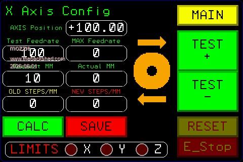

G'day Bryan,
No worries there, this is your project after all. To keep it moving forward Claude is probably a good move, as I stated, I have a million projects and work gets in the way of all of them, if you wait for me it'll be a long road indeed.
Maybe see how you go with Claude and I will try to help where needed, and I will continue to work on my version, we may be able to blend them together at the end.
On that subject, I have been working away in the background on the original code when time allows, this is to add an axis setup page and an axis homing page. This means you home the machine on power up and then it doesn't matter if its moved since the last job, so no need to store positions. Only the Z-axis is causing me problems, a homing switch would not be accurate enough.
Axis Config Page:
The other problem is I'm trying to make the code work for any CNC so it all takes a lot more thinking about, but I love a challenge.
Regards, Lyle.

Touchscreens (also the small ones) tend to get very smudged by oily hands on CNC's. I don't know why...
And they become hardly readable. Maybe you should avoid small fonts, and dark colors (single pixel dark green/red on black). The big buttons are fine. The E-STOP should be a hardware button (touch is not reliable enough to save lives/hands/fingers).
Those are my 5 cents.
Posts: 9328
Posted: 02:57pm 01 Jun 2026
Agreed. There may not be a display (or even a Pico) when an ESIOP is needed. Also, you may not be adjacent to the control panel, you (or a potential rescuer) may be closer to the door attempting to avoid shrapnel. That's what ESTOP loops are for. I even put a latching button right by the door in my shed to kill all the supplies.

Posted: 03:17pm 01 Jun 2026
G'day,
Motorcycle visor "Tear-offs" are a great way to stop the magical ingredients in cutting fluid destroying the touch screen, also have some capacitive versions to try
These 4" displays are a nice compromise, larger would be better but the config screen shown is rarely used and the main screens have the larger buttons.
The "E-Stop" is just an indicator for the wired E-Stop system, hence the reason it is shown disabled, the loop is intact.
The "RESET" does as its name suggests once the system is in a suitable state.
Regards, Lyle.
