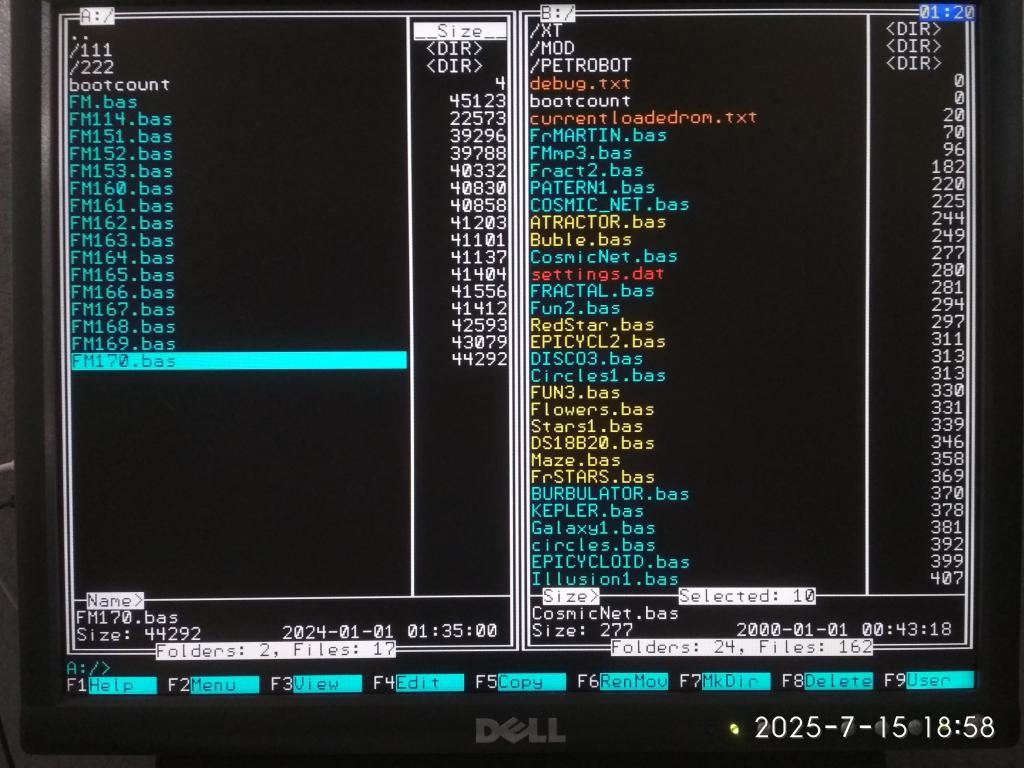

  javavi said  FM v.1.69 For testing!
+ A bunch of minor edits
+ Added display of file sizes on panels
Copying a directory with F5 and move/rename with F6 are buggy. F5 dir copy does not return to the FM but the copy is done. F6 shows a blank page in serial console and nothing happens on local screen.
Left panel does not show a column for file size.
Tested with resolutions 848 and 1280
I cannot see a usecase for the command line, as it does not return to the FM.
What do you use it for?
Edited 2025-07-16 02:29 by dddns

  dddns said  Copying a directory with F5 and move/rename with F6 are buggy. F5 dir copy does not return to the FM but the copy is done. F6 shows a blank page in serial console and nothing happens on local screen.
Just checked on 640x480 everything works.
These are hardware failures of the hardware or MMBASIC system due to overclocking, test on lower resolutions...
I noticed that on high resolutions failures happen often!
  dddns said  Right panel does not show a column for file size.
Wait a second, Coming soon...
But you can also enable it in the program.
  dddns said  I cannot see a usecase for the command line, as it does not return to the FM. What do you use it for?
For example, while in FM, you can type an option or a command and it will be executed upon exiting FM... That's how I save.))

The long-awaited release of File Manager v1.70 from Javavi
FM170.zip
+ Support for all resolutions
+ Switchable panel view (simple wide, with sizes)
+ Added function to search for one file from the current directory.
etc...

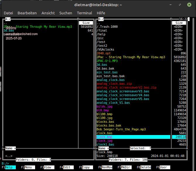

  dddns said  quick&dirty just commented out and defined colours by hand real quick, it runs on a RP2040 and a 7inch LCD ..very nice!
It works in full extent! It works perfect with FONT 1 and 4, all other fonts work as well only the frame is missing. Colours and inverted text work fine as in HDMI. My resolution is 800x480. Your new scaling is solid!
The processing speed is at least as fast as on HDMI and 2350. Very usable!
It looks very nice on a LCD! Pictures are shown in true colour :)

Hello Javavi,
I'm sure, you remember the wonderful set of subroutines replacing print@ provided by @matherp here
I _only_ replaced all COLOR commands by calling this subroutine:
Sub setcolour f%, b% ' set the colour of both the screen and the console
Local integer fr=f%>>16,br=b%>>16,fg=(f%>>8) And &HFF,bg=(b%>>8) And &HFF,fb=f% And &HFF,bb=b% And &HFF
Option console serial
Print Chr$(27)+"[38;2;"+Str$(fr)+";"+Str$(fg)+";"+Str$(fb)+"m";
Print Chr$(27)+"[48;2;"+Str$(br)+";"+Str$(bg)+";"+Str$(bb)+"m";
Option console both
Colour f%,b%
End Sub
It was not more than find&replace and took 15min..:
So I can say, that it runs for me on every platform ..very very nice!
