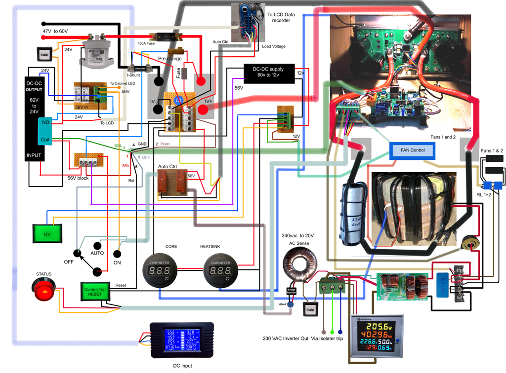

Spent a bit of time over the past week making up a picture wiring and large component layout, the area on the left is pretty close to the Top control interface deck in the Inverter housing, it really makes finding where a terminal goes so easy in the future, anyway I like it, I've made these in the past and really glad I did as the memory gets a bit hazy over time when you want to repair or modify something.

Good ramble though,  I totally agree with it, Its always good to read a build thread and all the experiences along the way good or bad, it helps others to see if they are on the right track when making there own.
The basic designs work, its the variables (parts) we throw into the mix that make it unique.
I like your pictorial diagram, I recently tried to make one for a friend doing an off grid solar setup, used pictures from the net but it was not quite what I liked, should have took some photos, cropped and drawn it up.
Need to learn how to use a photo editor and drawing program.

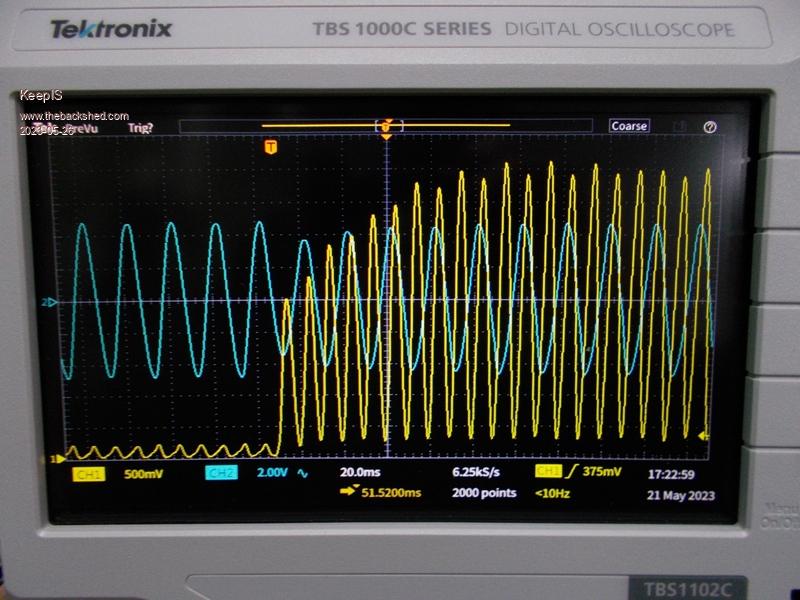

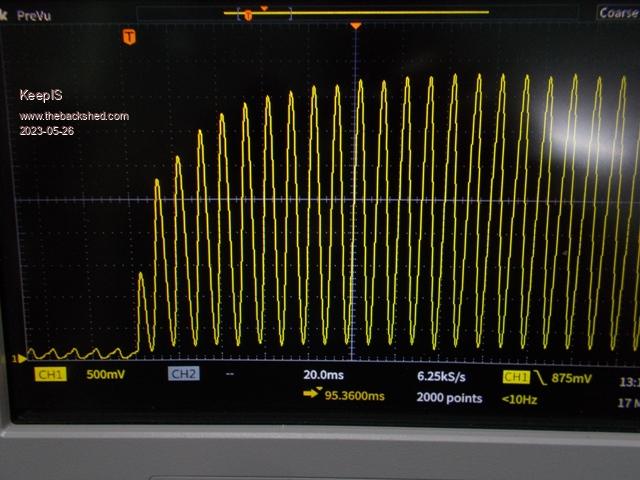

I was going over the peak DC input current testing I did the other day, I noticed something interesting when comparing the recordings of two chokes compared to one choke:
One Choke: Notice the different peak current in each cycle of DC current [Yellow Trace]
The inverter is drawing slightly more current producing one half of the AC cycle  compared to the other, this is likely due to having only one choke in one side.
The smooth ramp up in current to 520A is likely due to the 10 Stack toriod choke and it not saturating even at 520A, it still has some inductance past 600A.
There is also more current being drawn over the first few cycles with only one choke,  there is now half the inductance and some winding resistance (R-LOSS) removed for good measure.
Below - Two Chokes: A small amount of variation, the Hybrid choke E-Core is totally saturated past 100A and the 16uH Toriod ring choke is close to full saturation, there is less initial startup current for the first few cycles, more initial inductance of two chokes and some extra R-Loss thrown are the reasons.
I need to test this correctly when I split the 10 stack choke into one half in each leg. I have decided to use 7 cores in each half, I can use a turn or two less and have slightly higher saturation as well, meaning a little more inductance in reserve at 520A "plus" current peaks.

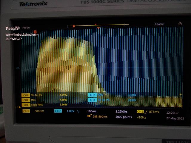

Wound two chokes, each a 7 stack comprising 5 x black and 2 x blue toriod rings each, it's what I had, there is not a lot of difference between the T-rings.
Still same 4 turns each, that's all that will fit, 6 cores got me 23uH instead of 16uH for 4 cores:
Inductance is 23uH each, both measured identical of course.
The saturation of one could be enough, but the two combined are passable I guess.
BOTH images are for only ONE choke.
The HF noise reduction with wiseguys design was the first thing I noticed when I swapped the inverter boards over from the China board, it was virtually silent across the band. Nothing else was changed when the boards were swapped.
Running with only one choke bought it back to a similar noise level as the China board. After splitting the 37uH choke into two x 23 uH chokes, it was almost silent again, just needed two RF toriods rings over the AC feeds from the transformer to remove one or two slight birdies on the band.
Started every load and now have some DSO captures to go over.
Edited 2023-05-27 14:52 by KeepIS

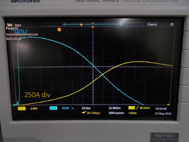

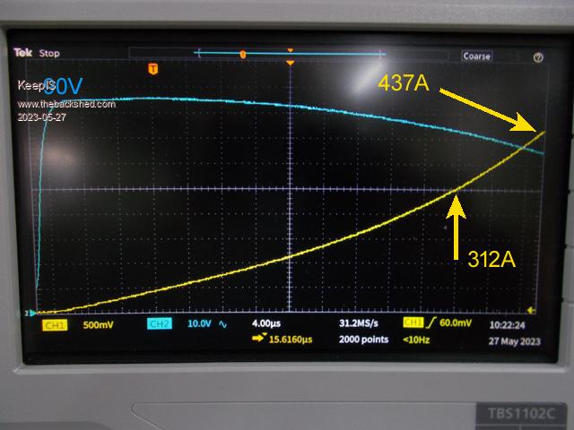

I'm not going to go over again why the chokes stay cool with the cable used, or why I use that cable, one obvious reason and one personal belief reason, So:
1: The chokes are wound with 4G cable.
The current is definitely higher again now, possibly in part due to:
A: The total cable used has been halved since remaking the chokes, less R-Loss.
B:The interplay of lower inductance chokes on each side, however, combined, a higher inductance by an extra 9uH compared to the single 37uH choke used on one side.
Current peaks measured from the base dc offset to the Peak DC current swing is now reaching 568A [26.7kW DC peaks] Measured a few times to confirm and its always the same.
The 1st cycle startup surge is now between 300A and 404A peak, depends on where in the AC cycle that the Compressor takes a dump on the inverter.
Nearly 400ms of huge startup surge before it starts to taper off.
Yellow is Current, Blue AC.
Below: 1st cycle at 404A peak.
The startup AC waveform varies depending where in the cycle it's forced to take the load. VFB in the mix as well?

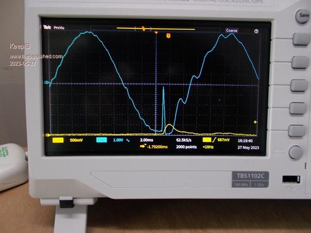

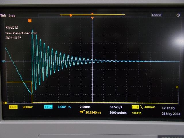

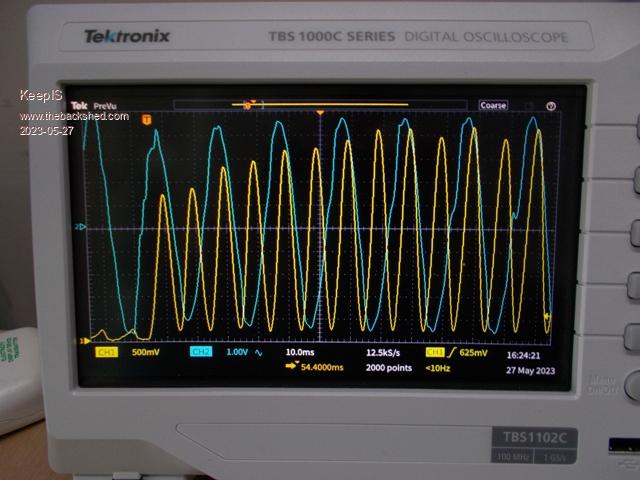

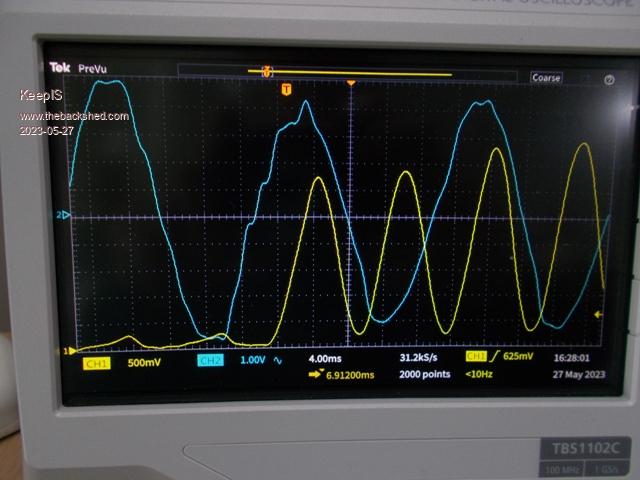

Mike, I thought you may be interested in these. Its the ATS switching the LOADS over to the Inverter, that's a 62A peak DC pulse, not much but obviously the change over is not synced so anything could happen playing Russian roulette, but no blowups with the inverter, Toriod doesn't even grunt at me. Seems like the AC distortion is not causing any real current or instability issues with the toriod or inverter, switched loads don't seem to care much.
EDIT: You know, that AC spike and ripples on the following leading slope look like the result of a brief muted ringing in the toriod.
Below: Inverter Halt [off]. Triggered by SPWMEN enable disable. Wondering if I should fit the all the extra diodes across the FETS, just in case.
For someone new, Blue is Inverter AC out and Yellow is the trigger point on the SPWMEN line to the 8010 when the drive waveforms are disabled at power off.
Edited 2023-05-27 18:06 by KeepIS
The chokes each side should be considered as 1 choke, it is a series circuit and the current through any part of the series circuit will be the same at any given time. The only advantage I saw for splitting the choke was for symmetry when looking at transformer primaries with a CRO and reduction of fast switching edges applied to the transformer so less coupled noise.
The current peaks being higher on one side should have zero to do with the choke being on one side. When compared to normal 240V behaviour with regard to current peaks are they identical ? Have you put a heap of resistive loads (all stove elements turned on) for comparison of the current peaks too?
If the symmetry issue of current peaks is definitely caused by the inverter my guess would be possibly the dead time capacitors across the LED's of the opto coupler drivers not being matched for each side drive. If there was unequal dead time that could rob one side of energy throughput for the side with the greater dead time, another possible reason is slight asymmetry of the EG8010 output waveforms for each half.
Last comment, is it possible that increasing the inductance from 37uH to 46uH has slightly reduced the efficiency at high loads resulting in higher current required to start the same load ? I only ask these questions and make these comments in the interests of being as nice to the inverter as we can be.
Cheers Mike
