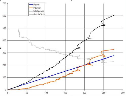

I have prepared a graph of the relative contributions to the output power from Caps in a voltage doubler arrangement.
I have plotted the total power, series caps, cap voltage doubler and relative cap doubler contribution.
The scales are 1.3 times the actual power.
At low power levels, the significant power comes from the cap doubler. As the power levels increases to 200, the relative contributions are the same. As the power levels increase further, the doubler plays less a role.
This is a seamless process without any switches.
The graph is showing that I can increase the series caps still some more, as the loading is still not quite enough at higher power levels.
Gordon.

Please tell me what are the best value for the caps and what schematics to use, a voltage doubler or a series caps for a LG direct drive motor wich is corespondent of F&P and with a chinese Ax mill. Both are used with 12v configuration and need some solution to put some Amps in the batteries at 4~5 m/s wind speed.
Thx.
Alin
Posted: 11:40pm 27 Aug 2009
12V systems require large caps and the diode losses negate effectiveness of the capacitor voltage doubler.
My systems are 24V & 48V loading. You need to provide operating AC Hz at operating rpm, and windmill power outputs.
All of my cap systems are empirically determined. Chances are that you will need to do the same. I can only give an estimate, given that I don't have an LG windmill or an Ax, whatever that is. Most small windmills at 12V system voltage are usually not good candidates for significant power boosting. They are usually overrated in output performance. It is easy to stall a small windmill with a cap voltage doubler.
If you have a wind distribution graph for your location, then this will assist in deciding the amount of power available at the windspeeds, and if there is benefit to making changes.
Gordon.
