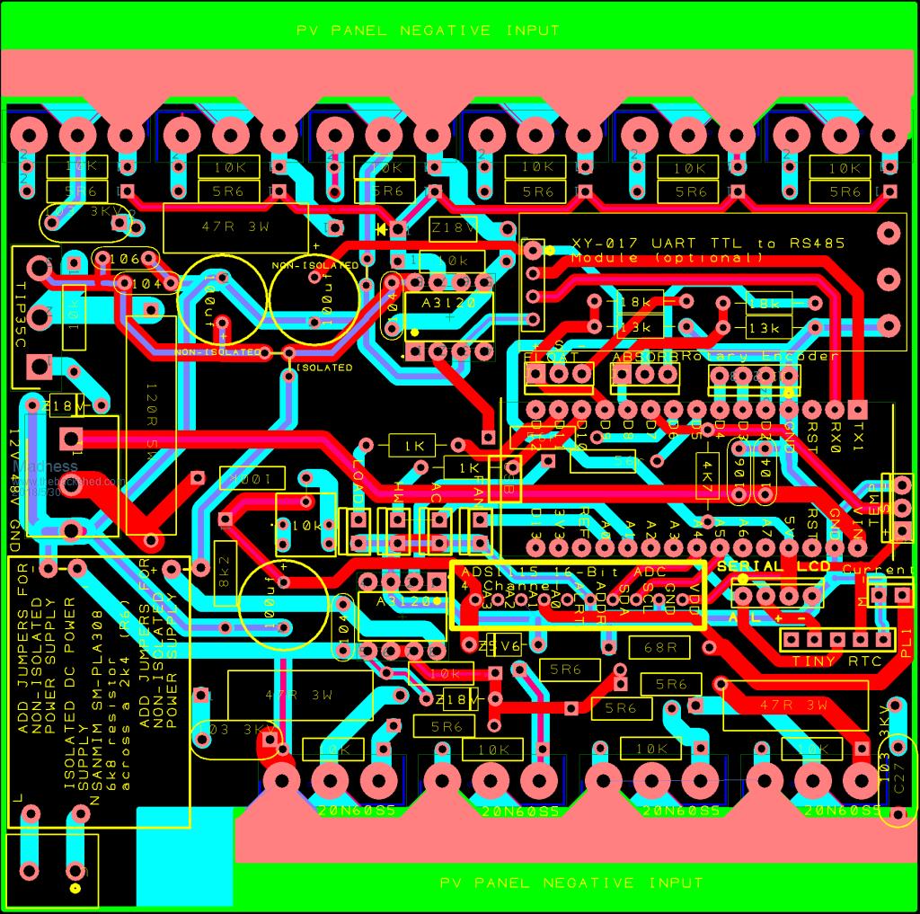

Posted: 09:52pm 29 May 2018
Thanks for your comments Mark, I did try my best to make the board striaght forward and easy to assemble. Keeping all the MOSFET legs straight also means they remain as short as possible. When assembling them screw the MOSFET to the heat sink before soldering, test the board with no big caps then when you go to fit the caps solder the top pads pf the MPSFETs on the PCB prior to installing the caps.
Here is what I hope is the final version of the Regulator PCB, I have just ordered 10 of these to test. It allows you to run it as a DC - DC PV regulator or to regulate a GTI back feeding through the off grid inverter or both DC - DC and a GTI. I have added a lot of optional extras which are not needed if you don't want them.

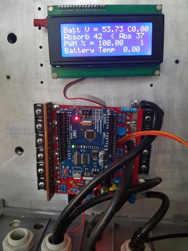

It can be used as a basic regulator as per this version I have been using for quite a few months now.
The new version can be used if you wish to turn on your hot water heater, dump load, vent fan for batteries, air conditioner for equipment room, battery temperature compensation, battery current limit, state of charge monitoring, real time clock and RS 485 communications. The RS485 will also allow you to have other GTI's up to 1200M away regulate their output into your isolated grid. To do this you just use the same PCB but without all the components on it and differenet software to tell it to operate at the output level dictated by the master unit.
But if you just want to add a GTI and or DC to DC panels to your system and regulate the output it will do that also. The basic board would be able to regulate over 10KW of panels via basic PWM directly to your battery bank.Edited by Madness 2018-05-31

Eay madness , can you use a nano or do you need a full sized arduino board??
Can you please let us know when you taking orders?? Will take a couple. ..
I think it works !!
Posted: 07:20am 30 May 2018
The new version has a Nano, the one with the Uno is an old version. Orders will depend on the interest, only a few people are wanting the smaller Inverter PCBs and seems to be a lot less interest in the stuff I am doing now. I have ordered 10 boards now to test, if they are okay there will be some of those available.

Posted: 09:37am 30 May 2018
Put me down for 2 GTI boards Mad, when ready to order, no hurry.
Could you explain the jumper links for isolated/non isolated.
Sorry I'm a tad thick.

Posted: 11:11am 30 May 2018
  renewableMark said   Put me down for 2 GTI boards Mad, when ready to order, no hurry.
When working with most GTI's other than the Aerosharps the DC wiring from the panels must not have any connection to ground. Otherwise the GTI will give an error if there is any less than 1 megaohm resistance to ground. So the MOSFETs regulating the PV must be completely isolated from ground. This is done with the isolated power supply in the bottom right of the pcb and the A3120 isolated driver IC.
But if you wanted to use the PCB with just direct DC to DC then it needs to non-isolated. I have tried to make it as flexible as I can to cover everyones needs. Never thought of using it as a 200 plus amp dc motor controller though. I have been looking at FPV Drones lately and the only DC motors (Actually they are AC) that had been coming to mind run off of an ESC. If this is double Dutch to you just google FPV racing drone and you will understand then.
For those who got 8KW Inverter PCBs I never thought there was any interest in the smaller 4KW inverters. I have one set up as a backup unit but I can see for many people it would be plenty big enough. Especially if used in conjunction with a GTI you have the combined output available when the sun is shining.Edited by Madness 2018-05-31

Posted: 11:28am 30 May 2018
Thanks Mad, hey if those who got 8kw units, you can just leave some bits off the board and just make it capable of 4 kw yeah?

Posted: 11:39am 30 May 2018
Sorry I should have said bottom left for the isolated supply.
Yes Mark you can leave some MOSFETS and associated resistors and Diodes if you wish.
