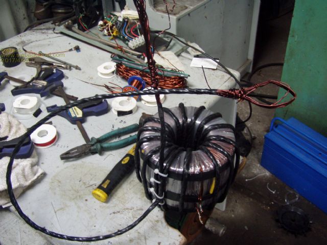

Ok.... done and dusted
And I used tape for the cover up
Your right, easy to do, easy to wind, and looks pretty neat too.
At least with the twin stack I only needed 14-15 turns.
So 15t of 19 in hand works fine... have not tested it yet.
I had to unwind the transformer as it had 2x25mmsq windings already... but I had to try it

Only took an hour from start to finish. The time stamps will show about 2-3 hours, but that includes a 3km walk as well...as procrastination and brekky

Yes not hard at all, how many square mm you got on there? Plenty of room left and a big slice off the build cost.

Yes, that transformer has dropped from 50mmsq down to 38mmsq.... but it will be plenty for normal use...
I only try for about 4kw continuous, with easy runs up to 6-7kw for 20 mins or so, and 25kw surges... that will do that just fine.
Next one I will probably make about 46mmsq or 23x1.6mm wires.

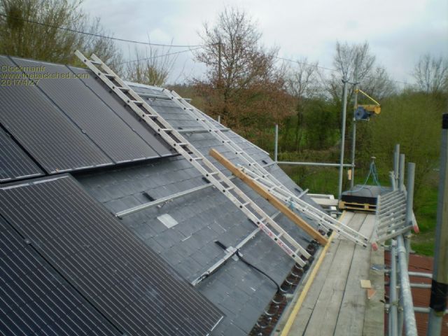

Just adding 4.5kW of the latest PV on my Old Barn roof, 1.7m by 1m by 40mm thick 60 cell Monos, 280w at 40v VOC.
What I find with the Midnite and the Tristar MPPT DC controllers, is that they give way to the AC GTI's that are backfeeding into the battery.
At Full/bulk charge, ie the batts are down, then all controllers are putting in. And the DC MPPT controllers soon back off when they think the battery is pushing back.
The Midnite is a sensitive woossie, and soon goes hides under a bush, while the Tristar MPPT gently trickle charges at float, even when the GTI's have shut down as the battery is full.
