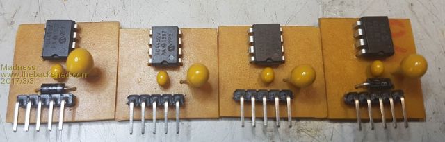

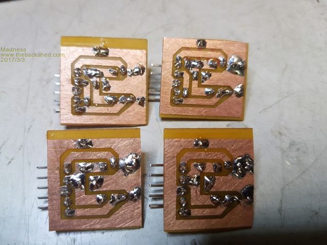

Here is some very useful reading about MOSFETs. Particularly pages 11 & 12 about gate drivers, I have the TC4452's working on test with 4110 FETs, today I will be connecting a transformer and seeing what the result is. So far I am getting very good waveforms on the gates and they are at higher levels than the IR2110s alone. I have added separate power supply with a TIP35 same as the control board just to power the TC4452s and 4.7uf Tantalums across the chips.
PCB's are barely bigger than a stamp.

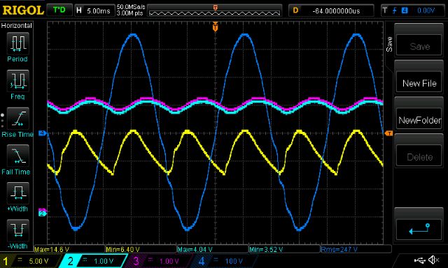

Thanks Madness for the supurb document linked above. That is a keeper.
above shows (Yellow) the "9V" output with huge ripple due to too small 10uF cap
Pink is after the 75K, 33nF LP filter
Light Blue is after the 100R 0.1uF final filter
I use 2 filters for my particular needs in testing EMI noise effects upon the control loop.

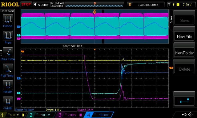

Finally for those interested in dV/dT turn-on I show this:
Yellow is DC bus current
Dark blue is AC output
Pink is low side HF gate drive
Light Blue is high side HF gate drive.
Note how the low side gate easily gets to 4V which is well within the gate threshold voltage of the IRF3808 mosfets I am using.
When this happens there is a small peak in DC bus current.
This is dV/dT turn-on.

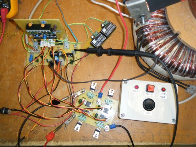

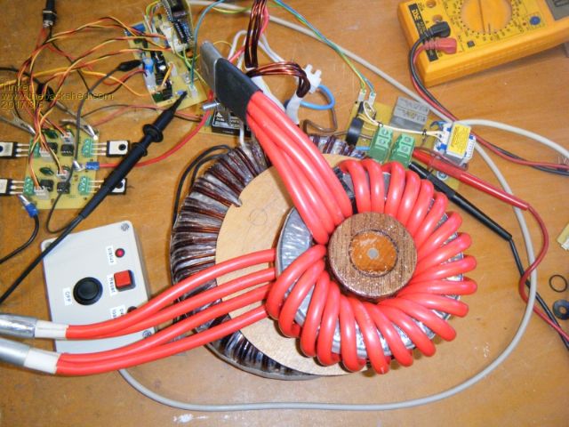

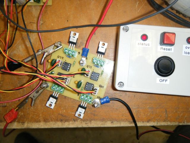

Here is a pic of my new test rig, it works so well I will recommend it for newbi inverter builders:
Notice I made a box that mimics the inverter control switches, very handy.
A close up pic:
It can easily accommodate TO220 Mosfets by splaying the outside legs a little.
Once I have a batch of chips that passed my soak test - I'm using 65V DC which is about 10V higher than my battery bank - Load testing will commence. Very gently this time .
Lastly, my ring ferrite primary choke. Wound 4 in hand of 20mm sq cable. It makes no noise at all while doing my no load experiments.

I tried getting Vfb from a few turns around the main toroid transformer.
The transformer was something like 1.7V/turn so I needed 7 or so turns, then
rectified and divided it down to 3V DC. Beauty, no need for all this extra stuff just to get Vfb I thought.
Voltage feedback control did work fine, but the problem was output voltage of the inverter was porly regulated over varying load conditions. I could set it correct for low loads or set it correct for high loads but not for both.
I think it's a result of poor transformer load regulation.
Once I attached a small power supply transformer (9V AC, etc..) to the 240V AC output of the main toroid things became well regulated under all loads.
It's the best way to do this.

Posted: 01:11pm 06 Mar 2017
Yes, pretty much as expected.
