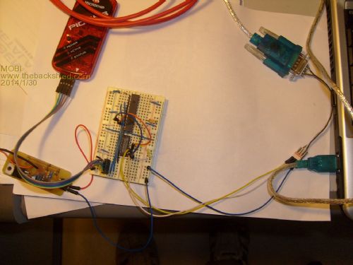

Hi all, now I can get serious.
I tidied the test jig up a bit. Still need to have the 14049 inverter fitted until my proper USB serial kits turn up. Also shortened the leads on the 10uF Cap.
What are others using?
My unit is powered from a LM317 3.3v regulator Downwind made about umpteen years ago.
The USB serial cable is a CH340. It has ttl voltages but RS232 polarity hence the inverters. The 14049's will work ok at 3.3v.

  MOBI said  What are others using?
Do you mean cap wise or serial port wise?
If you mean cap, I am using a 47uF 16v tantalum, and if you mean serial port, I am using a native serial port(not a USB adaptor) on a Gigabyte E350N WIN8 motherboard.

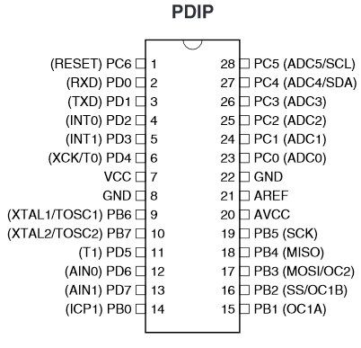

Actually, atmega8 may qualify as a bug (caterpillar) because it have 28 legs
I meant the specific test set up. Photo?

  MOBI said   Hi all, now I can get serious.
that cable looks a lot like it has a db9 connector on the end, which almost certainly guarantees that you're dealing with rs-232 levels at that point - and explains why you need an inverter. please do correct me if i am wrong.
btw, i've always had good success with silicon labs CP2102 usb to serial bridges, which can be had for around us$2.30 on ebay (including delivery) and which haven't been cloned like the prolific chips. the TTL output levels of the CP2102 are 3v3 compliant, and the onboard regulator is good for 74mA (100mA-26mA running current)

  Quote  that cable looks a lot like it has a db9 connector on the end, which almost certainly guarantees that you're dealing with rs-232 levels at that point - and explains why you need an inverter. please do correct me if i am wrong
Yes, it has a 9 pin connector but the signal levels are 5V and the polarity is inverted like RS232. As the inverter runs happily at 3.3v, I don't have to worry about putting limiting resistors in.
