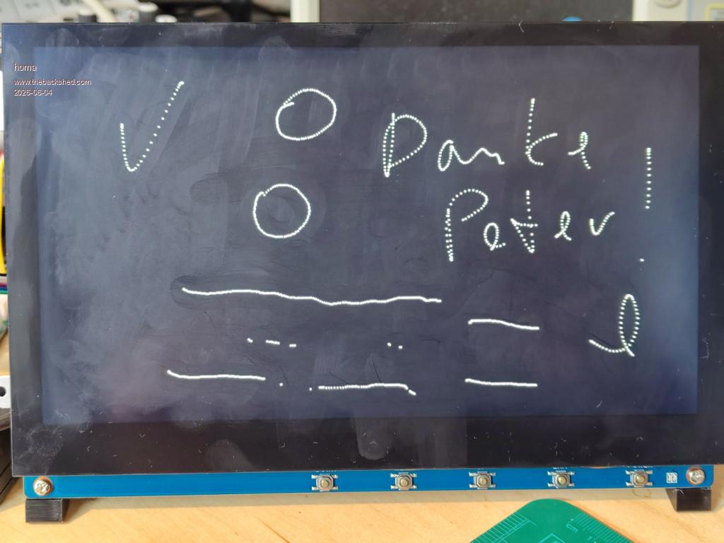

The result
20260604-RC16testDebug.zip

The debug output just won't stop; after two minutes, I stopped stroking my screen ;-)

You can also see the 3- and 5-finger gestures really clearly!

This seems to be the problem:
T+33683ms #458 [62] 04 40 3F 29 9D 28 00 00 00 00 00 00 -> count=1 tip=1 x=824 y=456 active=1
T+33855ms #465 [62] 04 64 00 78 00 04 00 00 00 00 01 01 -> count=0 active=0
and goes well with:

About 10 seconds!
homa
Joined: 05/11/2021
Posts: 755
Posted: 10:13am 04 Jun 2026
And that fits in with what you want – the painting stops right then!
Posts: 12174
Posted: 10:27am 04 Jun 2026
Found a bug. 04 which is the report ID was being found in junk on a report and getting the parser out of sync. Please try again with the attached.
PicoMite.zip
WW: test with this version
Edited 2026-06-04 20:36 by matherp
homa
Joined: 05/11/2021
Posts: 755
Posted: 10:43am 04 Jun 2026
Peter,
a picture is worth a thousand words.
Here's the log – the touchscreen recognises three or more fingers perfectly!
And it's running smoothly now!
RC16_klappt.zip
Thank you very much.
Matthias
PS Did the link above provide any new insights?
