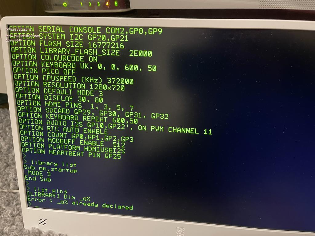

RC8 on one of your  latest ‘reference design’ PCBs (I2S HDMI USB) and am seeing an error (screenshot below) with ‘LIST PINS’.
Note I seem to remember this being reported already so maybe you’ve fixed it but not for RC8?
Edited 2025-04-01 05:52 by WhiteWizzard

Posts: 12176
Posted: 10:03am 01 Apr 2025
Harm: thanks for the report - good news. I just need to post the LIST PINS fix and we should be good to go for 6.00.02

Posted: 07:01am 02 Apr 2025
  Quote  The Bit command / function are not listed, however FLAG() is listed but have been unable to test any further.
Forgot to mention. I've got rid of the bit command and replaced it with the FLAG command and function
FLAG(n)=0/1 'n=0 to 63
? FLAG(n)
This gives you 64 flag bits without having to allocate a variable

V6.00.02RC9 is available on
Fixes bug in LIST PINS
