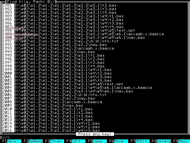

  javavi said  ... a procedure for searching for a file by template starting from the current folder including all nested ones?
Hi Vadim,
nice to hear from you again. I'm glad you're keeping up!
Do you mean something like this:
findfile.zip
The disadvantage is the large memory requirement if you don't limit the maximum number of finds. Perhaps you could also output the data page by page, then the screen would be the memory, so to speak.

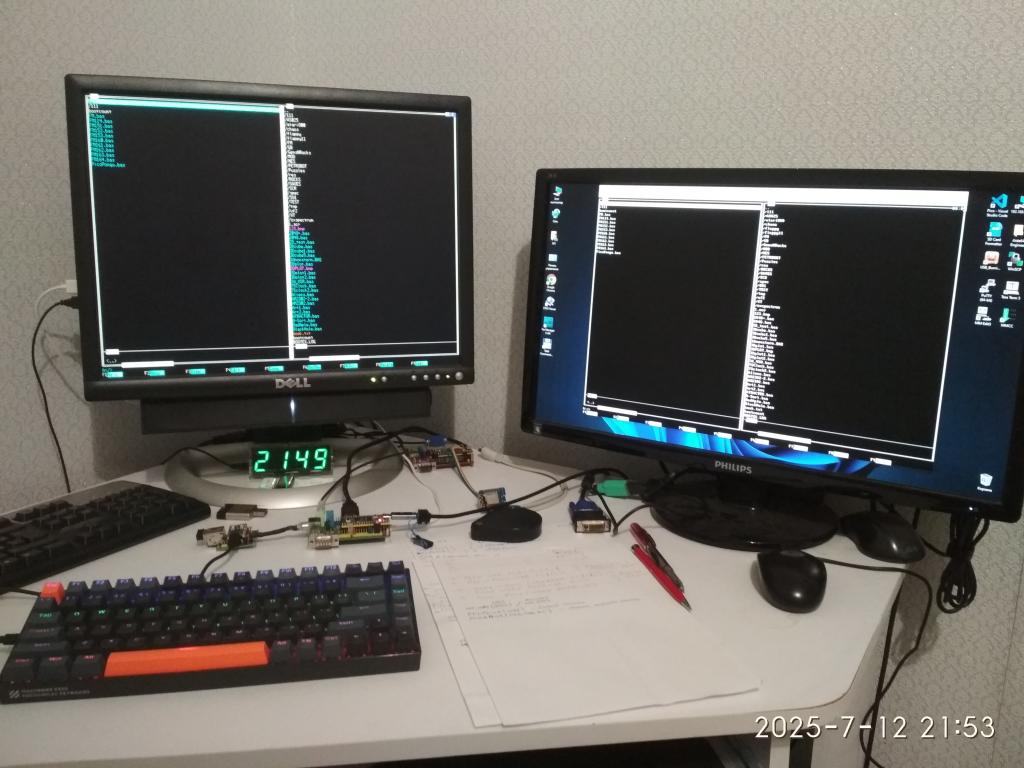

  javavi said  File Manager v1.6 VGA/HDMI
Screen resolution adaptive interface FM
(Works on various screen resolutions MODE 1)
640x480  720x400  800x600  848x480
I tested it on a 2350B with and without PSRAM and it works good for me in these resolutions!
I tested 1280 and 1024 as well and I don't understand, why the colours are not  correctly displayed. If I edit a file with your FM, it will be displayed in coloured code and font 1. But when it returns it will fall back to font 3. I wonder, if the default font could be set other than font 3?
The serial console is enabled and I guess it's with intend. For me, it is good usable
and maybe you still want to improve it. Anyway, if I use the serial console keyboard and navigate with the cursor it comes to hangs. It happens with the "down" cursor key.
Then in the command line it looks like "B:/>B" and the FM hangs until I press ESC.
I think some character is interpreted as a control code. After pressing ESC the screen gets refreshed and it's fine again..
The picture viewer function is nicely useful, as well mp3. When opening a .bmp/.jpg it would be much nicer if the cursor position would be the same as it was in the filelist when the picture is closed. Now it is positioned at the top and I have to find the place again.
All the best!

Hi dddns,
  dddns said  I tested it on a 2350B with and without PSRAM and it works good for me in these resolutions!
I don’t understand this myself, I need to ask @matherp about this!
  dddns said  The serial console is enabled and I guess it's with intend. For me, it is good usable and maybe you still want to improve it. Anyway, if I use the serial console keyboard and navigate with the cursor it comes to hangs. It happens with the "down" cursor key.
It's something with your VT-100 terminal!
It works for me on TeraTerm 5, moreover, I configured it for DOS encoding and it correctly displays graphics just like on the monitor.
  dddns said  The picture viewer function is nicely useful, as well mp3. When opening a .bmp/.jpg it would be much nicer if the cursor position would be the same as it was in the filelist when the picture is closed. Now it is positioned at the top and I have to find the place again.
OK! TO DO :))
All the best!

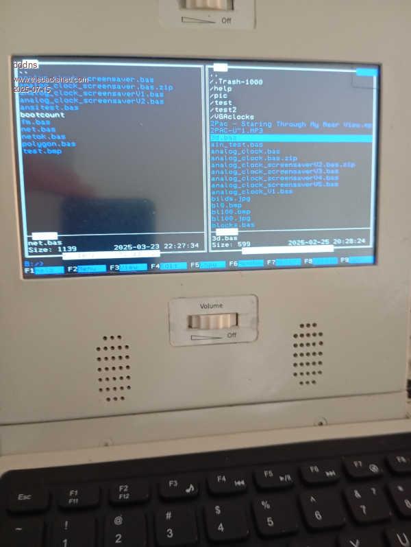

Posted: 02:29pm 14 Jul 2025
quick&dirty just commented out and defined colours by hand real quick, it runs on a RP2040 and a 7inch LCD ..very nice!
This is FONT 4 and works well, same with FONT 1
Edited 2025-07-15 00:31 by dddns

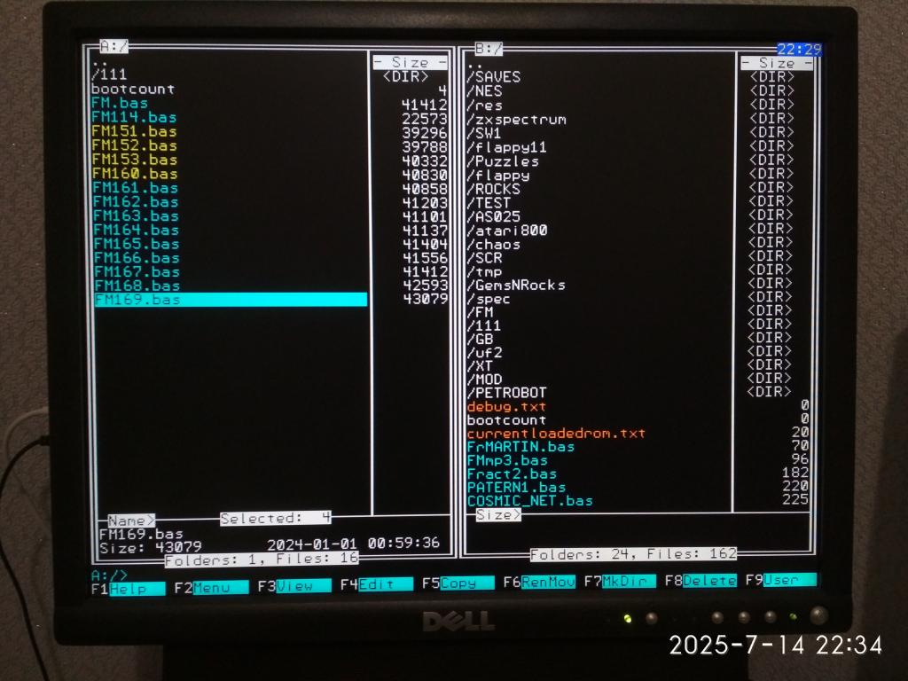

Posted: 07:52pm 14 Jul 2025
FM v.1.69 For testing!
+ A bunch of minor edits
+ Added display of file sizes on panels
Now we need to figure out how to switch the view of panels?
FM169.zip

the "File Find" function has proven to be a useful idea.
As I already wrote, I've dispensed with storing the results in an array and instead just output the results to the screen. This allows me to output a seemingly unlimited number of results. I'm still considering a solution to display or execute results directly in the panel, e.g., by entering the number or by copying a screen page of 36 files into an array and then selecting them with the cursor. In any case, it's progress!
