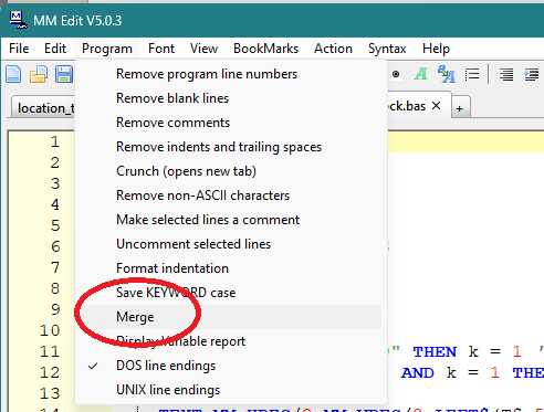

I just forgot to mention it in the help files.
Quick help for merge:
Any line that starts with any of "'$INCLUDE:","'#INCLUDE" or "'#INCLUDE" will be replaced with the file name following the INCLUDE directive. Quote should be used if the filename includes spaces.
The new file will open in a new tab with "_Merged" added to the filename. The original file will not be altered.
Thanks for drawing it to my attention.

  Quote  and Ho Ho or Baa Humbug, depending on your preferences.
That did make me laugh
Should the full pathname be used or must the file be in the same folder? (either/or probably). I did ask about a default folder in preferences for insert file but you suggested pinning it to 'quick access' which I have done.
Merry Christmas
Posted: 09:00pm 23 Dec 2022
I just checked, there is a reference to 'merge' in  the help under 'Program" but it is not very informative and well hidden.
If the include file is in the same folder as the main file, full path should not be needed. Relative paths 'should' work but file systems work in mysterious ways so the full path with quotes is safest. I might make a helper in the right click menu to add the file for you. Saves spelling mistakes.
Some versions of MMBasic have their own INCLUDE so using the one within a comment is safest. I left the reference to INCLUDE without the comment out of the help file for that reason.

Hi Jim, As I said I have not used the INCLUDE function and wrongly (I think now) assumed that it would insert the file at loading time. It seems to be a perhaps more involved method to insert file.
A 'helper' function to browse and select the file would be nice like the insert file. but I will be sticking to the insert file method. Pinning that 'functions' folder makes it an easy option for me to use. Any effort put into gilding the INSERT function would be wasted for me.
