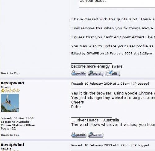

  RevUpWind said   Hello GWatPE, have no edit tab on that incorrect post so cannot remove.
Can you remove it?
I cannot see how this is so. No I cannot edit your posts, but you can. You need to read what follows.
Use the EDIT button at the botttom of the post window, then update post with the changes. You do need to be logged in as well to see the EDIT button.
here are examples. See if you can spot the differences.
The first one is when I was not logged in.
This one is when I was logged in.
It is not really much more difficult than updating your profile, which you have already done.
Gordon.
PS edit: Many readers have edited out posts, so you should be able to as well.Edited by GWatPE 2009-02-12

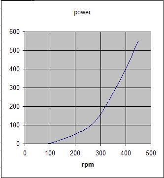

An update on some capacitor sizes for a voltage doubler on a Series80 rewire for 24V system.
I have a series80 7s2p rewire on 24V. I have finally replaced the picaxe programmed variable boost DC-DC converter with a low voltage cutin voltage doubler. The capacitors are NP audio caps, 100V rating, electrolytic type. I have used 2x33uF in parallel in each rectifier input of the voltage doubler. This is 66uF. There are 12 caps in total. Total cost $24 for caps, and $12 for rectifiers. These only have to pass a max of 2-3A. My F&P mill now has full AC coupling to the load, and no electronic switching. The windmill now loads very smoothly and really starts providing current as soon as it starts turning. I have seen 2-5mA AC at 20-30rpm. The mill does not seem to become overloaded and the rpm follows the windspeed much more smoothly than the DC-DC boost converter. Not having a computer try and work out what to do, and having a natural system behaviour do it, seems to result in more time closer to the optimum. The voltage doubler is assisted by the normal rectifiers to the battery when the load current reaches 0.6A. I have to wait for more weather to record some loadings at higher power levels, and check these caps for long term suitability.
Gordon.
oztules
Joined: 26/07/2007
Posts: 1686
Posted: 09:08pm 22 Feb 2009
Gordon,
This is starting to feel like some refinement is happening. It will be interesting to see how the new setup works with higher wind speeds, and what it can deliver ultimately. Does this also have the 48v grid tie running as well, or battery duty only?
I know you were getting some serious output into batteries and inverter, but how does it behave on battery duty only (like I expect most here will be doing).
.........oztules
Posted: 11:34pm 22 Feb 2009
Hi oztules,
I still have the 24V battery loading at low power levels only. As the wind energy levels rise, and the rotor rpm increases, the generated emf may be sufficient to allow power to feed the 48V grid inverter as well.
So far, for low power levels up to 10W, goes via voltage doubler only to battery. At 80W, 1ADC is via the doubler, and an additional 2ADC is through normal 24V cap coupled rectifiers. At this point the 48V cct just achieves cutin.
This is the measured performance so far.
For each doubling of the generated AC output voltage, there is an 8fold increase in the power to the load. This is sort of what is required from the windmill.
Without the 48V loading, the windmill speeds up more, and the tsr increases. The caps on the 24V system do more work for similar output power levels. I have not fully tested this, as the windmill braking becomes enabled as the battery is fully charged, and the capacity of the grid loading at 24V becomes exceeded at these power levels. This is why I opted for 48V direct loading to the grid inverter as well.
As long as the battery diversion loading is working for the max expected power levels, all will be OK.
Gordon.
